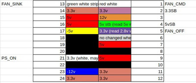

Reply 8 of 21, by nhattu1986
Yes, i have this system still in good operation and yes, the power supply is custom, not follow atx spec AFAIK
this is the picture of the power connector
24 pin
6 pin
molex connector for reference
If you want, i can tried to fired up the computer tomorrow with the voltmeter

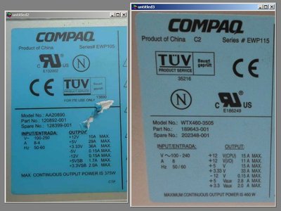

Reply 10 of 21, by PCBONEZ
It's not custom, it's just not ATX.
If I'm not mistaken that PSU and Mobo are to the WTX Standard.
Note that it has both 5v and 3.3v vsb rails.
There are maybe a dozen other non-ATX PSU/Mobo Standards you won't see outside of industrial equipment.
[Withdrawn 460w Suggestion]
I finally found readable labels.
Stay with the 375w. The 460w model only has 15a @5v to the 375w's 29a.
111.02 KiB
1657 views
Reply 11 of 21, by nhattu1986
sorry, English is not my mother language so sometime i'm using some weird term 😁
anyway, this is the result of using the probe.
with the following orientation:
and for 6 pin connector
link to the spreadsheet https://docs.google.com/spreadsheets/d/1AU8e1 … dit?usp=sharing

Reply 13 of 21, by nhattu1986
My machine still in working order, so i simply power it up and measure the voltage directly from the back of connector.
(This PSU should have PS_ON, i suspect that the mainboard must pull that pin to HIGH to power on, maybe pin 13)
Reply 14 of 21, by nhattu1986
Today i got another compaq ap550 and while cleaning the PSU, i also take note of the wire,
so the PS_ON signal is the white one, and it need to trigger high to power on, to power up the PSU, connect it to the 3.3vsb (purple color) .

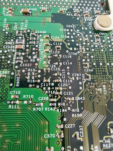

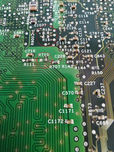

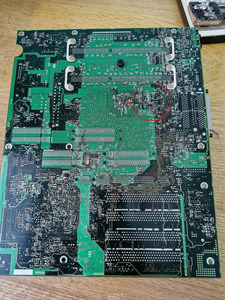

Reply 16 of 21, by FLiNT1011
Found a possible reason why the motherboard does not start. There are no SMD resistors and capacitors on the back of the motherboard.
I need resistor values: R9, R15, R16, R710.
I would be grateful for your help.
    1.13 MiB
    1240 views
    1018.97 KiB
    1240 views
    1.73 MiB
    1240 views

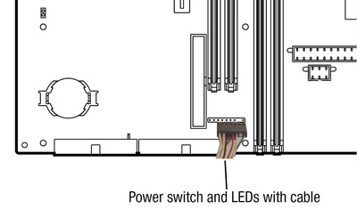

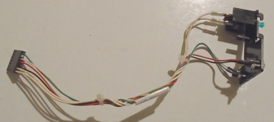

Reply 17 of 21, by StEeLz
Hey Fine People,
I just got that bare board and I have the original PSU, however I do not have the Power button and LED. Anyone would care to send the pinout for the Switches and LEDs? Also the FAN connectors are weird and won't accept a standard 3 or 4pin Fan (seems Ground is missing if using a standard one)
Reply 18 of 21, by PC Hoarder Patrol
StEeLz wrote on 2021-03-23, 23:40:
Hey Fine People,
It's a fairly standard front panel harness for this motherboard (SW400) in my Compaq AP550
337.85 KiB
1048 views
as is the pinout which (from left to right) is -
1 & 2 - Unused (possibly RESET, but the AP550 doesn't have one)
3 & 4 - White / White (Power Switch)
5 & 6 - Black / Red (Power LED)
7 & 9 - White / Green (HDD LED)
8 - KEY (No pin - Unused)
77.13 KiB
1048 views

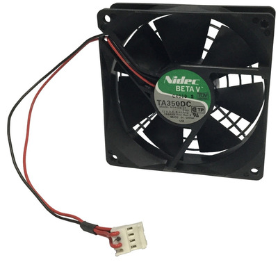

The fan headers (4-position / 3-pin) are non-standard, designed for these fans which are +12VDC on the two outer pins & GND on the centre pin
150.48 KiB
1048 views

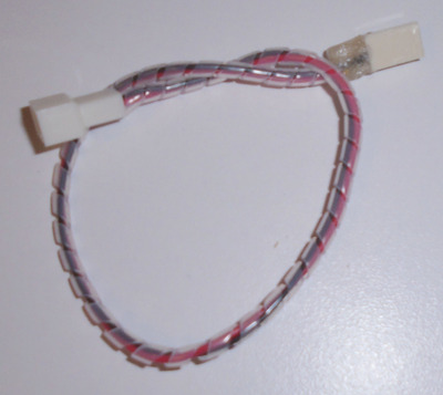

You can also just make your own adapter cable for standard 3 or 4 pin fans which follow their +12VDC / GND / +12VDC pinout (ignoring any other sense / tach or PWM wires), which is what I did for the front fan on my AP550
355.34 KiB
1048 views
