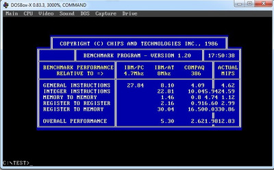

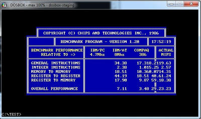

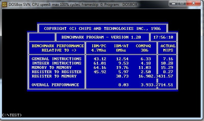

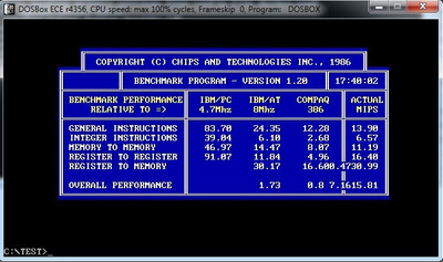

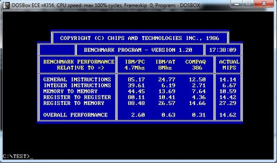

Reply 1113 of 1550, by awgamer
Between ece r4356, svn r4356, staging 0.76.0-alpha-399-g6c010, & x 0.83.3, ece runs mips without corrupted output, but, output will be corrupted after a cls, but, a dir after cls and it will give uncorrupted output again, which should help narrow down the remaining error, diff of what cls is touching vs dir. Next best is svn, it too will run uncorrupted, but, it's hit and miss, one fresh instance runs uncorrupted, run a fresh instance again, corrupted, same steps, different result, and with the uncorrupted run, after a cls corrupts the output, dir doesn't correct it back to clean like ece.
edit: more ece behavior, will start with borked output. dir wont fix, cls then dir does fix.

Reply 1114 of 1550, by ripsaw8080
Rank DOSBox Author
DOSBox Author
Are you sure it's not just a bug in the program? No system was so fast back in 1986 when MIPS was written, so try cycles=2000 or thereabouts for speeds more appropriate for the era than cycles=max.
Reply 1115 of 1550, by awgamer
ece outputs the screen correctly regardless, and corrects a garbled screen by running dir a time or two while the others are stuck at garbled output. Enough to possibly figure out what goes wrong and keep it from doing so. It may be limited to mips, or may crop up elsewhere, and at different speeds, with how ece is behaving that concern is nearly moot.
Reply 1116 of 1550, by ripsaw8080
Rank DOSBox Author
DOSBox Author
It appears that it messes up when the IBM/PC multiple exceeds 99.99, as you will notice the lines that mess up have a blank there. Please keep in mind that cycles=max is not a constant speed; DOSBox is trying to calculate the needed cycles over time, so it will give varying results.
