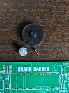

I ordered (and received) a tiny little screw to attach the volume wheel to the potentiometer for my upcoming Snark Barker build.
I think I have everything in place now, just need to figure out how I'm going to create the required openings in the mount bracket... 🤔
The attachment IMG_20201027_160351.jpg is no longer available
Reply 17004 of 31488, by appiah4
pan069 wrote on 2020-10-27, 05:19:
Use a dremel or other such rotary tools for the job would be my advice. Worked great for me.

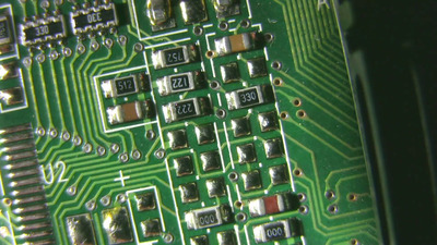

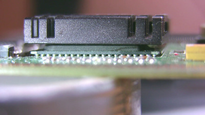

I just found out that my old, 2008 HDV camcorder - Canon HV30 is perfectly suitable to be used as a soldering microscope 😀 its macro possibilities are absolutely amazing, you can focus at 0mm distance (literally touching the glass), you can mount it more than 10cm above the board leaving enough space to work, zoom in and have the components in focus. No noticeable latency when used with HDMI cable. Looks like it outputs 1080p50, even though it records 1080i50.

Looking around my area if I can find a place that has a drill press (e.g. small(er) car repair workshops etc). I figured, if I can print the layout of the openings on sticky paper then use a drill press for the round holes (obviously) but it also would allow to do the corners of the DB15 connector (and large parts of the interior). I would then use a hand file to finish the job.

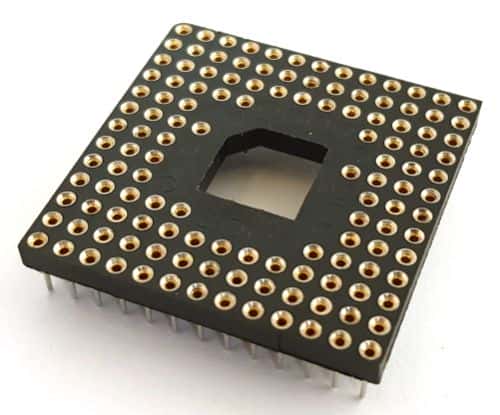

You can see some of the preferred tools in the background- a flat edged butter knife to get the rows aligned after I pick through them with a dentist's pick (I always ask my dentist for old ones, pre COVID anyways - useful for carburettors and getting small jumpers too!) and needle nose pliers to bend out crush curves. The DX2/66 in the background is in a PGA socket (something like this except fit for a 486 - it came off some Kingston riser or voltage regulator I think 510-93-128-13-041001-a_500x415.jpg ) as I needed that to get some of the pins inserted - they needed force, I'd rather not exert that on a motherboard.
It'll probably stay in there for the duration of the tests, then I will lift it out and apply it one last time to a 486 motherboard that I will build a computer around.

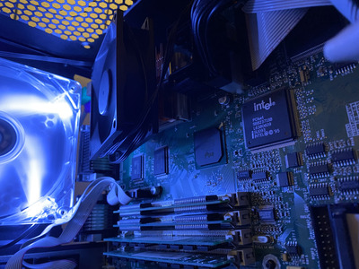

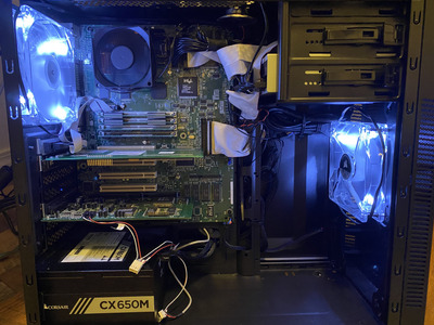

Since I got my System 7 Mobo in yesterday, and got my Startech Copper heatsink, I decided to put it all together and start customizing stuff.
The attachment image1.jpg is no longer available
I managed to keep everything clean inside there, to my own surprise. The only sketchiness is the fan I am using, which was a necessity because the one that came with the heat-sink was louder than the case fans going full blast.
The attachment image2.jpg is no longer available
Plus, with it in this precarious position, the VRM heat-sink also gets air going across it.
Reply 17019 of 31488, by chrismeyer6
That system looks fantastic excellent work my friend!
