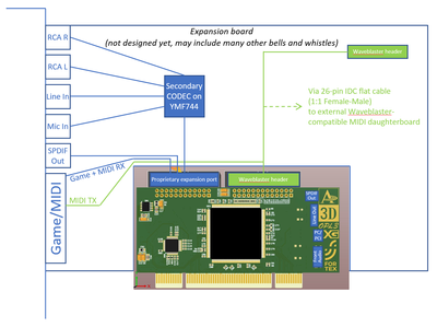

As we're approaching the release of our AWE64 Legacy project, I've decided to start some arrangements for the next one.
This time it will be my all-time favorite brand and product, the almighty Aureal Vortex2 (AU8830), the last game changer in the computer audio industry.
The first idea is to make an "A3D-accelerator", a very small PCB with no bracket, and just two MPC connectors (Line-In and Line-Out) so that it could be installed in tiny systems, thin clients or PCI/ISA shared slot along an ISA card occupying the bracket place.
What would you guys suggest? A new soundcard? What should it be? Or a combo with anything else? Do any of you have any hardware-related docs, a detailed datasheet, for example?
So, the general preliminary product concept will be as following:
300.06 KiB

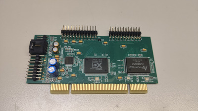

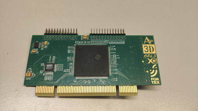

SECOND MAJOR UPDATE: we have already designed the PCB, sourced all the necessary parts, produced the first prototype (albeit a buggy one), fixed the identified bugs and ordered the second prototype!
510.63 KiB
5510 views
497.71 KiB
5510 views

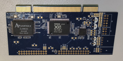

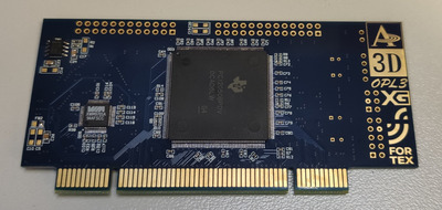

THIRD MAJOR UPDATE: all PCI devices (TI PCI-PCI bridge, AU8830, YMF744) have been detected by the host system, looking forward to testing results by jheronimus!
1002.41 KiB
5277 views
1.03 MiB
5277 views

I don't know, I'm kind of a sucker for high end cards so I'm not very excited about the budget variant. Any Aureal card should have wavetable header for example (my opinion). Now when I'm thinking about it, is it possible for Aureal card to support PC-PCI link? That's the one thing I am missing from most DOS capable PCI cards and I don't recall I have seen it on any official Aureal card.
Reply 2 of 169, by hard1k
In fact, existing cards offer a nice variety of higher end options: SQ2500, SuperQuad, Turtle Beach Montego II Home Studio, etc.
And all of them are available and not so expensive, so I don't see a reason for a new card replicating the existing set of features.
That's why I'm thinking about niche use cases, or some combo cards.
No, unfortunately Aureal chips don't provide for PC-PCI (or I am unaware of this, as it hasn't been mentioned anywhere), nor is there any comprehensive reading about their hardware side of things.
