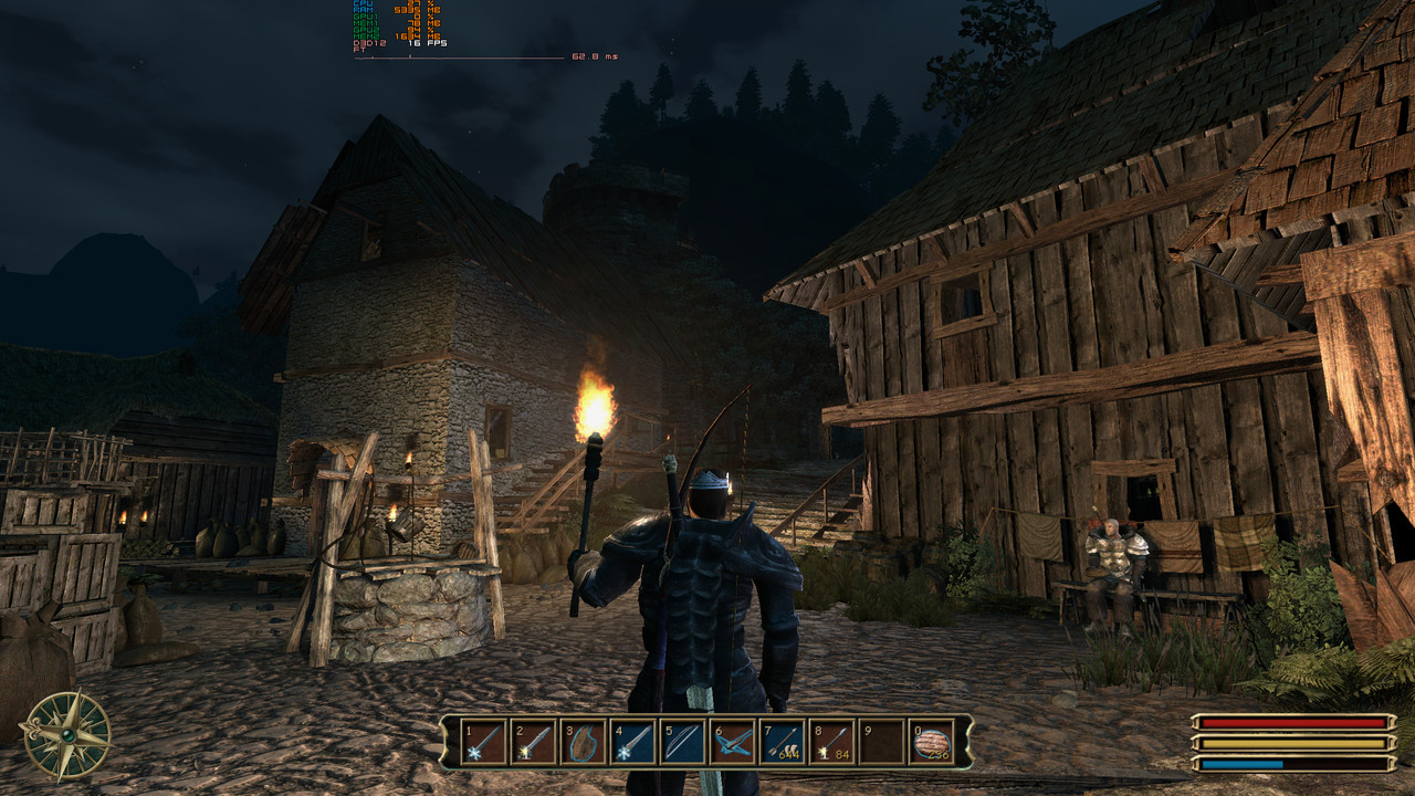

First post, by lowenz
Gothic 3 1.75+Update 1.04
Maxed out but NO new effects (Lens Flare, Noise, etc.) - NO FXAA - NO HDR (only Bloom to keep the original look&feel)
D3D12+Fast Video Memory Access (but the problem seems not related to FVMA)
Intel HD 630, lastest drivers (dgVoodoo2 is the ONLY way to play this game on Intel GPUs without the infamous tree-everywhere bug):
AMD Radeon:
And in the same zone, camera angle dependent)
(City of Montera, Slaves Quartiers)

Reply 2 of 19, by Dege
@Lowenz: could you attach a savegame for that location plz? I gave the game a quick go but couldn't yet reproduce those problems.
@Daniel: Is resolution forced through dgVoodoo?
Btw, refresh rate at 4k isn't 59.9 Hz or sg like that and that's why dgVoodoo displays it as 59Hz?

lowenz wrote on 2020-12-07, 21:19:
You can teleport (marvin mode + goto Montera). It's the zone between the tavern and the slave camp. If you move around you can see the flashing and the texture misplacements (UV mapping error?)
Gothic 3 + Patch 1.75 + Update Pack ( http://fgex.ru/files/Gothic_3_EE_v1.75_Int_Up … ck_v1.04.11.exe )
Ok, I teleported myself to Montera in dev mode, but... the slave camp is just not there. 😁
Just an empty square, the camp is not built yet. I guess I should play some missions before I could go there in game life.
EDIT: ok, never mind, meanwhile I found another location with the same problem. The point is, the issue only seems to come at night.

I fixed it. I went back to Montera at night but the camp still wasn't there, so I couldn't check out your location but I think the issue had the common root I fixed.
(no, it wasn't UV mapping but distorted polygons from badly bound parameters of instanced drawing)

Torch lighting still doesn't work however... I couldn't yet figure out the reason but it seems that shadow renderpass is simply skipped by the game when rendered through dgvoodoo so everything remains dark in the environment.
But why. It's to be solved (later).
Update: I managed to fix it after all. 😀

Reply 11 of 19, by Dege
That's what I get if I start the game on the dGPU at high res and then on the iGPU. The game doesn't find the high res amongst the enumerated ones and quits. But, simply starting the game again it launches at a lower resolution because it deletes UserOptions.ini (previously, when fails) in the Users\xxx\Documents\Gothic3ForsakenGods\ folder.
There is no difference in this regard between 2.71.3 and 2.72.
What if you edit UserOptions.ini manually and set an available resolution?
Reply 12 of 19, by lowenz
It doesn't even complete the ini creation if I start the game the first time (no ini) with dgVoodoo2!
Reply 13 of 19, by lowenz
And if I start the game after a non-dgVoodoo2 session (ini created, game running) the game destroys the working ini and the problem repeat itself.
(I'm not using Forseken Gods but Gothic 3 + 1.75 Edition + 1.04 Update)
Reply 14 of 19, by lowenz
Damn, it's again the refresh rate! With 74 is working!
Reply 15 of 19, by lowenz
OK, now it's working (dgVoodoo2 want s"74" Hz in the ini, 75=crash 🤣) .
But I'm experimenting another quirk: why to use ONLY the iGPU I must force it in Windows Graphics Settings and not only in dgv Control Panel? If not dgVoodoo2 uses all the GPUs!
Reply 16 of 19, by lowenz
Here's the situation (iGPU output):
1) forcing the iGPU (GPU2 in the RTSS overlay) in dgv control panel AND Windows Graphics Settings:
2) forcing the iGPU (GPU2 in the RTSS overlay) only in dgv control panel :
Any idea about this?
D3D Windows "internal" management?
Reply 17 of 19, by Dege
(I'm moving the posts related to the game into this topic)
Reply 18 of 19, by Dege
If you change the order of displays in windows settings then you should restart the CPL to detect the changes.
Anyway, other applications can use the other GPU (like playing a movie in a browser on the other display) while playing the game. Check out the task manager to see per-process gpu usage.
Reply 19 of 19, by lowenz
No changes and no other applications there! (when I set the iGPU-controlled display as the only display dgVoodoo2 correctly shows the iGPU as the first GPU in the list)
It seems - when not forcing the execution on the iGPU - Windows uses all the GPUs when the application is launched on the iGPU-controlled display ("Show only etc. etc. etc."), with dgVoodoo2 too.
Is this possible?
That behaviour happens only with the iGPU, with the main GPU the iGPU usage is @0%
