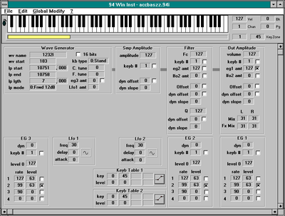

bnz99 wrote on 2020-12-21, 12:34:
, but, for what it may or may not be worth, isn't that (from the screenshot) the instrument file format of the old Dream SAM9407 chip used in the Terratec EWS64 or the Hoontech Soundtrack soundcards?
94B (or 94I for a single instrument) is Sound Bank format for that SAM94-and-compatible generation of synth chips (EDIT: my understanding is SAM9503 is compatible even it has no "4" in the model number). there is 98I as well for the next generation SAM9708. probably, even more, I am not familiar with how many different generations there were of such synth chips. in any way, there are 94I/B and 98I/B formats for sure, i guess SAM9708 has new features that old 94-format can not accommodate and that's why 98-format was introduced.
The screenshot kind of looks like the default Dream developer board software that Hoontech bundled and that I tried to make run on the EWS64 (as they didn't deliver an instrument editor for a really long time) back in the days.
most likely - yes. any related information is appreciated, especially if there are tools/apps that can handle 94-formats.

mattw wrote on 2020-12-21, 09:36:
Lord Nightmare wrote on 2020-12-21, 08:25:
Flip i assume is flip-flop/ping-pong loop. forward-clip I guess starts playing(?) from the loop start point forward and doesn't play any of the wave before that even if it exists? (i.e. so a different patch can use a different section of the same wave, overlapping?)
it's something like that and i kind of demystified "fmAyA" - it's actually "fm4y4". so, 94B instrument definition could be either PCM(Wavetable) or FM. that means "fm4y4" whatever it exactly means, is the only "loop mode" available with FM instrument. maybe, someone familiar with FM synthesis can make a guess in deeper technical details. So, most interesting new information (at least to me) is that synth chip, which understand 94B format, are like Yamaha YMF278B (aka OPL4, even technically it's OPL3+Wavetable) and provide both FM and Wavetable synthesis at the same time.
Google "Roland FxM". Some Roland synths (JV-80 and descendants) have a limited FM modulation option. As an aside, JV-80 uses the same GP4 chip as the SC55, so FxM might be part of the GP4 chip's abilities and just inaccessible in SC55...
Besides that, a Roland envelope terminology note. The terms you tends to encounter in their manuals are "level" (obvious), "time" or "duration" (also obvious), and "rate". With regards to an envelope, "rate" actually refers to the angle of the line in a particular envelope stage (it's not obvious if you don't pay attention to the diagrams in their manuals). Also, if rate is used for decay and release, sometimes the value for the parameter is the inverse of what you would logically expect.

yawetaG wrote on 2020-12-26, 18:33:
...i kind of demystified "fmAyA" - it's actually "fm4y4". so, 94B instrument definition could be either PCM(Wavetable) or FM. that means "fm4y4" whatever it exactly means, is the only "loop mode" available with FM instrument.
I believe you're right, in 94B that "fm4y4" thing is dual 2-operators FM (that's why it's designated as "4", i.e. "2x2") and that Roland FxM is also 2 operators FM (1 carrier and 1 modulator). I think 94B has Dual such FM synth, because 94B can do 2 samples defined for one instrument, i.e. I guess it is connected to what you outlined here:
yawetaG wrote on 2020-12-26, 17:59:
The usual way Roland implements detuned patches on their other TVA/TVF synths is having two samples played at once, one of which is detuned.
So, once again, I am not expert on those topics, but similarities between 94B and Roland are staggering in my opinion.
[EDIT] correct me, if I am wrong, but:
TVF is essentially the same as what 94B has: VCF, which is Voltage Controlled Filter
and I presume Roland TVA is essentially the same as what 94B calls VCA (Voltage Controlled Amplifier). I am very close to think direct conversion between SC and 94B is possible. There are too many identical structures/parameters, at least from my point of view.
