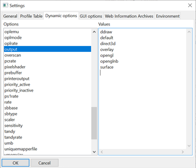

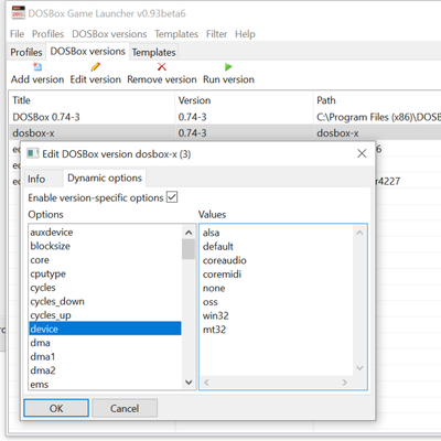

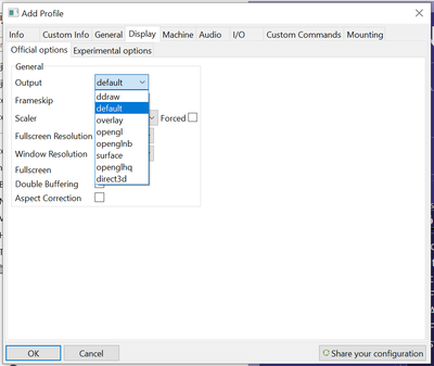

psoma wrote on 2020-11-12, 21:02:Using the latest beta, I'm unable to select "direct3d" as the output type for Dosbox-X. I've added direct3d to the dynamic options list and the settings.conf file, but it won't come up as a menu option of the GUI (as it does for DosBox DAUM). Is there something I'm still not doing or doing wrong? I must admit, I don't quite understand where it gets these values from and how it knows what the DosBox versions support (because DosBox-X definitely supports Direct3D).
Strange, this should work. Make sure you have the following configured:
And make sure you associate your DBGL profile to DOSBox-X. Then you should have the required output options like so:
