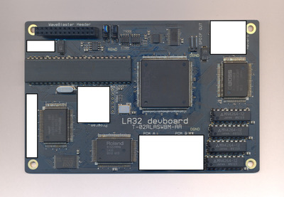

It might be. I have two of these boards, which are slightly different from one another. Here are two (partially obscured) photos for you. These boards were created by a fellow VOGONS member.

Those boards look awesome. Nice to see the real thing. Too bad it's partially obscured but I guess it's either to protect the design or to avoid possible legal issues. Thanks for the photos! I hope more of these beauties will get publicly available someday.
Could you be more specific how those boards work and how is the compatibility?

What sorcery is this? Has someone been digging around the Roland graveyard in the dark of night to unleash this creature on us?

I guess it's something similar to McCake but with FPGA and real chips. I have no idea how hard is to source those parts and hope no functional MT-32 has been hurt in the process! 😁

Reply 15 of 31, by root42
Howly cow. Thos LA32 Devboards look lovely! Amazing stuff! And yeah, I hope no MT32 had to be gutted for that! No functioning at least... I guess in the end an FPGA solution which doesn't need the LA32 IC would be best and give very good compatibility.

Reply 16 of 31, by keropi
noone in their right mind woult gut a mt-32 to make it a daughterboard, rest assured
the roland chips used in computer modules we love are not unique to them so chance are something "junk" and "unusable" was the donor. 😉

Yeah, they were used in keyboards as well I guess. However I also think it's not viable to build many of these, as donors are probably quite rare still.

I guess the DB can be only compatible with one of the devices, probably the CM-32L.
But probably with the MT-32 roms can be programmed instead.

its funny to see those old intel embedded mcs-96 / 8095 cpus.
