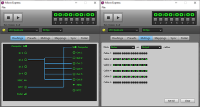

I purchased the current model of the MOTU micro express (https://motu.com/products/midi/micro_usb). It is a 4-in/6-out MIDI router, and can hold eight user-programmable presets. Using their ClockWorks software, the device can be configured as needed, and then can be used as a stand-alone device, with no further need for a USB connection (except for power). I created three presets, one per PC. In each preset, one specific MIDI-in port is routed to the five MIDI-out ports on the back. On the output side*, I have set a filter to mute the even or odd channels, respectively, for each pair of modules. As a result, CM-32L #1 only gets to play the odd channels, CM-32L #2 the even channels of the complete MIDI signal. Same for the SC-55's. The X3MB receives the unmodified MIDI signal. As all outputs receive the MIDI signal all the time, it is also great for testing different MIDI modules in games. I just power on all devices and then switch the desired audio output to the sound card.
(* It is important to do that on the output side, as otherwise the respective filter would change the MIDI signal entering the micro express, with no connected device having access to the full signal.)
45.22 KiB

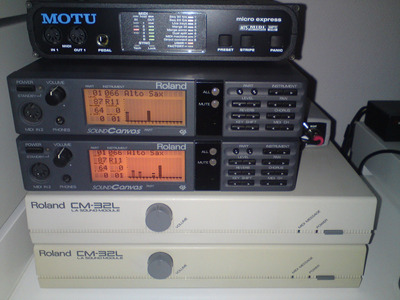

Here you see the SC-55 pair playing the Sam & Max - Hit the Road intro. SC-55 #1 plays on the odd channels, SC-55 #2 on the even channels. Success!

does it actually renumber the channels on split, so you said odds, evens so like 1,3,5,7,9 becomes 1,2,3,4,5 on device 1? the screenshot of the sc55 displays seems like this is not the case, so your not actually doubling the channel count, so seems kind of pointless. you could just run a midi through box and get the same result without all the messing around and get all the voices from both boxes instead of half the voices from each box... (and I could be totally misinterpreting yours setup making this reply pointless 🤣!)

Well, one MIDI channel can be assigned more than one track. Consequently, more than one "voice" can result from a single channel. 16 channels are the limit for one MIDI hardware link. So, as a composer, you'd assign all your tracks to the 16 channels. But if the resulting output exhausts the MIDI device's polyphony, another hypothetical 16 channels won't change that (again, the MIDI hardware link is limited to 16). So, by splitting the channels (odd/even), two MIDI devices with a given polyphony have less voices to generate (individually), and therefore, their individual polyphony limit has been effectively circumvented (as now two MIDI devices share the work intended for one). The line outs of both MIDI devices are then combined in my audio chain (with a 3u rack mixer).
