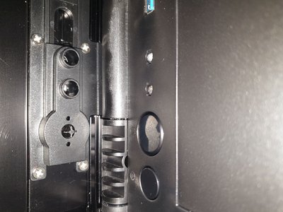

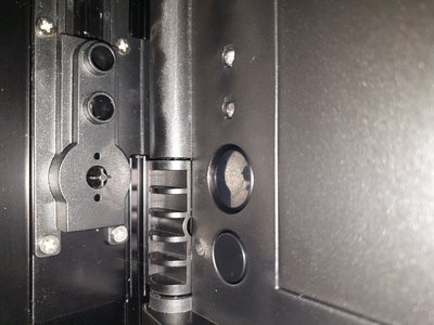

Small update: Phase 1 to convert ATX momentary switch to an AT toggle switch is a go:

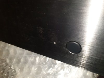

Outside door facia power pushbutton is spring loaded, so always returns back and will work for both AT and ATX.

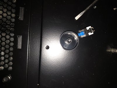

Inside power pushbutton is different as it will be directly connected to the switch, and you can see its centre is shaped to fit around the rectangular actuator tip of the switch.
When installed, this pushbutton is flush with the surrounding in its off state.
When depressed, you can see this pushbutton remains pushed into the case in its on state, similar to old AT cases power buttons.

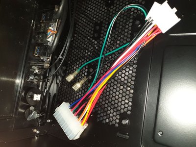

The switch installed and just needs to be wired up - might solder it or find smaller quick disconnects.
Got these switches from eBay. They were tricky to search for. I initially looked for toggle switches, but I found too many of the flip type. These push on/ off type were found by searching 'latching switch 8mm'.
8mm is a slightly loose fit, but once I wrapped one layer of electrical tape around it, the increased thickness was a snug fit. Besides, 8.5mm sized switches are also available.

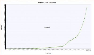

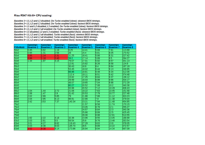

Then I tweaked the above to get the fastest and slowest possible CPU speeds possible, and a few in-between. Because there are so many parameters, I grouped these parameters into 8 different configurations, from the slowest to the fastest, and evenly spread. I called them Baseline 1-8, and I excluded FSB and CPU multipliers in these baselines.
Each of these baselines consisted of a particular configuration, labelled below, and are 8 quick settings for 8 different CPU speeds. I measured different Speedsys scores for different FSB/ Multiplier configurations against each of the 8 baselines and tabulated the results:
There was no need to fill the entire table, as you can see plenty of blanks. I just picked Speedsys gaps to fill a smooth CPU speed range from the slowest to the fastest. Once I had enough speeds for a smooth range, I just used a spreadsheet to list them in ascending order, from the slowest to the fastest, and aligned a running counter ranking each Speedsys score from 1 to 100 or whatever. I called each counter a Datapoint and plotted each against their corresponding Speedsys scores. The table was setup as below:
I plotted Datapoint vs Speedsys from the above table to get the below graph:

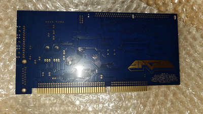

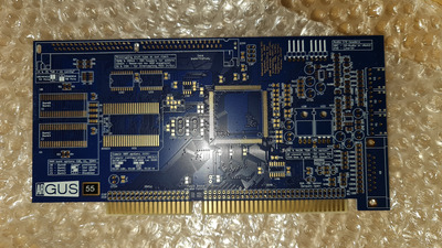

On a sidenote, this beautiful blue ARGUS PCB arrived, and this GUS soundcard might just be the motivation I need to kickstart this project again!
