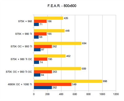

F.E.A.R. - 800x600
Game Version = v1.0 - Retail
In-game / Benchmark = Max details
Benchmark Scene = Default
NVPI = Defaults

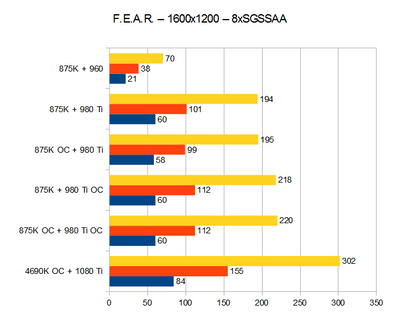

F.E.A.R. – 1600x1200 – 8xSGSSAA
NVPI = Defaults
NVPI, Antialiasing compatibility = 0x004010C1
NVPI, Antialiasing - Behavior Flags = None
NVPI, Antialiasing - Mode = Override any application setting
NVPI, Antialiasing - Setting = 8xQ [8x Multisampling]
NVPI, Antialiasing - Transparency Supersampling = 8x Sparse Grid Supersampling
NVPI, Anisotropic filtering mode = User-defined / Off
NVPI, Anisotropic filtering setting = 16x

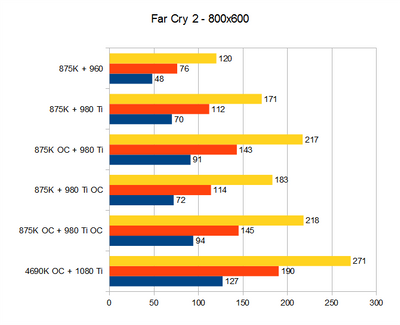

Far Cry 2 - 800x600
Game Version = V 1.00
Benchmark Scene = Ranch Small
NVPI = Defaults

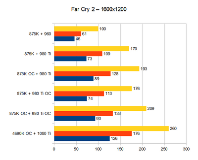

Far Cry 2 – 1600x1200
NVPI = Defaults

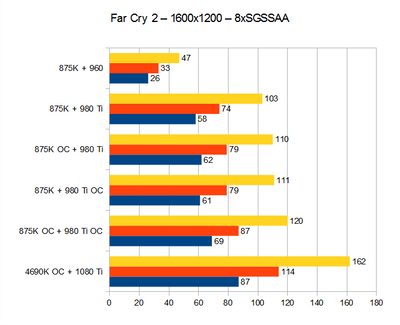

Far Cry 2 – 1600x1200 – 8xSGSSAA

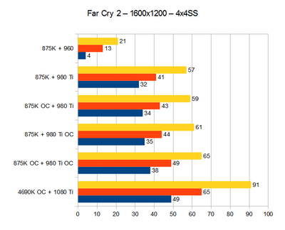

Far Cry 2 – 1600x1200 – 4x4SS
NVPI, Antialiasing - Setting = 4x4 [4x4 Supersampling (D3D only)]
Configurations
875K + 960           = CPU @ 2930 MHz. RAM @ 1333MHz. GPU @ 1304 MHz core, 3505 MHz memory. Windows XP 32-bit.
875K + 980 Ti = CPU @ 2930 MHz. RAM @ 1333MHz. GPU @ 1430 MHz core, 3548 MHz memory. Windows XP 32-bit.
875K OC + 980 Ti = CPU @ 4135 MHz. RAM @ 1600MHz. GPU @ 1430 MHz core, 3548 MHz memory. Windows XP 32-bit.
875K + 980 Ti OC = CPU @ 2930 MHz. RAM @ 1333MHz. GPU @ 1610 MHz core, 4104 MHz memory. Windows XP 32-bit.
875K OC + 980 Ti OC = CPU @ 4135 MHz. RAM @ 1600MHz. GPU @ 1610 MHz core, 4104 MHz memory. Windows XP 32-bit.
4690K OC + 1080 Ti = CPU @ 4698 MHz. RAM @ 2133MHz. GPU @ 1860 MHz core, 5508 MHz memory. Windows 7 64-bit.

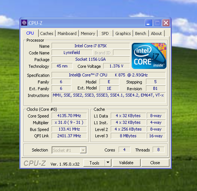

875K Overclock - BIOS Settings
Frequency/Voltage Control
Memory Configure
DRAM SPD = XMP Profile 1
DRAM Frequency = 1600 MHz (2:12)
DRAM tCL = 7
DRAM tRCD = 8
DRAM tRP = 7
DRAM tRAS = 20
CPU Configuration
MPS and ACPI MADT ordering = Modern ordering
Intel(R) HT Technology = Enabled
Active Processor Cores = All
C1E Support = Disabled
Intel(R) SpeedStep(tm) tech = Enabled
Intel(R) TurboMode tech = Enabled
Turbo Ratio Limit Program = Enabled
1-Core Ratio Limit offset = 0
2-Core Ratio Limit offset = 0
3-Core Ratio Limit offset = 0
4-Core Ratio Limit offset = 0
Turbo Limit current Override = Disabled
Turbo Limit power Override = Disabled
Intel(R) C-STATE tech = Disabled
K Boost = Enabled
CPU Multiplier Setting = 31
CPU Frequency Setting = Auto
PCIE Frequency Setting = 100
QPI Frequency Seletion = Auto
MCH Strap = Auto
EVGA VDroop Control = With VDroop
Bootup CPU VCore = 1.40000V
Eventual CPU VCore = 1.40000V
DIMM Voltage = 1.65V
Bootup CPU VTT = 1.400V
Eventual CPU VTT = 1.400V
PCH = 1.400V
CPU PLL = 1.900V
875K Overclock - CPU-Z
115.85 KiB
1745 views

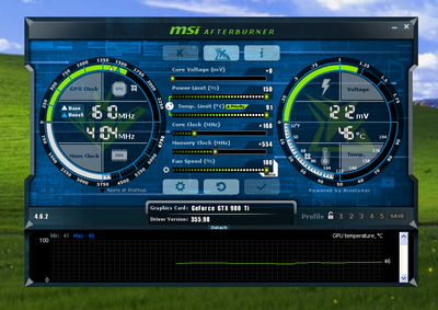

980 Ti Overclock - MSI Afterburner
448.63 KiB
1745 views

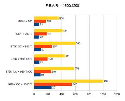

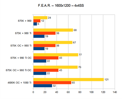

Reply 21 of 28, by duga3
Results - F.E.A.R.
(Min - Avg - Max FPS)
F.E.A.R. - 800x600
15.46 KiB
1733 views
15.04 KiB
1733 views
15.75 KiB
1733 views
F.E.A.R. – 1600x1200 – 4x4SS
15.01 KiB
1733 views

Reply 22 of 28, by duga3
Results - Far Cry 2
Far Cry 2 - 800x600
15.21 KiB
1733 views
15.5 KiB
1733 views
15.64 KiB
1733 views
15.64 KiB
1733 views
