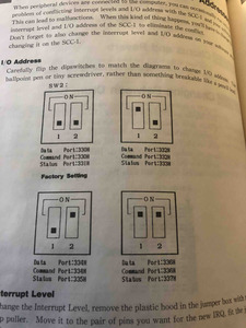

Hey, Carlostex, would you be willing to share the source for this so it can be used for other cards using other addresses too? I have this problem using an LAPC-I on 330, but I want to use an SCC-1A on 336.

Tempus wrote on 2021-02-16, 20:50:
I uploaded the diagram for the address-switches
I'm aware of the ports the SCC-1 uses, Tyrian is a game that supports all those on purpose, because of an SCC-1. I've made a revised version of the program real fast to make port 336h available. I've uploaded it on my previous post. This program was coded in assembly, so i'll make a better version wit huser input in the future.
