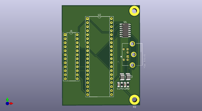

I've got it handled, going to desolder the VT82C41N and spin up a little PCB that mounts to a slot bracket with a DIP-40 KBC, 7406 and associated passives. Then connect that to the DIP-24 socket with a ribbon cable.
I was hoping that the mini-KBC might have the ability to drive a mouse but it appears it does not. I'm waiting for a 28C010 to arrive from china so I can enable ps/2 support on my own board and probe the 4 unidentified pins on it with a scope, as a last resort.

According to layout you are planning on using AT keyboard connector located on MB.
Why don't you just place both PS/2 mouse and keyboard connectors on your board?

I guess I didn't see a reason to bother. I don't like having jacks that don't work either, since the one one the motherboard would be disabled by your suggestion - plus it would increase BOM cost with another set of inductors/pullups/filter caps.
All that extra crap would cost as much or more than a DIN to mini-DIN adapter dongle
