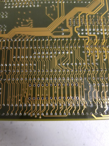

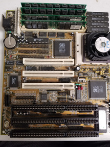

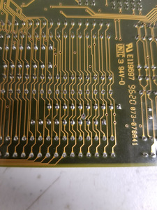

Reply 6 of 22, by maxtherabbit
this is my board - no obvious revision markings I can see
Took some pics after I desoldered the DIP24 KBC and also of a via I found for IRQ12. I scraped off the solder resist so I can solder a wire to the via.
1.42 MiB
2582 views
GPL-2.0-or-later
1.63 MiB
2582 views
GPL-2.0-or-later
1.67 MiB
2582 views
GPL-2.0-or-later
Reply 7 of 22, by froller
maxtherabbit wrote on 2021-03-19, 00:47:
Looks pretty much like C2.
Have you tried to trace back CN1 and CN5 and resistor packs RN4, RN5 and RP9?
