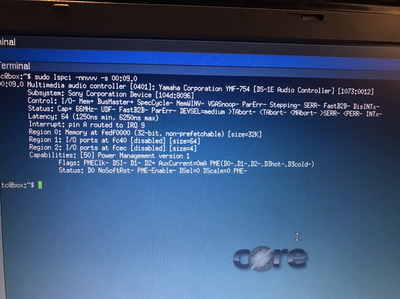

Not quite Windows, but I was able to pull the PCI ID from the Linux lspci command:
The attachment 774D37A7-A7DA-4DDD-B031-8F83883503BE.jpeg is no longer available
(Yes, I tried adding the subsystem ID onto the inf file on your driver set - doesn’t seem to fix anything).

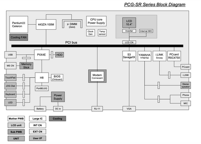

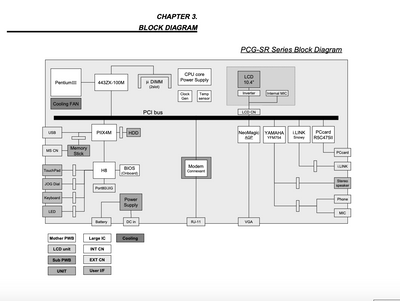

The SR17k should be a 700MHz model model just like my SR9G/K - to be honest Sony could've done everyone and their mother a favor by releasing a single model and not "bin" the minor variations. I mean, just look at these block diagrams for the 2 major models.
The attachment Screen Shot 2021-04-02 at 11.12.51 PM.png is no longer available
The attachment Screen Shot 2021-04-02 at 11.16.19 PM.png is no longer available
The service manual for the 27k should also apply for the 1,7,9,17,21, 31, 33 and other models in the PCG-SR series.
https://tim.id.au/laptops/sony/pcg-sr27%20sr27k.pdf

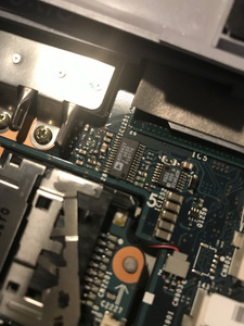

Just took my SR17k apart to look at it. The codec chip is the AKM4543.
So now I am going to try this driver and see how it works.
Fun thing about this full driver set is that it should work for all 744 and 754 solutions... mwahahaha.
