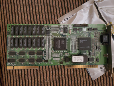

After extensive searching on Ebay, I managed to score a ATI Mach32 VLB with 2mb DRAM, model # EXM229:
1.76 MiB
368 views

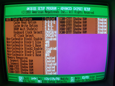

I was excited to throw it into my 486DX2-66 VLB system (PCChips M601), thinking it would be a huge upgrade over the atrocious TVGA9200CXR. As soon as I powered it up, I noticed that the text became "chunky" all of a sudden, like the Mach32 was operating in CGA mode. Here's what the BIOS screen now looks like:
910.79 KiB
368 views

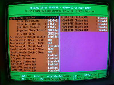

Here's what the same screen should look like, with a GD5429 ISA:
901.48 KiB
368 views

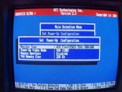

After some more searching, I found that there is a Mach32 utility, INSTALL.EXE, that can set the video mode when booting up. Thinking that my card was set to CGA mode or something, I ran it but didn't see anything out of the ordinary:
1.01 MiB
368 views
Does anyone know what could be wrong with my Mach32 and why it's displaying weird text, or why it hangs up Win95? If I have a bad card, it is not too late to reach out to the Ebay seller. It was tested according to him (to what extent IDK) and has warranty.
The screen says VGA Memory Size : 256kb
Is the VGA ROM loading at power on?

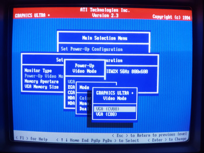

Reply 3 of 5, by NScaleTransitModels
I figured it out!
Changing the VGA Memory Size didn't make a difference, and the power-on screen looked normal with the "ATI MACH32 VLB" string displayed.
But it turns out there were video mode options that I missed in INSTALL.EXE. I first thought that changing from VGA mode to CGA mode and back might correct the EEPROM or something. But upon selecting VGA mode again, I was presented with two different Color VGA modes, VGA (CV80) and VGA (C80). It had previously been set to the second option, but choosing the first option fixed the text mode and also allowed Windows 95 to boot up!
My only guess is that this card was set to a more conservative text mode, to be tested and installed by an OEM. But it was never installed by said OEM!
1.77 MiB
323 views
Thanks for the responses! Also, here is the site with info and INSTALL.EXE for anyone who may need it: https://www.ardent-tool.com/video/ATI_Graphic … _Ultra_Pro.html

Reply 4 of 5, by the3dfxdude
I think it's more likely a corrupted EEPROM causing it to fall back to CGA. I've had a corrupted EEPROM on one card before, I had to go back through all the PNP settings to fix incorrect behavior. I don't think they would have shipped a SVGA card, and had to provide OEM instructions to make sure the installer configured the card first to run graphical programs on boot because it's shipped to boot in CGA emulation mode. If someone has the install instructions, maybe it will be clear then.
Edit: The page you shared hinted that a factory default setting should have allow booting to Win95 at least. Not sure why resolution support is not auto detected. Maybe because extra RAM sockets?
Reply 5 of 5, by megatron-uk
I've had similar on a 3Com card before - the onboard serial eeprom was corrupt and if you tried to load a packet driver or anything, it just wouldn't work. After running the setup utility, loading the defaults and writing them back fixed it.
