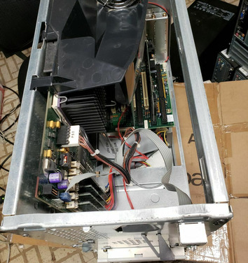

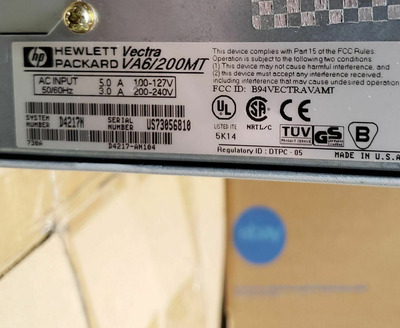

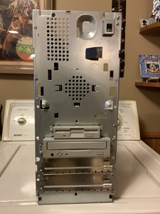

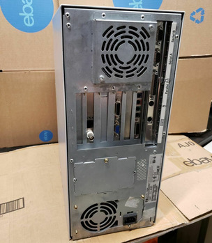

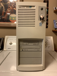

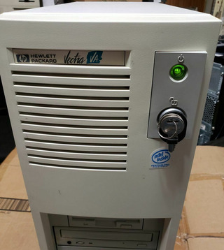

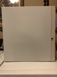

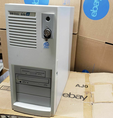

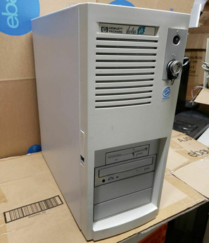

I just picked up a HP Vectra VA 6/200MT with the following specs:
Midtower case with four 5.25" plus three 3.5" drive bays. Three exposed 5.25" drive bays and one hidden 3.5" bay available
180W AT power supply with thee free power leads (all 4-pin Molex)
Intel 200 MHz Pentium Pro processor in socket 8 with a clip-on heatsink and a plastic ventilation duct for air drawn in by a rear case fan.
Intel 440FX chipset motherboard
64MB pf EDO RAM in 4 of the 6 72-pin SIMM sockets. Memory is upgradeable to 192MB by using six 32MB SIMMs
4 PCI slots and 4 16-bit ISA slots, staggered so that with the current 3 cards installed 3 slots are still open.
Creative Labs Sound Blaster 16 ISA sound card, CT 2970
CNet ISA sound card, 10Mb/sec, with RJ-45 and BNC connectors
Original Matrox Millennium PCI graphics card with 2MB WRAM
Quantum Fireball 2.5GB IDE hard drive, 5400 RPM, ATA-33, 512MB cache
1.44MB 3.5" floppy drive
Hitachi CDR-7930 8X IDE CD ROM drive
2 PS/2 ports, 1 parallel port, 2 DB9 serial ports
Two keys for preventing keyboard input
I am planning some upgrades which will include:
Pentium II Overdrive @333MHz
192MB of EDO memory 6x32MB 72-pin SIMMs
ET6100 4MB PCI video card
3Com 3C905B 10/100 PCI network card
CompactFlash to IDE adapter
8GB CompactFlash Card
I worked on Pentium Pro computers in the past, but never owned one. Any comments or suggestions beyond on what I have planned will be welcome:)

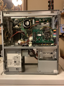

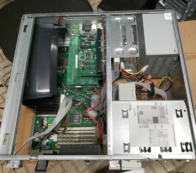

Reply 1 of 20, by evasive
Going the Voodoo way maybe?
If your motherboard is matching this layout:
http://www.win3x.org/uh19/motherboard/show/2862
We would like to have pictures of the entire front and back if possible.

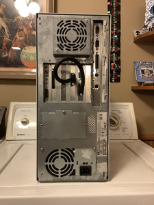

A couple more pictures

Reply 4 of 20, by jasa1063
chrismeyer6 wrote on 2021-05-28, 14:52:
That's a sweet looking case. I also love a good PPro build.
Those pictures of from the seller I got if from. Stupid Fedex dropped the box off with a big thud. If you shook the box it sounded like broken dishes. I was worried the computer was beyond fixing. They only broke the plastic shroud on the inside the covers the CPU. Thankfully there was no other damage to the computer and it is working just fine. I am anxious to get all the upgrades going. This thing is going to be one sweet rig when I am done with it:)

I have the computer finished. I had 2 problems to overcome. The 1st was getting the 8GB CompactFlash drive to boot. The built in BIOS does not like any hard drive approaching 8GB. It will just freeze. It works fine with the smaller 2GB CompactFlash cards I have, but I wanted to be able to use larger CompactFlash cards. To get around the problem I took a Lo-Tech XTIDE adapter and flashed it with the XTIDE BIOS using the IDE_386L.BIN rom. I configured Shadow Ram for the 8-Bit card and now it boots just fine. The biggest advantage is I can use any size CompactFlash card and not have to worry about that anymore. The 2nd problem was with the Sound Blaster 16 CT2970. It kept freezing the system trying play any audio in Windows 98 SE. I finally pulled that card and put in Sound Blaster 16 CT4170 and now the audio is just fine. Here are the specs of the computer:
Pentium II Overdrive @333Mhz (Had to upgrade the BIOS to be able to use this CPU)
196MB of EDO ram 6x72-Pin 32MB SIMMs
ET6000 4MB PCI video card
8GB CompactFlash card using an IDE to CompactFlash adapter
8X IDE CD-ROM
Windows 98SE with the Unofficial Service Pack 3
I may still go with 3D video down the road, but for right now I am satisfied with the current setup. I will be posting some pictures later on this week.

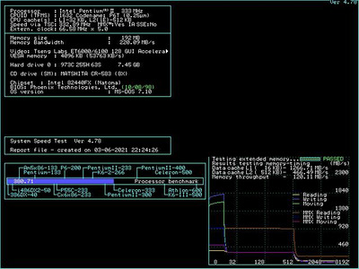

I forgot to post a quick bencmark using SpeedSys 4.78:
