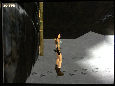

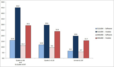

Reply 22 of 73, by Joseph_Joestar
And here are the benchmarks. I've also included software rendering, just to showcase how much of a difference a Voodoo1 can make on a system such as this. FYI, I'm using Win95 OSR 2.1 + DirectX 7.0a paired with the latest 3DFX reference driver v3.01.00 and also MiniGL v1.49 for the Quake games.
50.33 KiB
2898 views
As you can see, the Voodoo1 performance in Quake 2 (1997) and Unreal (1998) is a bit lackluster. But if you consider the fact that those games are literal slideshows on this system when software rendering is used, the Voodoo does seem like magic. I have also tested a few more games using Fraps 1.20 to measure the frame rate where applicable, but they don't seem to have dedicated benchmarks, so I've decided to post a short performance summary for each of them.
Descent 2 (1996)
With the official Voodoo patch applied, Descent 2 runs very nicely on this card. I get 60+ FPS most of the time, with some dips here and there, usually when a large number of enemies are on the screen. Overall, the game feels very responsive and plays superbly.
Tomb Raider 1&2 (1996 & 1997)
Both of these games run great on the Voodoo1. Performance rarely falls below 30 FPS (which is the in-game maximum) and when it does drop, it goes to the mid 20s at most. For reference, these games run at roughly 10-12 FPS in 640x480 when software rendering is used on this system.
Final Fantasy VII (1998)
This game runs very smoothly, with some minor dips while flying around the world map. Most importantly, all mini-games (e.g. G-Bike) run at the correct speeds on this system and can be completed without any problems. On my Celeron + Voodoo3 rig, those mini-games were borderline unplayable as they ran so fast that it was impossible to properly control the character.
Thief: The Dark Project (1998)
This game doesn't run too well on this system. Some of the stutter is likely caused by the slow CPU, but the framerate is still too low at 640x480. When I drop the resolution down to 512x384 the situation improves a bit, with FPS going into the 20s. Not smooth by any means, but technically still playable.
In conclusion, the Voodoo1 is fantastic for DOS Glide games. It also runs early Windows 3D accelerated titles quite well. However, I wouldn't recommend using it in demanding games made from 1998 onward, as it likely won't be able to deliver enough performance. All in all, it's great to have this piece of history in one of my rigs. The original Voodoo kickstarted the 3D revolution, and using it to play games that came out during its glory days feels very satisfying.

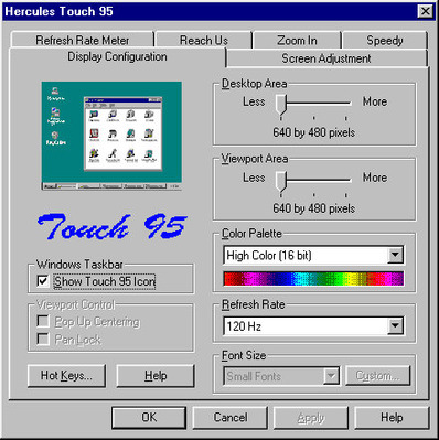

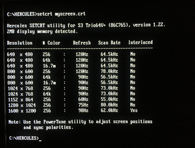

Reply 26 of 73, by Joseph_Joestar
Ok, the Hercules Terminator 64/Video is superb. I just downloaded this Hercules driver CD from August 1997. Among other things, it contains the official Win 3.11 and Win95 drivers for this card. After installing the Win 3.11 drivers, I noticed that the SETCRT utility works in pure DOS too. Basically, it does what VBEHz and S3Refresh do, but only for Hercules cards.
The truly amazing thing is, it allows this card to run DOS SVGA games at 120 Hz! Of course, provided that you have a CRT monitor capable of that. I was aware that this was possible using VBEHz and a VBE 3.0 capable graphics card (e.g. GeForce 2) but to see refresh rates this high on an lowly S3 Trio64V+ is something else entirely!
235.51 KiB
2701 views
Anyhow, this works under Windows 95 too, and the installation is much simpler there. Just open up the "Hercules Touch 95" application and select your preferred resolution and refresh rate.

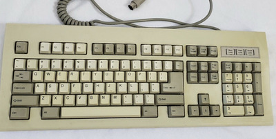

Reply 27 of 73, by Joseph_Joestar
215.42 KiB
2621 views
I recently got a Chicony 5311 from my local classifieds. It's one of those run-off-the-mill AT keyboards that were commonly sold with "value" systems during the mid '90s. However, it's kind of special to me, since this was the exact model that came with my very first PC.
After carefully disassembling the keyboard and taking out the electronic components, I gave it a thorough wash. To be extra safe, I let it dry for a whole day before putting everything back together. Now, it's squeaky clean and feels very nice to use.
On a side note, I actually like that it doesn't come with Windows keys, since I sometimes end up pressing those by accident while gaming under Win95. The absence of a large backspace key is somewhat irksome though.

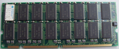

Reply 33 of 73, by Joseph_Joestar
So far, this Soyo SY-5BT motherboard has served me quite well, except for one thing - it only ever recognized half of the capacity of any SDRAM modules that I previously had at hand. For example, I would insert a 64 MB SDRAM stick and it would only see 32 MB. I imagine this has something to do with memory density, but I'm not super familiar with the subject. Well, today I finally purchased a 64 MB Hynix memory module where this does not happen, and the motherboard correctly recognizes its full capacity.
155.13 KiB
2250 views
The module looks fairly unusual to my eyes, having two rows of chips on each side (front and back), but it works perfectly with this motherboard. Memtest86+ didn't find any errors after running for 10 hours. Performance is excellent too, so I guess I'll keep it.
