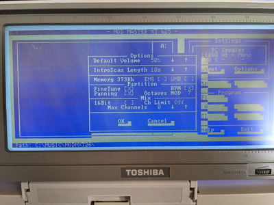

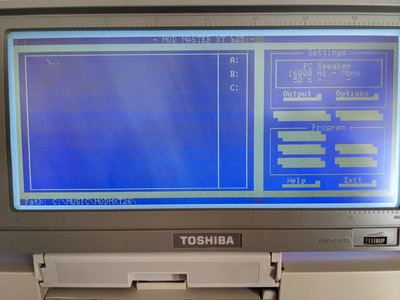

FreddyV wrote on 2021-06-24, 20:52:
Hi Freddy! I would like to try Mod Master on my Toshiba T1200 XT portable (it has Adlib xt card installed!) it only has monochrome CGA though and the interface does not seem to display correctly (using msdos 5) Some buttons/icons are not showing text. Could you help? thanks

mzry wrote on 2021-08-21, 21:27:
Hi Freddy!
Hi,
Modify the interface display is quite difficult.
You can press o for options, t for output to configure Mod Master, no need to see the buttons.
Can you do a picture, so that I see the button visible and not visible ?

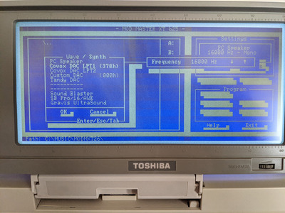

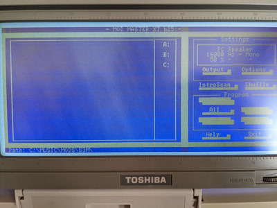

Here Freddy, I photographed most screens for you. The most difficult part is that it doesn't seem to display any music files on the main screen. It's just blank. I also cannot tell what is highlighted, so navigation is guesswork. thx.
