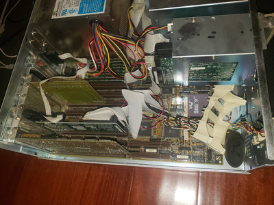

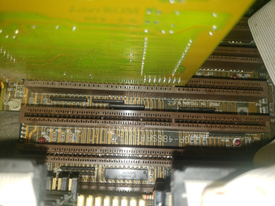

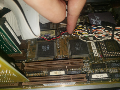

I just picked up a complete and functional 486 box. It was listed as having VLB slots, so I grabbed it to maybe do a VLB build. I was shocked when I received it today and opened it up. It came with a GA-486SA motherboard, which looks to have both EISA and VLB slots. It is almost impossible to believe, as I've never seen a EISA+VLB mobo in the wild, let alone imagine receiving one in a mystery box.
But are these really VLB slots? I recalled reading that the FX-3000 386/486 motherboards (I have a few) had proprietary "local bus" slots that would fit normal VLB cards, but fry them on the spot. And I know there were other 1992-ish proprietary local bus slots, some of which might look like VLB. What also raises suspicion on the GA-486SA is that the manual says it has "32-bit local bus" w/o mention of VESA, and FX-3000's manual said something similar.
I don't have a means to test: the PC came with a garbage ISA Trident 8900C (just sold one of the damn things 😤) and my only VLB card is a MACH32... far too valuable to risk. Has anyone owned the same motherboard to confirm it has VLB slots? Or can suggest cheap "guinea pig" VLB cards?
Also interesting to note: the GA-486SA supports 128mb of 30-pin SIMMs, and mine is still going on the original Dallas DS1387.

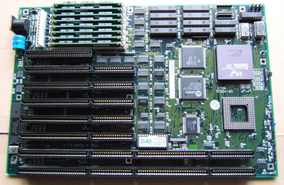

Not sure EISA + VLB is all that rare - I have an ECS board (SL-486VE) which seems to be based on the same SiS chipset as yours, and still with its original working Dallas as well 😀

Reply 3 of 31, by mkarcher
The EISA slots should be real: The 85c406 (instead of a standard ISA 206) and the 85c411 are part of an SiS EISA chipset.
There is no technical reason to not build EISA/VL combo slots, but you are right that EISA/VL combo slots are rare.
I've also seen ALi chipset based 486 boards that support 128MB with 30-pin SIMMs, but I didn't yet enter the game of acquiring the required 16MB 30-pin SIMMs.
If you have a continuity tester, you might want to test address/data pins from the suspected VL slot connectors to the corresponding processor pins. Likely there are no buffer chips between the local bus slot and the processor on this board. If data and address lines match up, the slots are likely VL slots.
VL slot pinout: https://old.pinouts.ru/Slots/VLB_pinout.shtml
486 pinout: http://ps-2.kev009.com/eprmhtml/eprmx/h12203.htm (quite good site, including all the pinout variants, but they have A13 and A16 swapped)
Reply 4 of 31, by dionb
Rule of thumb: a board with EISA-like slots with 4 or more of those slots is almost certain to be EISA, as truly local bus (OPTi etc) never supported more than three slots.
Three EISA-like slots is grey area, as there was an EISA-light controller that only did 3 EISA slots, and 3 OPTi local bus slots is theoretically possible, but unlikely.
Two EISA-like slots is most likely OPTi local bus.
A single EISA-like slot is either OPTi or a PISA slot for a riser. The latter would be on a board with PCI slots too.
Tbh, I'd be more concerned about the apparent VLB slots here than the EISA: VLB+EISA was rare, and one of the vendors doing it was ECS - but ECS had its own proprietary local bus, using the same physical form factor as VLB, just with different pinout (including power/ground pins!). However this is a Gigabyte board and never heard of them using ECS local bus instead of VESA.
I would take anything on that TH99 page with a very big pinch of salt given absence of EISA info and the listing of OPTi chipset where it's clearly SiS...

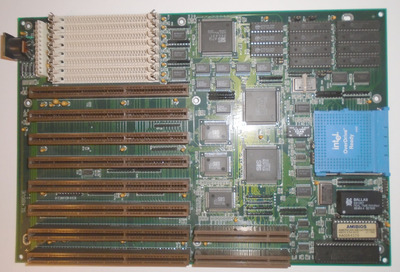

Reply 8 of 31, by PC Hoarder Patrol
The SiS chipset on your board looks similar to mine, although I'm sure I did once read that SiS could also support Opti local bus!
I'm hoping to make a build with this board soon, although suitable period cases are limited atm. I have both EISA & VLB video cards tested working with the board, but will likely stick to VLB to free up the other busmaster EISA slots for other cards.

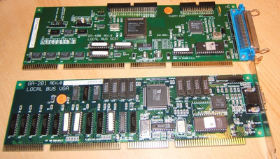

Just found this post from 2013. Apparently Gigabyte did use a proprietary 32-bit local bus on the GA-486US motherboard! But the implementation is described as being "two 16 bit ISA slots in a row", which is clearly not your case:
229.73 KiB
1973 views
GA-486US
184.6 KiB
1973 views
Gigabyte "local bus" cards
So I'd say there's a high chance that the slots on your board are VLB, unless Gigabyte created two different slot types for its proprietary bus around the same time, which doesn't sound very likely.
EDIT: stole the pictures from that thread
