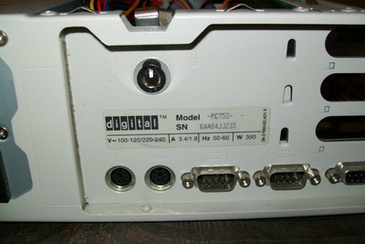

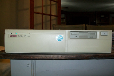

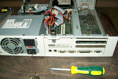

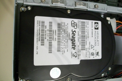

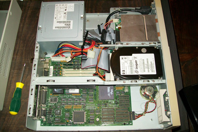

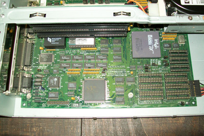

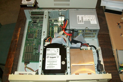

Here are a few pics. The drive with the DOS partition stopped working so I'm working to save what I can off that drive. The drive with the dos partition is digital branded drive, but the PCB says it was built by quantum in Japan. Date codes on the motherboard ICs, suggest a mid-ish 1993 build, and it looks like it was upgraded with a larger hard drive in 1995. The larger hard drive is a HP branded Seagate, which still works but has about 1/2 a MB of bad sectors on it. There was missing expansion slot cover, and I think this computer had an HP Measurement Coprocessor installed in it. It may have been in some sort of industrial environment, but, whatever it was doing, it definitely wasn't word processing.
Despite the yellowing it's very clean. I'm probably not going to retrobright it.

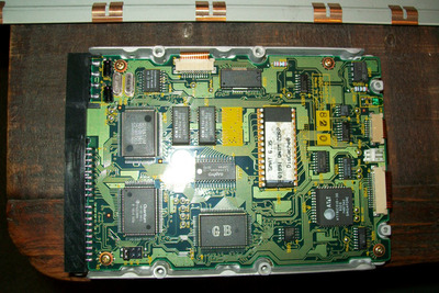

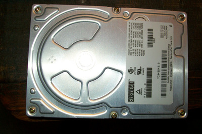

Here's some more photos, including of the original, digital branded HD.
When I could boot off that drive, DOS showed a disc size that was about half of what the drive lists. My Windows 7 and 10 machine insist that I need to initialize and partition the drive in order for them to see it through my USB to ATA convertor. I'm going to see if I can read the drive on one my Win9X systems. I know it has some bad sectors, but I'd love to keep it running.

Looks good. Great thing is the Dallas battery is socketed. These are picky on the ram type and size but can go up to 64megs 😉\
Managed to get 16megs for my one for OS/2v3 Warp.

pentiumspeed wrote on 2021-08-21, 01:52:
Also you have a nice one with 12 bit tag plus main cache chips. Plug them in.
Cheers,
That's the plan. I already have 128kb of the main cache. Once I establish a benchmark baseline, I'll try 128kb of cache plus the tag ram and see how it runs. I'll probably go 256kb in the end. Why not?

I do like the LPX "pizza box" form factor.
I wouldn't be able to help myself and upgrade the CPU, but that's just me. Rest of the upgrades make good sense.
120MB maybe a bit small once you install all your games, but only 1 way to find out!
Looks like you only have 1 IDE channel. I ended up disconnecting the CD drive on my 486 instead using a "large" CF card. That way I get the sound of spinning rust at start up plus something fast and convenient for all my games, install files, etc. I also have mine networked and find I've very little need for CD drive now. Just an idea
