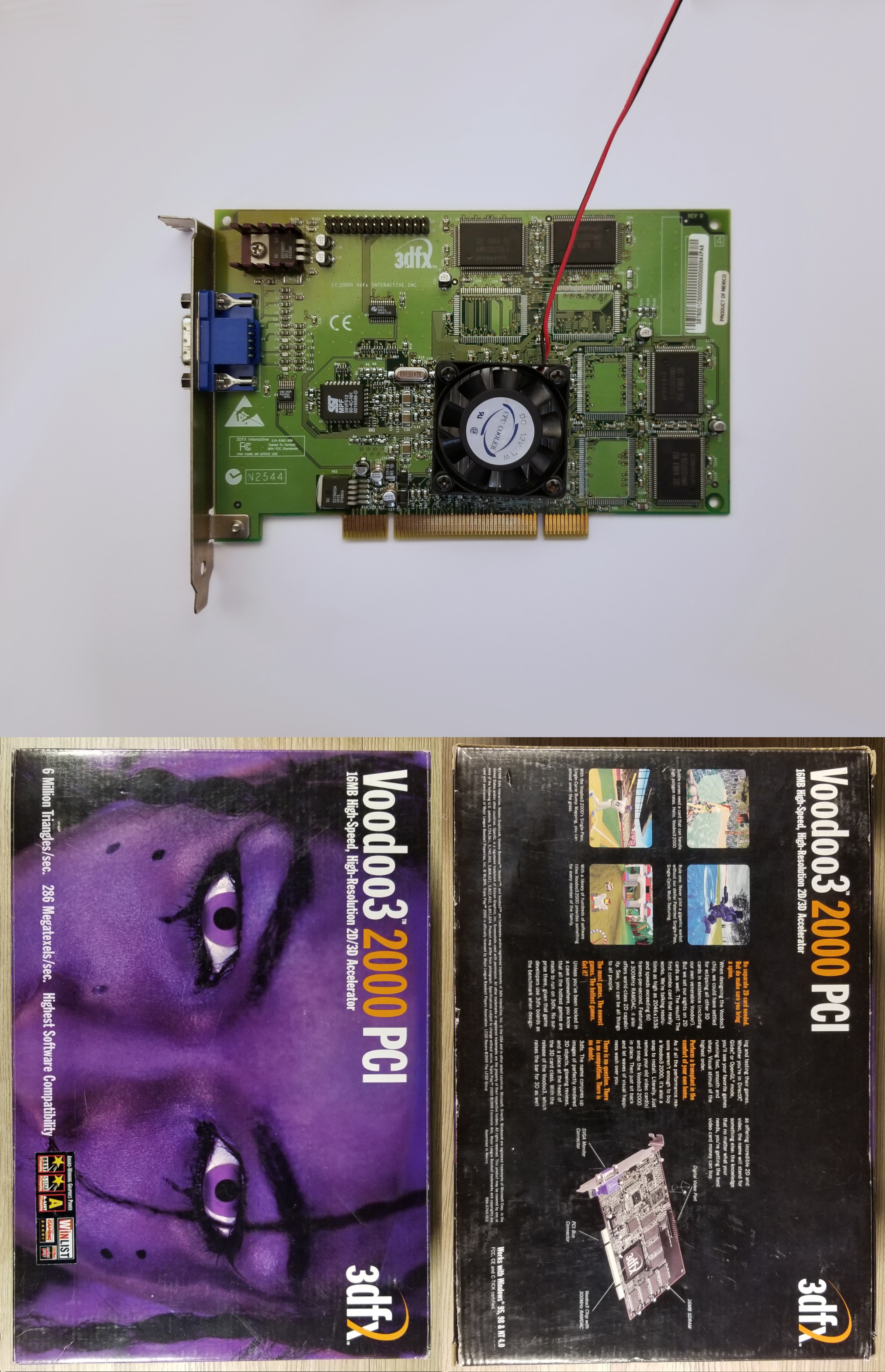

Looking at Voodoo3 2000/3000 prices - unlikely to spend hundreds of $ on them. Not convinced they do better than TNT2 to start with. (or am i wrong ?)
TNT2/16Mb is a bit more reasonably priced, but still $100++.

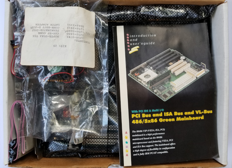

Reply 507 of 2521, by pshipkov

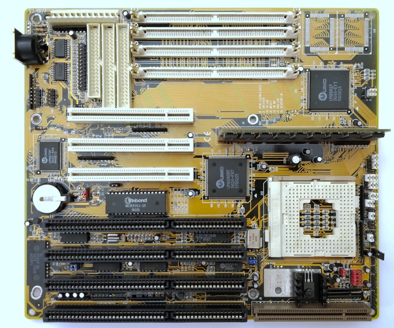

Probably the last (for now at least) addition to the 486 at 180MHz - an exercise in practicality investigation.
PC-Chips M919 V3.4B/F - last revision of a long line of infamous motherboards.
There is plenty of information online about it but not much about its performance qualities.
So, let's see how this guy does perf-wise.
Used this one for the tests:
There is another one still in the original box + cables, booklet and Am5x86 133-ADW CPU.
Supports all Socket 3 CPUs of its time. A bit convoluted jumper setup.
ADZ CPU models require 4V, while ADW do just fine with 3.3V.
Noticed that some motherboards have such "requirements", while others handle both CPU types at 3.3/3.45 no problem.
UMC UM8881F-EYT/UM8886BF-FXT chipset.
Custom 256Kb L2 cache module with 15ns rated chips. Frees space on the PCB, but upgrades are difficult.
L2 cache is used in WT mode. Performance is same or faster than WB, depends on which test you ask. This is the norm for most 486 motherboards. Only some rare exemplars such as Asus PVI handle WB properly.
Supports EDO RAM.
For some reason performance suffers if exactly 64Mb memory is installed, but fine with any other number. This is confirmed by other users later in the thread.
Tested with 32Mb 60ns module. (EDIT: 2 years later - additional testing with 128Mb was performed as well while assisting somebody to figure out issues with his M919.)
Favors PCI over VLB which is in line with most PCI/VLB hybrid implementations based on that UMC chipset. Didn't like ARK1000VL VLB video cards (best for DOS graphics). Used S3 Trio64 VLB instead, which is a hair behind in DOS, but does way better in Windows GUI.
Implicit bus divider. FSB over 40MHz causes it to automatically kick-in. This is remedied easily by POSTing with TURBO turned-off. Still annoying.
Latest BIOS 09/15/1998S.
The built-in IDE controller is not great.
Also, can hang sometimes (very rarely) upon soft reset with CF cards bigger than 8Gb. Hard reset fixes it.
Didn’t encounter this problem with smaller CF cards.

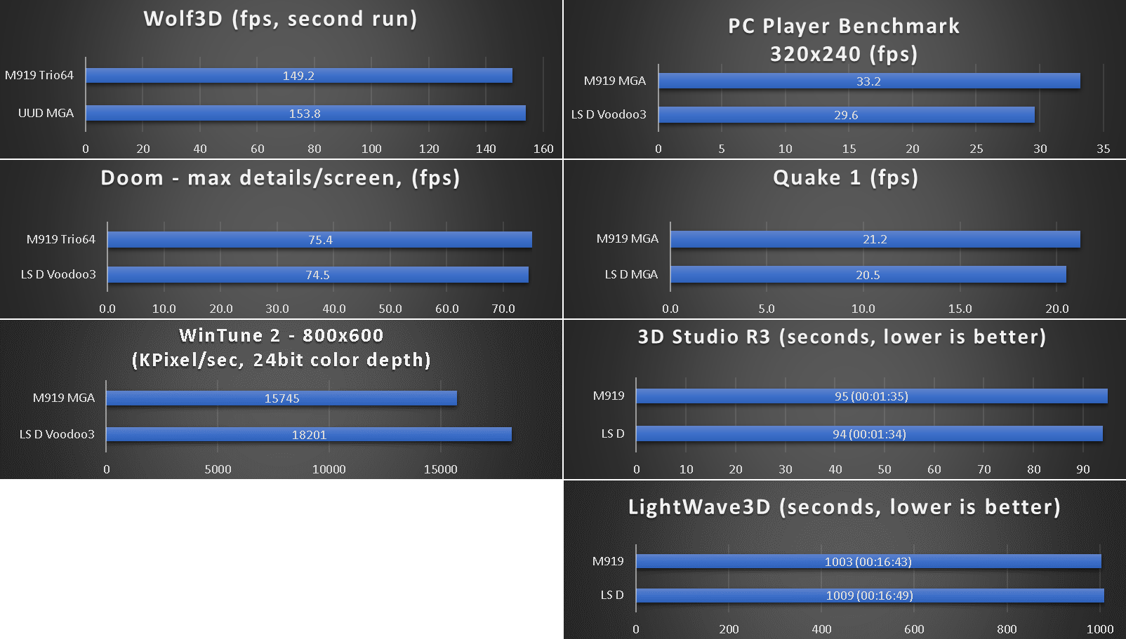

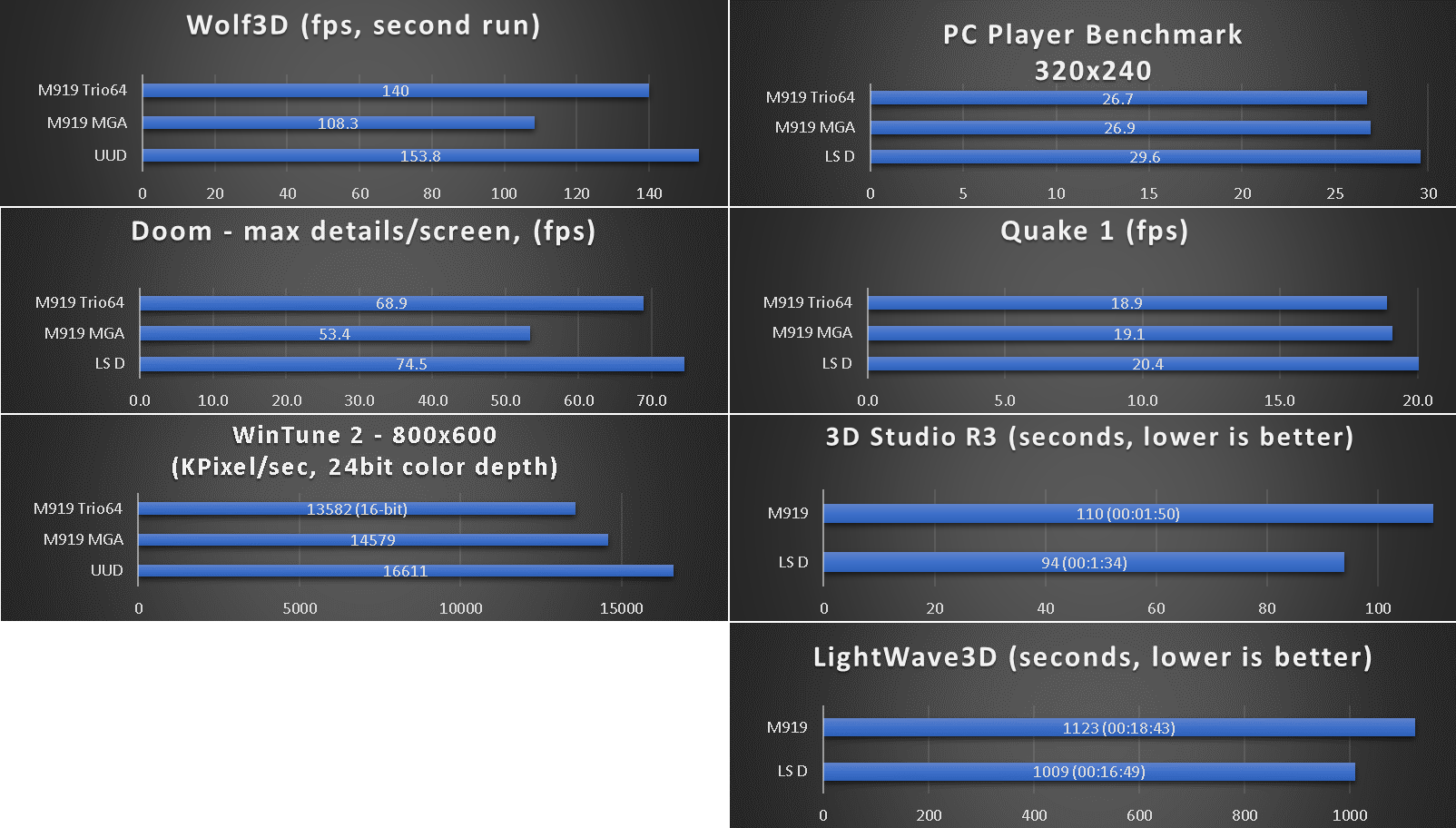

The usual set of benchmarks, compared to LuckyStar D and Biostar UUD.
Provided are results with both MGA PCI and S3 Trio64 VLB graphics adapters.
Obviously not the fastest motherboard out there.
Comes with too much baggage - implicit bus divider, limited RAM (or things get slow), IDE issues, basically non-upgradable L2 cache.

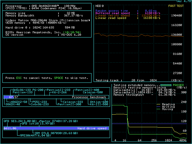

1024Kb L2 cache
Managed to obtain 1024Kb L2 cache module from a fellow Vogon user (he produced them).
It turns M919 into what looks like the best motherboard at 180MHz.
All BIOS settings on max except:
DRAM READ WAIT STATE = 1 (0 is best)
Basically, the faster rated chips of the new L2 cache module allow for CACHE SPEED OPTIONS to be set to 2-1-2.
Very satisfying.
System is fully stable.
The fastest overall motherboard in the 180MHz category. Effortless. Just works.
Attention must be given to the automatic PCI bus divider - boot in 40MHz FSB then switch to 60MHz (pull one jumper).
The built-in IDE controller is a bit lacking compared to the other qualities of the system.

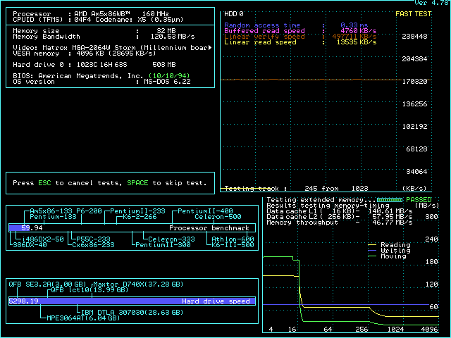

Speedsys (this is an old screenshot with 256Kb level 2 module):
benchmark results
While performance gets a nice boost, the larger L2 cache buffer is still not enough for the board to outdo the rest.

Reply 508 of 2521, by feipoa
Buffered read is only 5736 KB/s with /D0:17 /F0 /MMO ? Seems kind of slow doesn't it?
Funny that your v3.4B/F has only one BJT transistor for the VRM, whereas my v3.4B/F boards have two. I guess PC Chips threw out PCB revision control too!

Joking aside, I noticed that there are versions with two VRMs. The one i have works fine with dx2, dx4/5 and pod83/100 processors. Also, can do 200mhz dx5 at 4v. So all is good it seems.
So, not sure what the role of the second vrm is. Tracing the lines may reveal its purpose.
Yes, IDE perf is not shockingly good, but the driver does something, because the linear read speed goes through the roof with it.

Reply 510 of 2521, by BitWrangler
Should compare part numbers, the whole string, might have like an XXX-C part that handles 20Amps and they couldn't guarantee supply, so some boards got XXX-B parts in tandem that only handle 12A each or something.
Reply 511 of 2521, by feipoa
Read me the part number on your BJT and I'll read you mine. I bet they are the same, if there is even a part number. They probably ran out of this part on that particular day and decided to ship it anyway.

Reply 513 of 2521, by pshipkov
VRM model is C3420.
Datasheet: https://www.jbprojects.net/projects/wifirobot/c3420.pdf
Didn't time the IDE speed the old fashioned way. The overall performance and stability didn't meet the expectations, so spending more time on IDE itself was pointless.
Agreed Jake.
I noticed that the UMC IDE driver can confuse SpeedSys for good. But checking with ATTO for example shows believable numbers. So far didn't recognize specific pattern, but i think you are right. SM0 keeps the numbers real.
Confirm from my side that the UMC IDE controller/driver show higher perf numbers with mechanical HDDs compared to CF card, but CF are similar, or faster in the most cases. Mostly attributed to seek time / random access.
It will be good to dump the collected data into its own thread.
Get some numbers organized by mobo, BIOS settings, storage device, driver settings. So we can see it.

Reply 514 of 2521, by feipoa
I'm still puzzled by your slow buffered speedsys result. My best result with a UMC IDE controller is with v3.1 using /D0:17 /F0 /SM0 at 8327 KB/s. Speed 16 and 17 yield the same benchmark results. Of course, that is with CF cards 8 GB or less.v3.2 of the driver yielded 7453 KB/s.
lol, yes, someone should start and compile the UMC driver data onto a new thread. Obviously, when someone (me) says "someone" in this context, it means "please not me".
on one of my flakey m919 v3.4B/F boards, there are two of these BJTs: D2583
on my other flakey m919 v3.4B/F boards, there are two of these BJTs: C3420
So looks like with your batch of these boards, they ran out of parts to meet their daily or weekly quota.

At the same time only one VRM works just fine. Btw, tried to trace the left VRM lines, but they seem to be in the middle PCB layers. Only one fat line goes to a capacitor, the rest is not visible.

Found a Voodoo3 PCI graphics adapter for $125 including shipping and tax.
