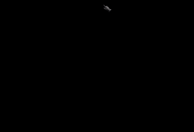

i was trying wast QEMU for Windows (4.2) to try setup Dos machine on Win 10 1909, but im stuck on half working keyboard (arrows key press work as double press) its some way how to fix it?
I have just vanilla Dos 7.1 install and its in every filemanager which i tried.
Picture animated Gif (works after click on it):
The attachment QEMIU-DOS-KeyboardProblem.gif is no longer available
I have also problem that numeric keys are not working us numbers, but as arrow keys, what is nice workaround, but far from desired, after 27 years of using arrow keys its hard to get used to it.

i tried File Wizzard and Dos Navigator and you are right in Norton Commander and command line (tested through history) its working fine.. but same binaries are working fine with real machine, Virtualbox and Vmware Dos machines, same in Dosbox.. So i dont believe that its some DJGPP bug, it has to somehow connected to QEMU too.

I tried M602 Filemanager from 1991 or so, its has exactly the same problem, i really doubt that there is any piece of DJGPP inside it..
Volkov commander is fine too.

That program uses Borland's Turbo Vision, which is a known cause of the double keypress detection for arrow keys in Qemu (references: 1, 2). I've hit the problem myself with various Borland applications and other Turbo Vision applications, and also in GW-BASIC which this Qemu bug mentions is another known cause of the issue.
This Qemu bug mentions that there is a fix in Qemu 6.1 which you need to activate using the command-line option -global i8042.kbd-throttle=on and I can confirm that it works for me with Borland Turbo Vision applications and GW-BASIC.
