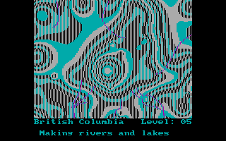

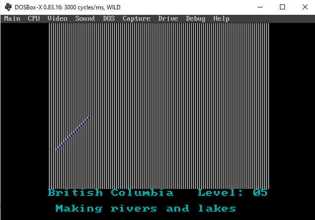

Reply 2214 of 2397, by MKSheppard
I believe I've found something in DosBox-X; I don't know what exactly is broken but for the old DOS game "WILDERNESS: A SURVIVAL ADVENTURE"...
if you run it with DOSBOX 0.74; you're able to generate new topographic maps to play on, as well as save topo maps and games.
But if you try running it in DOSBox-X, you get a bad topographic map generation routine; and I think you can't save topo maps or games in progress.
    5.17 KiB
    2802 views
    Wilderness in DosBox-X 0.83.16 SDL2
    4.96 KiB
    2802 views
    Wilderness DosBox 0.74 Topo Map Generation #2
Reply 2215 of 2397, by TheGreatCodeholio

Reply 2216 of 2397, by BitWrangler
Wonder if it uses timer jitter for randomness or some other trick.
Reply 2217 of 2397, by TheGreatCodeholio
BitWrangler wrote on 2021-09-10, 01:27:
It's possible. Some games use the PC speaker timer. Some games when they do that correctly turn that PIT timer on (clock gate) while keeping the PC speaker muted to read that. However I've also seen games that ASSUME the PIT timer clock gate is on, and will fail in that way if it is not.
Try using a DOS program or DEBUG.EXE to write 03h to port 61h. This will make a BEEEEEEEP but will turn on the PIT timer as well.

Reply 2219 of 2397, by MKSheppard
TheGreatCodeholio wrote on 2021-09-10, 01:30:
I got DEBUG.EXE, but I'm trying to figure out how to write 03h to port 61h.
I'm trying this in debug:
-o 61h 03h
but I get an ^ error pointing at the H
EDIT:
I tried
debug.exe
-o 97 3
https://beausanders.org/ascii.htm
03h = 3
61h = 97
and WILD.EXE is still giving the malformed topo map generation
