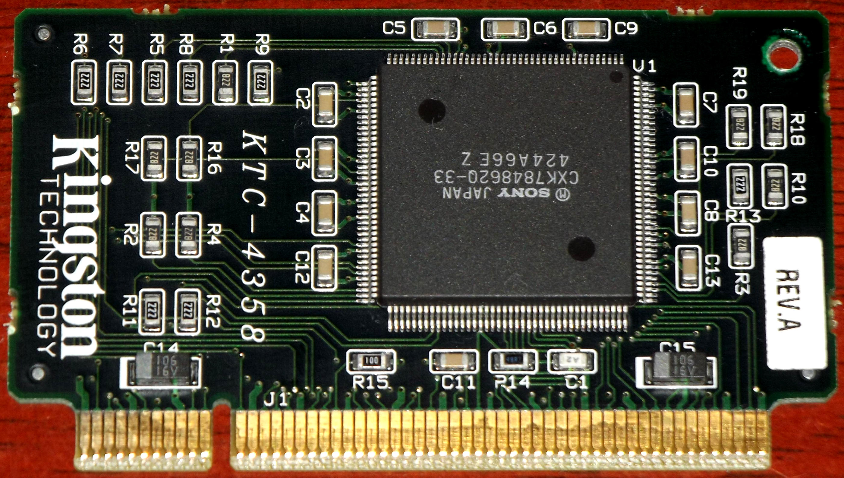

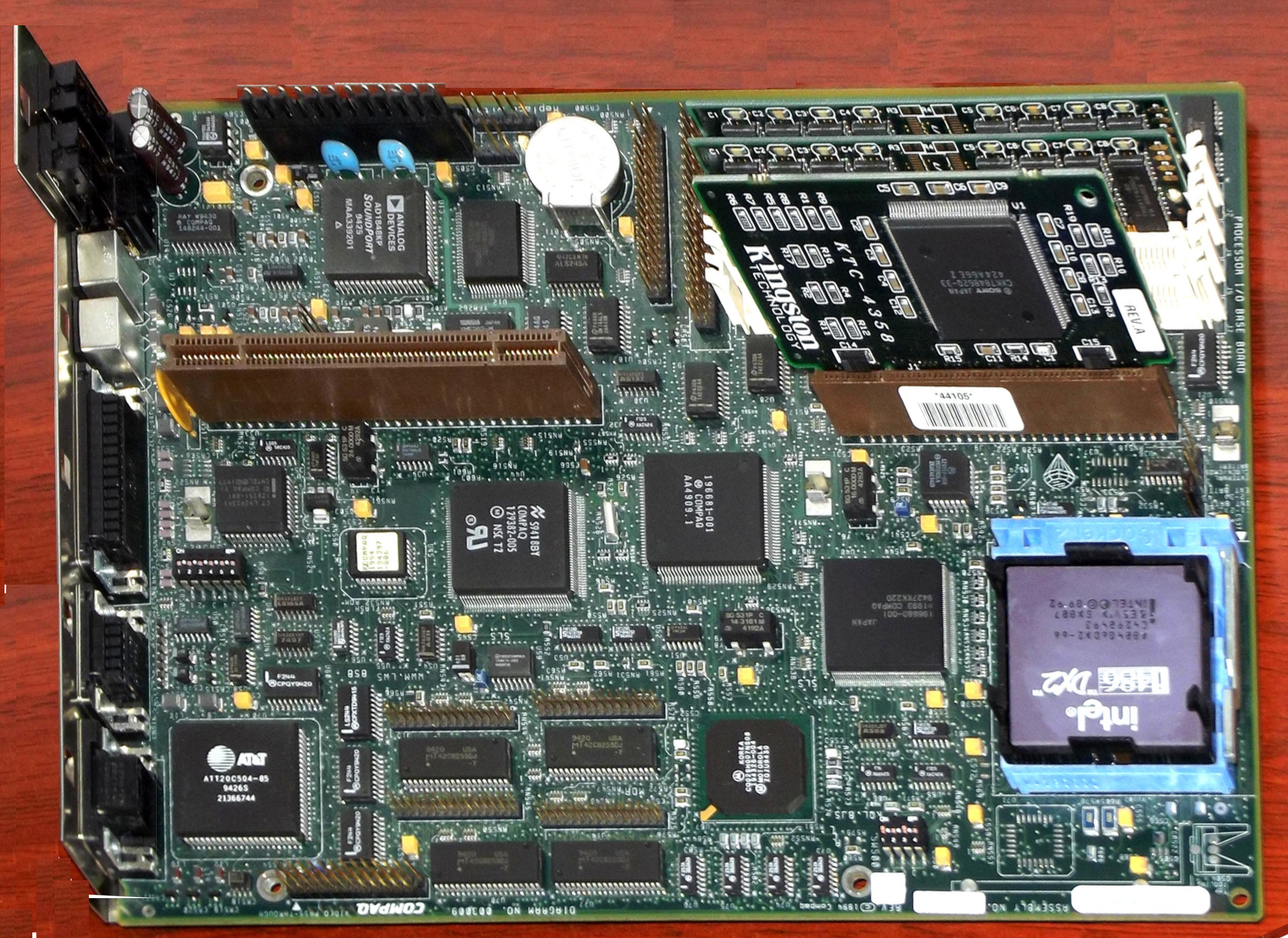

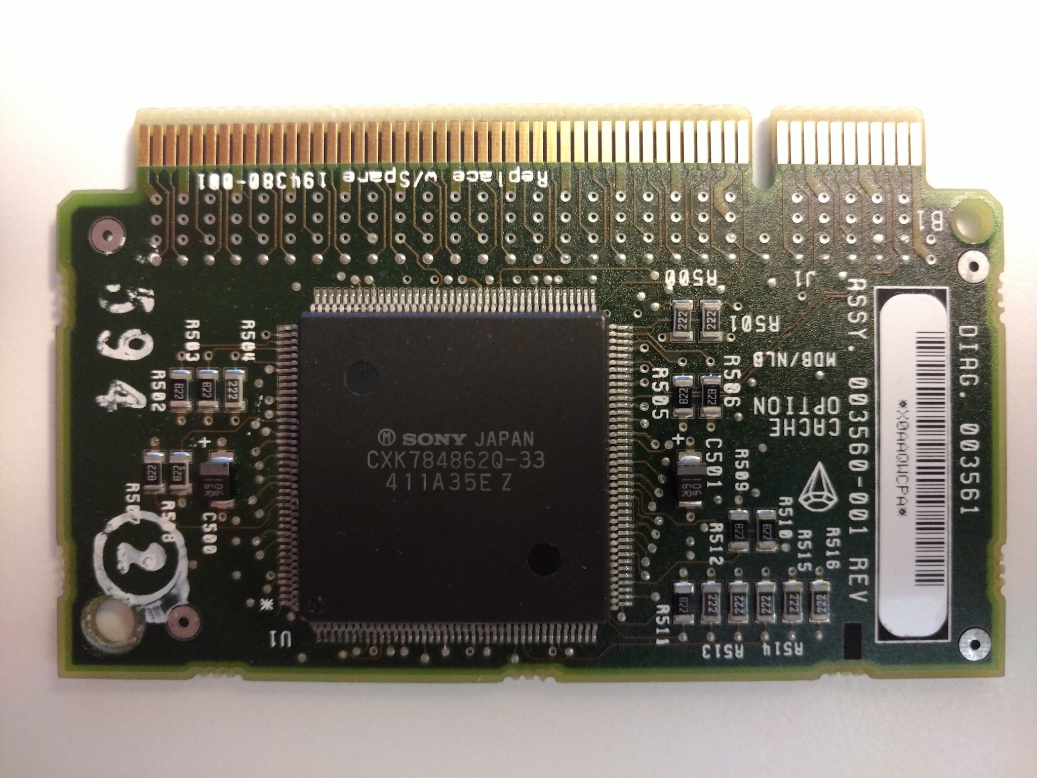

Reply 112 of 113, by Darkchild
Hi. Does anybody know if this cache module works with Compaq Deskpro XE 466?
Thank you in advance for an answer.
Reply 113 of 113, by rasz_pl
Darkchild wrote on 2026-03-27, 13:21:
sadly no, https://theretroweb.com/motherboards/s/compaq-deskpro-xe-486 uses Sony CXK784862Q-33 based 256KB Kingston KTC-4358
https://raw.githubusercontent.com/raszpl/FIC- … %20KTC-4358.jpg
https://raw.githubusercontent.com/raszpl/FIC- … kpro-xe-486.jpg
maybe 194380-001 compatible
