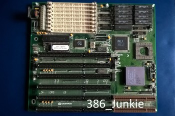

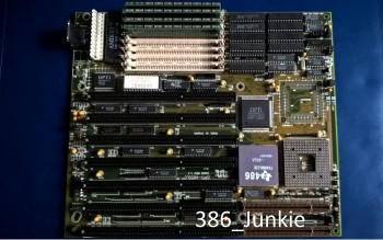

In answer to the thread title though, "the best 386 motherboard"... you have touched on one of my flagship projects. I believe the answer to this would be from the below eight: -
281374739697413.jpg 3deeac739697443.jpg 854077739697593.jpg 05f7d0739697803.jpg abb690739697883.jpg e4d072739697983.jpg d8183e739698153.jpg 202ab1739698323.jpg
All are 386, and all are VLB. I have tested each to varying degrees, though the project is still very much work in progress. Two things have happened which has slowed things down a little, they are: -
1) Starting a new family (time is now a scare commodity these days)
2) The test hard drive I used went on the blink, along with many of my test results
I will be picking this back up when I get the chance... once the ship has steadied and I sort a new hard drive from the stack.
Regarding EISA, I have done a fair bit of testing on this as well and have made a few threads here on Vogons... some are below in my signature along the bottom of this post, and another is of the various EISA graphics cards that are out there: -
EISA Graphics card benchmark results
There is lots of information and resource to look through/at. It is a fun ride... personally I would recommend you do both a 386 VLB and 386 EISA system, testing them both for yourself and for Vogons, by publishing the results of each online... possibly even comparing them. No better way to learn and support Vogons.
They should be classified as 486 boards though.

Those all look like motherboards with a 386/486 hybrid chipset. Even the board with the ALi M1429 is a hybrid chipset, although it does not contain a socket for a 486. I recall seeing this chipset with a 486 socket as well. To me, the ALi M1429 looks the most interesting because it lacks the 486 socket and can pretend to be a true 386. It would be nice to see some benchmarks taken with the ALi M1429 with DX-40, DLC-40, SXL-40, SXL2-50, SXL2-66, SXL2-80, DRx2-50, DRx2-66, BL3-50/66/75/80/100/110, RapidCAD, and Transcomputer. Basically, all these, 386 upgrade kits and the Transcomputer 486HPi - Am5x86-160 anyone? . From what I recall from another poster, a 386 board with VLB only seems to show any benefit from VLB when using clock doubled CPUs. I'll be working on a mega 386 benchmark thread in the far future, run on 386-native motherboards. It might be of value if I can cross-reference such a benchmark thread to a 386 board with a VLB slot to see what percent improvement there is with the VLB based on various CPU speeds.

nice collection of boards 😀 I have 4 or 5 hybrid boards...
Nice collection - I have two myself (one unfortunately not working and I'm still trying to fix that one).
I noticed the one motherboard you have has an OPTI 495SLC chipset - I have the exact same motherboard (I believe it's actually a DataExpert EXP3406) but, mine has an OPTI495XLC chipset.
Have you also found with this motherboard, in protected mode (i.e., with EMM386.EXE loaded), that the turbo function does not work?
