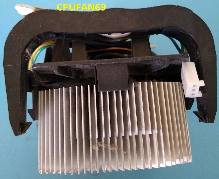

Anybody know where I might get the top clip portion of a socket 478 assembly? I have an old board with the bottom mount attached to the board, no fan mount to clip into it. This U-shaped device with the hooks on the end.
https://www.a1used-computers.com/_dynamique/c … c6fab48b1b8.jpg

Ah yes... I hate those things, 🤣 BUT alas, we're doomed to use them. I had three of these boys laying around with broken brackets. You inspired me to FINALLY fix that problem.
I present: S478 Universal Brackets!
The attachment S478_UNIVERSAL.png is no longer available
The attachment S478_UNIVERSAL.zip is no longer available
They fit all the Intel coolers as well as a few OEM dell towers that uses those green clips in the slots (ugly). I ended up with two, the first one, fits fine, but is as unmovable as the original. I slimmed it down a bit in revision two. I left both as options, since I kinda like the chonk.
The attachment 20260528_192642.jpg is no longer available
The attachment 20260528_192057.jpg is no longer available
You'll need 6-32 NUTS
And 6-32x.75 or 1 SCREWS/BOLTS.
I only have the heckin' long guys at the moment. 1" seems good, leaves room for a jam-nut on top. Adding that is a nice touch.

I only have the one cooler and board available at the moment, but I remember they all had the same Foxconn bracket, same P/N., so this should be the UNIVERSAL solution!
Nice work!
I would suspect though, that one needs to observe the tightening torque cautiously not to overtighten one side?
