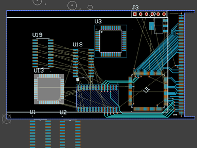

I will focus some energy now on getting a v1 PCB of this

re: pcb1 - Yes I am working on the DSP, OPL & MPU-401 + DREAM.FR midi chip, and Gameport. What I have yet to determine is how to mix the audio outputs together and if I should be trying to implement a software controllable mixer or not (i mean mixer hardware that can be controlled from software)
re: compatibility modes on ibm - that parameter may in fact be controlling the logic for when and how much to move into the fifo. I will have to investigate more and see what I can learn
re: DMA emulation / protected mode - I am not doing anything fancy at all I will try to write it down into a short format that makes sense, and does not blow up this thread with a wall of text. The entire project is possible as I do not need to intercept any i/o requests which seems to be the issue/impossibility with games that use dos extenders and enter protected mode, at least so I understand from the issues/limitations with SoftMPU.

I am still poking away at this when I can find time. I have played with the IBM 3D Sound a bit, I much prefer the sound out of an actual yamaha chip and the dreamfr midi chip, even the vlsi i prefer over the ibm 3d sound.
some additional learning curve for me, as I ended up moving from the simple gal's to one bigger cpld, for no other reason that I already have some I am using the same one on the snark barker mca.
it will all fit, but it is certainly tricky. I have some flexibility on pin assignments so I am hoping to do this with a two-layer board, mainly because of prototyping cost and leadtime, this one is going to take a few revisions no doubt.
www.yyzkevin.com

I would love some help. The recently lack of progress was not a technical issue but a time issue as I had some personal stuff but I am hoping to get back to this soon. I've had some decent proofs of concept working so this is totally possible just needs some effort to clean it up and finish it off.
Where I left off was moving to a bigger CPLD from the smaller GALs I was using as I wanted some additional hardware registers for dealing with some of the configurable options.
I use Altium CircuitStudio as it is just what I know.
Analog circuits I had no idea what I was going to do yet as there are a few sound sources and I was not sure how we would mix them together, I know there are ways I was just breaking the individual lines out to a powered speaker for my testing.

I like the CPLD idea. My original plan was to use a SAMD51 120MHz microprocessor, but there are none available for the next few months at least due to the chip shortage. I preordered some back in May and time estimates range from November of this year to August of next year, so who knows.
I'm used to Eagle, but since Autodesk merged it with Fusion 360 it's so bloated and cluttered. CircuitStudio has been appealing to me for a while so maybe I'll start to get acquainted.
Currently reading through this entire thread to get a good idea of whats been going on. Analog mixing will be easy though.
