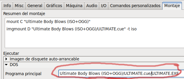

Reply 1424 of 2197, by pantercat
Hi, I think I found a bug. If I right click on any game in the list and select "open folder", it seems that DBGL tries to open the parent directory of the executable and not the root directory. This could trigger some weird actions. Here are a couple of examples:
The default editor opens with the contents of "dosroot/Ultimate Body Blows (ISO+OGG)/ULTIMATE.cue"
DBGL tries to open "dosroot/Syndicate Plus (CD-ROM, Castellano)/Syndicate Plus.iso/SB16" that doesn't exist, so nothing happens.
I'm using DBGL v0.90 && Debian Testing.
Thank you very much and keep up the good work 😀
Should be fixed in my latest DBGL build.
