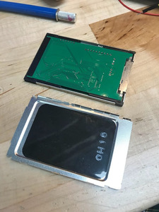

Reply 163 of 282, by yyzkevin
I am putting some time this weekend into finishing this off to order PCBs for this week. To make this possible I need to simplify the design. Not that it is impossible to have everything all at once, it just really challenges my beginner layout skills and absolutely pushes it up to a 4layer pcb which I would like to avoid if possible for cost and lead time reasons given that I know I will need a few iterations, and would like to keep some momentum.
So, I am going to drop the HardMPU implementation as this adds quite a few chips. Instead, I will just drive the VLSI 1053 midi chip from the SoundBlaster DSP's midi output, as well as provide external access to the same midi in/out. This is going to be fine for most games right? What situation is not having an MPU-401 and only having SoundBlaster midi going to be an issue, just some of the older sierra games that needed intelligent mode?

Reply 167 of 282, by yyzkevin
In the future I think it would be cool to use a YMF715 or other highly integrated chip, I was reminded of this chip by @yottatsa on twitter. For this initial version I use the 8501 based SoundBlaster DSP because thanks to @TubeTimeUS Snark Barker project I have the assembly source code and was able to make some very small changes to facilitate my DMA emulation working smoother. Now that I am using a bigger cpld vs the smaller GALs and have more registers available I think I can improve the logical design to not need those dsp modifications for autoinit mode "alignment" which paves the way for the single chip sound systems as an option. That is something I can play with in parallel without hardware design change.
Gameport is going to depend on the authenticity/functionality of these 555 and 558 chips I have ordered from china, i ordered them some time ago I expect them any day now.
www.yyzkevin.com

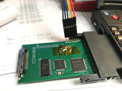

Reply 168 of 282, by yyzkevin
i've moved this project forward a little bit more. pcb fits into the frame nicely. This only has the SoundBlaster DSP as that is the complicated part and I did not want to waste time routing the other stuff, I know they work (gameport,OPL,MPU) and will put it on after, I have already done rough layouts to make sure I could physically fit it all.
This is now using the bigger cpld that allowed me to implement proper configuration registers on the board to control i/o ranges, midi sources etc.
It is starting to look like I have enough resources left on the CPLD that I can include the MPU-401 after all. As I learned how poor the midi interface is on this DSP it started to seem important to include.

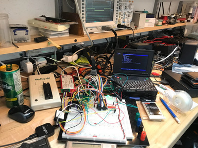

Reply 176 of 282, by yyzkevin
MPU-401 Example:
https://www.youtube.com/watch?v=xRbkijJc5F8
This is an example using LSL, which I believe requires intellegent mode?
https://www.youtube.com/watch?v=SX59Uvb-qk4
because it is easy to get and easy for me to hand solder, I am using the VLSI midi chip in conjunction with the MPU.
Yeah, it was quite a hassle sending/receiving raw frames with the esp8266, and I had some issues with certain frame types getting rewritten by wifi, I plan to come back to this as my real interest is with networking cards this soundcard thing is a road I accidentally went down. I learned a lot moving to the bigger cpld and using verilog, so I will apply some of this to improving the wifi ne2000 (also serial modem mode)
btw $140 for an IBM 3D Sound card is a steal at recent prices. I had to pay many times that to get to use as a control for testing games as I want to meet or exceed that cards compatibility.

Reply 177 of 282, by yyzkevin
In more of my compatibility testing I loaded up FastTracker2 (In-house Triton DOS Extender), and initially I had some issues. I have mostly sort them out and can get full quality playback even on the pc110 486 33sx, but I was wondering about the complications, so I tried it on the IBM 3D Sound and I was unable to get it to make a single peep. So I am wondering have you ever tried or been able to get FastTracker2 to playback on the IBM card?
I suspect some of these issues will not be unique when running into other extenders outside of typical dos/4gw etc , that may be doing things a bit different with how they are rewritting the vector table or making their realmode stub isrs and all that jazz.
I plan to send off for a rev2 pcb this weekend, adding in the gameport now that I have the 558 chips, the atmega for the mpu-401 and the OPL, but still no DAC's for now I will continue to connect off externally for that until I decide how best to handle the analog.
