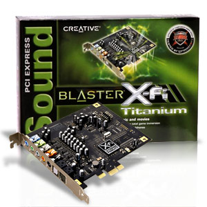

Some SB0880 models have a shroud covering the card while some don't have it. Which is the "good one"?
This is a picture from Ebay; the seller has many SB0880 for sale; does this model has 16mb of RAM or only 2mb?
The price is OK - especially shipping which is free!!
I am obviously looking for a PCI-EX card.

nd22 wrote on 2024-12-15, 10:20:
The ones with the shroud (it's an electromagnetic shield) are the Fatal1ty versions, and they have 64MB X-RAM. Those were Creative's top of the line products back in the day.
The model in that picture has 16MB X-RAM.
The "shroud" is a shielding that prevents some electromagnetic interference. It seems like the shielding was removed to expose card's PCB for the pictures.
SB0880 = 16 MB X-RAM. Still not a 64 MB model, but better than cards with 2 MB.

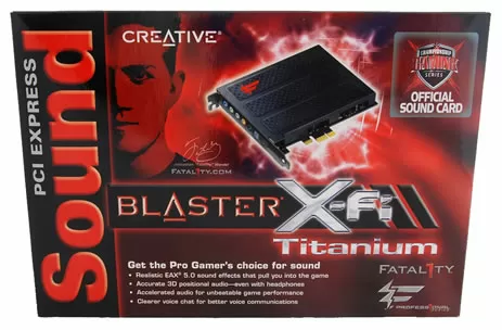

analog_programmer wrote on 2024-12-15, 10:41:
From what I recall, only the Fatal1ty branded X-Fi Titanium cards had the EM shield. The regular and OEM X-Fi Titanium models came without it from the factory. Relevant pics:
X-Fi Titanium Fatal1ty
Regular X-Fi Titanium

Reply 193 of 1250, by analog_programmer
Joseph_Joestar wrote on 2024-12-15, 10:55:
On a second thought, you're right. I just saw on fleabay those chineese offers and there was a picture of a X-Fi shielded card in buyer's feedback. This fooled me that SB0880 model comes with shielding.

analog_programmer wrote on 2024-12-15, 11:54:
I just bought this SB0880 and it has the shield: https://www.ebay.com.au/itm/326364839182
Reply 196 of 1250, by Joseph_Joestar
badmojo wrote on 2024-12-15, 12:04:
That's a Fatal1ty model.
Notice the red "F" on the EM shield and the SB0886 in the long serial number (below the model number) on the white sticker at the back of the card.
