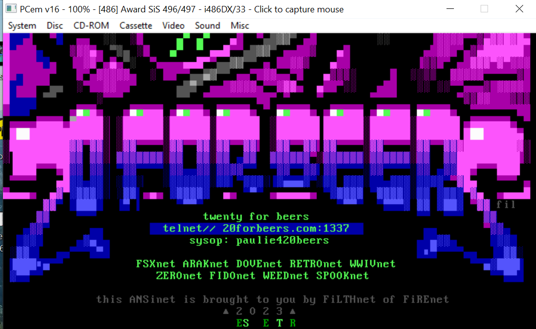

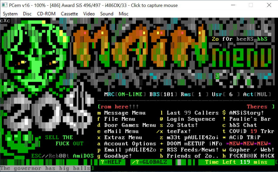

Reply 22 of 29, by Norton Commander
I tested with PCEM V16/MS-DOS 6.22/Mtcp telnet. The same BBS that produced garbled graphics in Telix 1.15d for Windows/Procomm Plus for Windows 3 worked perfectly. This BBS has all kinds of ANSI graphics and animations.
At least this rules out that PCEM was causing the problem. Windows for Workgroups TCP stack? I have yet to log on to a telnet server that lets me select which code page I'm using, most auto detect terminal type by having you press a key on the keyboard.
But please, anyone else that wants to do some of their own testing feel free to contribute.
