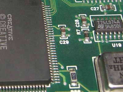

I took a closer look with the help of my 10 year old digital camera too see if I could find any defects, I started at the EMU8000 chip and... I diddnt get far until I found something that looks odd.
Look at the pin going from the EMU8000 chip to the lower leg of cap C29, it looks like its shorted with the pin below.
The attachment This_looks_odd1.jpg is no longer available
Here is a picture with the flash reflecting on the pins which makes it look like its shorted with both pins below, I think its only shorted to one though. The question is how has this happend if this is the defect muting the EMU8000? These pins are hard to scratch as the chips protects them, if there is some other defect or short circuit on the card thats the cause this could just be an effect from heat build up making the solder melt.
The attachment This_looks_odd2.jpg is no longer available

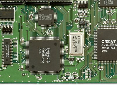

I could not find a good enough reference image showing the EMU8000 on the CT3900 but I stole this pic from member FGB showing the EMU8000 on his CT1920 AWE32 upgrade card. The area looks similar but not the same with the C15 cap responding to the C29 cap on the CT3900.

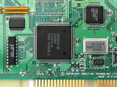

I also found this picture on Wikipedia showing what I think is a CT3990. Here there are even more differences but the C22 seem to be the same as C29 on the CT3900. The pin from the EMU8000 going to the lower pin of the C29/C15/C22 cap should clearly not be shorted with the one below.

Reply 32 of 40, by Skyscraper
Short circuit fixed and now the sound output from the EMU8000 and OPL3 is working!
The card suddenly only detects 24MB of the 32(28)MB sound font memory, perhaps I need to reseat the memory or perhaps two memory chips have died but even if I have managed to kill some memory chips while fixing the short circuit this is a minor problem compared to the EMU8000 and OPL3 synths beeing mute! 😀

Great outcome 😀
YouTube, Facebook, Website
Reply 34 of 40, by boxpressed
Great catch! What a strange thing the problem turned out to be. Enjoy your CT3900. It's one of my favorite pieces in my collection.

Reply 37 of 40, by JayCeeBee64
Rank Retired
Retired
Good job Skyscraper! Great to see you stuck with it until the issue was resolved 😀
Looking at the pics you posted, it appears the solder pads got scratched/scraped by something small (most likely a jumper block/pin or capacitor). It's not uncommon to see this kind of damage on long expansion cards like the AWE32 (Voodoo 2 cards are another example).
