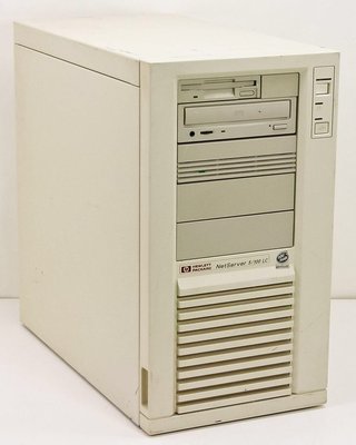

Errius wrote:
This looks like a workstation version of the Netserver LC3, though the LC3 lacks an AGP port. (The Netserver E60 has an AGP port, but lacks VRM slots.)
Kind of, these where in service at the same time as the Netserver LC.
They are both loud computers that run NT4.0
