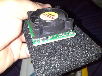

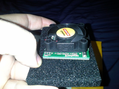

Kingston and a couple of other companies also used this CPU board ..without a heatsink but with a fan (!). I have 3 all different manufacturers.
