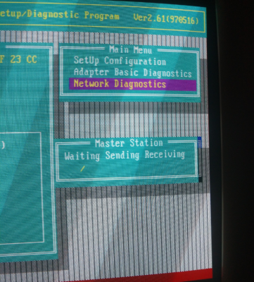

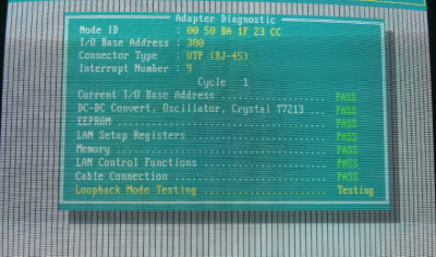

Does that program actually run diagnostics? If so, what were the results?
Reply 21 of 29, by Old PC Hunter
Yes, the program does run diagnostics. On the adapter diagnostics, everything passed, including the loopback test. That test took a while to complete but it did complete. The network diagnostics test does not appear to be doing anything.

Diagnostics passing is good, but be careful with how you interpret the loopback test. If it's not actually putting bits on the wire and then reading them back, then it's not going to catch problems with the physical layer. Put another way, depending on the implementation it might not be a full loopback test.
(I still think your card is not sending packets; you need another machine directly connected to it to verify that though.)
Reply 23 of 29, by Old PC Hunter
Should I try using Wireshark or a similar tool to see if packets are actually sent?
