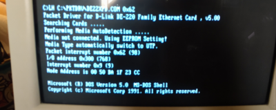

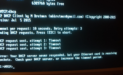

Hi all, today i've decided to work on my 286's network functionalities today. A while back I installed a new old stock DE-220PCT network adapter for it. Today i've gotten around to getting this computer working on FTP using mTCP, but I just can't get anything to work right. I installed the packet driver at interrupt 0x62 and mTCP is able to find it. In the setup program, i've configured the network card to work at i/o base address 300H and IRQ 9. I have plug and play mode off and full duplex on. Before, I had it on IRQ 10 and full duplex off and it still did not work. I've set up everything correctly in the config I think, and I added my computer's mac address and gave it a static IP in the DHCP config. I have the config file set up with all of these parameters. When I run any program for mTCP, it says my DHCP lease has expired. But when I run DHCP, everything times out. At the end, it says my card is recieving packets but the DHCP server is not responding. I have this computer hooked up to a 5-port 10/100 Ethernet switch from Tenda. I've been working on this issue for quite a while and have always burned out on fixing it. I assume the answer to this problem is really easy, but I can't seem to figure it out. Any help will be appreciated.

Reply 1 of 29, by onre
In my experience mTCP DHCP client code is rather resilient and works with all kinds of DHCP servers. I'd connect another computer to the switch and run Wireshark on it to see whether the DHCP packets sent by mTCP actually appear on the wire. If you can't see them and the card has more than one cabling option, one thing to consider here is media detection. I have an SMC card which only works with media auto-detection - if I choose twisted pair, which is what I have connected, it won't send anything. No idea why it's like that.

Reply 5 of 29, by onre
Now that I re-read the screen capture, it says that the card is actually receiving packets. What happens if you just configure a static IP? Pick some unused address from the DHCP pool, set same netmask as on your modern machine and see if you can ping it then.

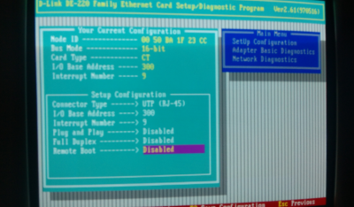

Reply 7 of 29, by Grzyb
I've never experienced problems with mTCP itself.
All the problems I saw were caused by bad hardware, configuration, or drivers.
What packet driver you're using?
For many cards, there are two drivers: one provided by the manufacturer, and the other from Crynwr.
And you can try ODI and NDIS drivers, with appropriate shims.
Also, you should disable full-duplex - it needs either NWay (which your card is unlikely to support), or a managed switch with the port manually set to full-duplex (and I don't think your switch is managed).

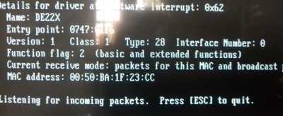

Reply 8 of 29, by konc
long shot, but are you sure the packet driver loads successfully/correctly? can you show us a screen of it loading? I hope you're not getting FF:FF:FF... as a mac address.

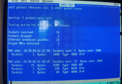

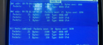

Reply 12 of 29, by Old PC Hunter
I am working on mTCP again now, and I used PKTTOOL to see the incoming packets, and I got this. I also have a screen of the packet driver initalizing. When it was initializing, I had no media connected, but I fixed this later. I also hooked the computer up to an Ethernet cable not going into the switch and nothing different happened. I also have all of the static IP parameters in the config file set correctly I think. The only driver software I am running for this network card is the packet driver on the original D-Link setup disk. I had other drivers on the card before, but they didn't help my situation with mTCP as it only uses the packet driver.

Reply 13 of 29, by mbbrutman
That's pretty good news - you are receiving packets and PKTTOOL can figure out that they are ARP, IPv4, and IPv6 packets, so the packets are not totally borked.

Reply 17 of 29, by mbbrutman
I took a look at the configuration file and the traces. Your machine is sending ARP requests that are never being answered. Incoming packets look fine, but I'm betting that your card (or a bad cable) are preventing sent packets from getting off the machine.
This is completely consistent with DHCP ignoring you. You are not being ignored - the packets are probably not getting out.
To prove this you'll need to run wireshark, TCP dump, or something like those. I'd just swap with a different card and see if that works better. (If you can find a different, compatible packet driver that would be something to test as well.)

Reply 19 of 29, by Old PC Hunter
Tested the packet driver from the D-Link site. Nothing. Here's all of my configuration settings:
