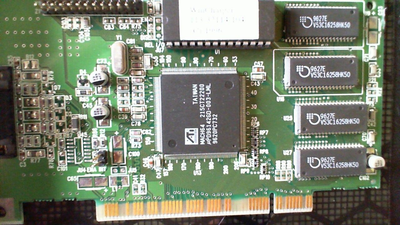

Exactly which chip is it please? I suspect it's not the one I have.
file.php?id=161125
That's CT, while ISA cards use the GX variant.

Does the CT support ISA? A number of graphics chips from this era supported older interfaces, no examples were produced.

mach64 GX 210888GX00
https://www.vgamuseum.info/index.php/cpu/item … 7-ati-mach64-gx
PCI cards are still in $10-20 range

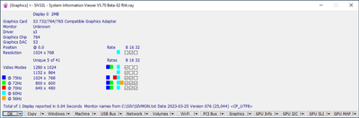

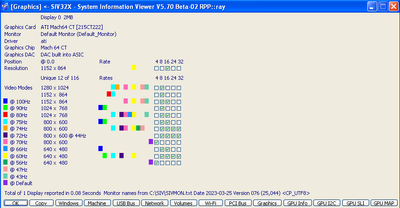

It seems that not all 2MB GPUs are equal, below you can see my ISA S3 Trio64 does not support 1152 x 864 x 16-bit colour, but my PCI ATI Mach64 does.
Do you know of an ISA CPU that supports 1152 x 864 x 16-bit colour on Windows NT 4.00 please?
