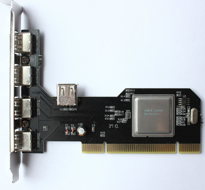

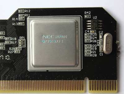

Recently I got a card with a NEC D72010XF1 chip. It looks cool with that IHS. The board is from October 2010 so it's a "very new" old card.
I didn't find any datasheet about this particular "XF1" chip but I guess it's part of the D72010(1) family. Perhaps the latest iteration? I still haven't tried it.

Off the top of my head, I think the latest non-laptop chips were the small square BGA ones. Often there will be a gigantic square silkscreen around it, indicating that the PCB was originally designed for the larger node with a larger package.
I think this is the result of a die shrink and refinements with the use of a revised PCB.
Another great comparison is the ESS Maestro-1 vs Maestro-2.

Oh that’s very interesting.
Look forward to results of speed tests on old systems

I plan to test this card and a VIA and ALi soon, on a socket 7 system and on a powerful socket 370 system and see what happens... both on Win98 and on Linux. I don't expect huge differences but we'll see. I'll do it and post the results when I get around to it, it's coming down the pike.
