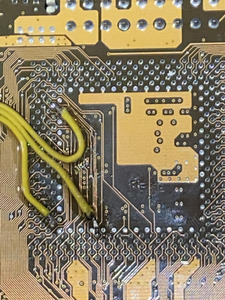

Reply 204 of 240, by CalamityLime
After a bit more experimenting I got the machine to crash when accessing the floppy drive in dos prompt and using the mouse.
It also crashes in safe mode.
I'm now thinking that i have a hardware problem where at least irq 3,4,6 are getting shorted somewhere.
Does anyone have any clue where to short looking?
I did decide to reflow the PCI chipset and that very quickly turned into a rescue but i think thats fine now, the legs in the PCI chip set are really really soft.

Reply 206 of 240, by CalamityLime
I got it
It was hardware, Oh boy was it hardware!
So a quick overview of what happened. I remembered that IRQ lines are run to the isa slots which was handy, I was hoping for a short across the pins but nope, they were fine. I did note that they went to a resistor array pulling the irq lines up to 5v via a 6.5k resistor. I also noted that the 8bit irq's were grouped separately to the 16bit irq's. My issues were in the 8bit irqs, 3, 4 and 6. So following them it brought me to the multiio chip at the edge of the board. I probed out the IRQ lines and the 8 bit IRQ's went to that chip just fine. Knowing that there's no way that the IRQ's go to that chip and stop there I checked the datasheet for a out line. The Lines that sounded promising didn't really lead me anywhere, so I followed out the IRQ lines.
Each IRQ of the chip went somewhere I could follow except IRQ_b as it was called. I traced it to the Parallel and IDE connector which didn't make any sense.
Eventually I figured out that IRQ_b was grounded and it looked like it went to the chipset.
I reflowed around the multi-io chip and no change, it stayed grounded. I saw nothing obvious and with the trace going in and around the ram slots I couldn't follow it, with it grounded I couldn't trace randomly hoping for the best.
Then I remembered something I had said already.
CalamityLime wrote on 2022-05-31, 17:38:
Just as well I went poking around the board. […]
I spotted a flake of solder under the chipset, I didn't rework that part of the board except to remove one cap that was in the way of a trace I thought was tio10 for a bit.
I have noticed that the board is missing two caps that I did not remove. So this board got some re-work before me. The two caps are part of the voltage regulation circuits.
Not sure what this really means for the board yet but I should replace those before powering it at least. The board uses only 2 values of caps so it's easy to guess the values of the missing caps.
-Lime
Well, I tapped the chipset with the ass of my screwdriver and the short went away.😶
So I sprayed some compressed air under the chipset and some contact cleaner, followed by more compressed air.
It works now but it doesn't like to be touched, I think I might need to clean the ram contacts.
-Lime

Reply 207 of 240, by Sphere478
Some of my boards have a handy hole in the board under the chips handy for blowing air into.
Glad you are on the right track. Lucky find. Good sleuthing.
Sphere's PCB projects.

Reply 210 of 240, by CalamityLime
Sphere478 wrote on 2022-07-07, 06:28:
Sounds like another blob under there. Can you get it out?
I think you misunderstood. I wasn't saying that I was having the issue again or something, I was commenting on my experience in the first place.
I hope everything is out now.
I also polished the contacts of the ram with some metal polish, lots of dirt came off of the sticks.
Be Happy, it's only going to get worse.
- Projects
Limes Strange 3D models
USB-2-232
Reply 211 of 240, by CalamityLime
​Thinking about it, did i use percussive maintainance to solve an IRQ conflict?
- Projects
USB-2-232

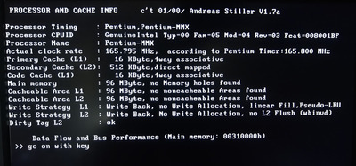

Reply 212 of 240, by CalamityLime
majestyk wrote on 2022-06-30, 22:34:
"Cachechk" and other tools won´t tell you the cacheable RAM size for L1 and L2. You need "ctcm7" for that. But as long as you ha […]
"Cachechk" and other tools won´t tell you the cacheable RAM size for L1 and L2. You need "ctcm7" for that. But as long as you have only 64 MB RAM populated it will just tell you the cacheable size is 64MB.
You´ll have to go for more RAM!
In case you don´t have it - here you go:
ctcm17a.zip
My extra ram arrived today
- Projects
USB-2-232
Reply 213 of 240, by majestyk
Bingo!
... and congratulations.

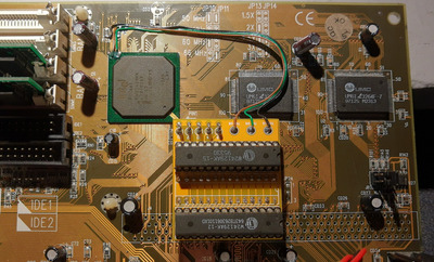

Reply 215 of 240, by CalamityLime
I cleaned up my wiring a bit.
We'll have to make a thread for this 👍
EDIT: I also changed the underlaying socket since it was a bit iffy and I didn't trust it.

Reply 217 of 240, by CalamityLime
Sphere478 wrote on 2022-07-13, 00:56:
https://www.vogons.org/thumbs/45320_5b34962f9581f4c35512297b51dd884b/E42C21DB-94C4-4362-A0F5-7788F7943521.jpeg […]
you can use runny superglue to bond those wires down like traces and rout them from below
This time around I did use a bit of super glue to "tack" the wires down to the board as well as each other. On top of the wires on the chip is some curable solder mask. Hopefully that will help the mod survive a snag.
About wiring the wires underneath the board, the contacts are not available on the underside of the board. I would expect most boards that would benefit from this mod would not have the contacts available either since if the board has only 1 tag ram chip, two out of the three connections we need are not routed away from the chip.
I did test the s-ram chip I bought from mouser and it didn't work for me. I was guessing that it would work but it didn't work, maybe two of them would but I couldn't tell you.
My muRata modules did arrive so I was very happy about that, very small things.
-Lime
- Projects
USB-2-232

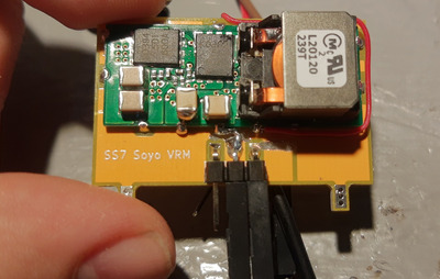

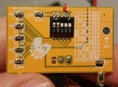

Reply 219 of 240, by CalamityLime
Hey there!
So I got the muRata modules, pcb and bits of LCSC that arrived really damn quick.
Installing the murata module resulted in it looking as good as I hoped it would and it seemed my hastily made reference model was about right. Unfortunately I got the pinout wrong on the foot print, I swapped the vout and the trim pads.
I had to desolder the muRata module and in the process I ripped 4 pads off of it, thankfully none were important! I altered the PCB to route a bodge wire for the vout to the correct pin and a thing bodge wire to the dip switch.
I'm also using different values for the resistors giving me very granular control of the output voltage but it does mean that the dip switch table on the PCB is wrong. So it needs updating but it's fine for me.
Now on to the installation!
