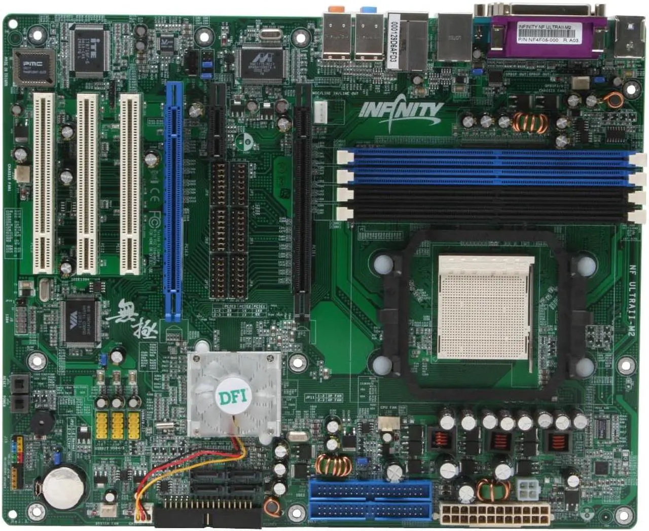

Reply 289 of 298, by Living
i hated Brisbane at first, was supper buggy with first gen AM2 boards. Didnt help that i had this motherf...as a motherboard for about 2 years paired the first year with a Brisbane 4800+ (even the memory of the bios is too small, so no microcode for Phenom 1, this one tops at 6000+)
it wasnt until i sold the 4800+ and upgraded by accident to a 5600+ Windsor that all the instability and boot problems were solved.
was my last DFI, shortly after they stopped producing motherboards.
I wonder why...
