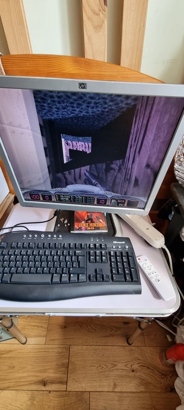

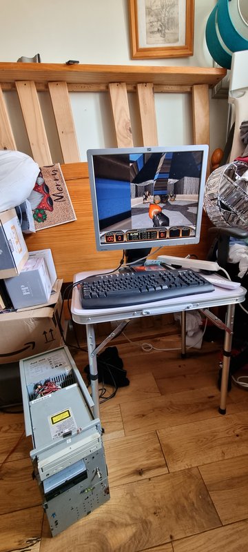

Reply 44 of 46, by Crinale0
dormcat wrote on 2024-08-20, 02:48:
Crinale0 wrote on 2024-08-19, 18:45:
Did all of that started it up and its completely dead. No POST, no beep codes, nothing. What is with this!? I'm so disappointed i am trying so hard to get into this hobby but the hardware just seems to die on me if i even so much as fart in the wrong direction.
Do you have an ATX power supply tester? If the PSU is AT then test with a multimeter.
For an old but working system it's better to use the combination of air can, soft brush, and vacuum cleaner while remain components seated. A single grain of sand could drop between contacts and acts as an insulator.
I have an AT power supply, all the voltages are checking out it's the first thing i checked. That said though, is there a way to get new AT PSU's or cable to convert it? As I'd rather use a new one.
PC is all up and running now, the sound blaster AWE64 sounds awesome! I have Duke3D running on it currently on the intro as a kind of stress test. My CRT arrives today so that will be nice as long as its not smashed in the mail like the other one i got.
Duke3D in 800x600 actually pushes that Rage 3D card haha!
