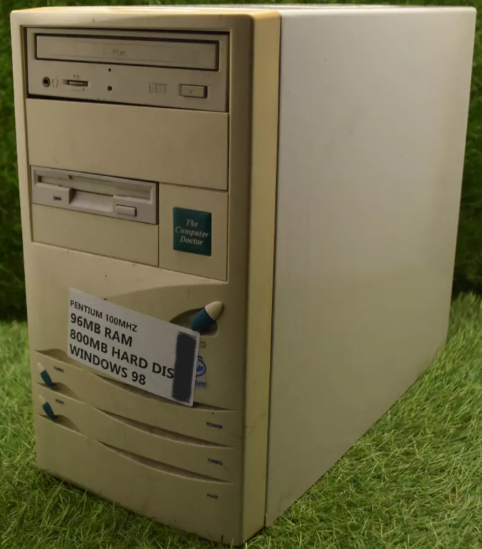

Thank you all for the feedback it's been extremely informative. I'm happy to report i found a full system for a fair price (unheard of in this country in recent times)
Pentium 100
96MB RAM (going to reduce this to 16MB or under)
800MB HDD (going to use a IDE to CF card adaptor with a spare 8GB CF card instead of this for ease of transfering files)
FDD
CD ROM
AT style motherboard
Some sort of VGA card
Best part of all, a TURBO button! 😁
I'm hoping it has ISA slots as there was no info on that but given the age and type of board i would assume it would have at least one right? I hope so!
Should suit all my needs. To answer the question above I am actually new to MS DOS gaming (apart from DOOM, Quake and Duke Nukem 3D which i had as a kid) so this machine will be used to explore all those games I missed out on. Hopefully this configuration with a AWE64 will be compatible with most games and i can experience the joys of DOS gaming.

Reply 12 of 46, by Grzyb
WarhammerDarkOmen wrote on 2024-08-14, 15:09:
Unlikely to work - Socket 5/7 boards don't have the pins to connect Turbo button.
I expect three or four.

Reply 13 of 46, by Shponglefan
Grzyb wrote on 2024-08-14, 16:52:
Some of them do. I have a Pentium 133 system with a Gigabyte GA-586ATE/P motherboard (Socket 7) that has a functioning turbo button header.
Most do not though.

Reply 14 of 46, by Shponglefan
Thank you all for the feedback it's been extremely informative. I'm happy to report i found a full system for a fair price (unhe […]
Pentium 100
FDD
CD ROM
Most motherboards of that era should have at least 3 or possibly 4 ISA slots. So you should be good to go. 😀
