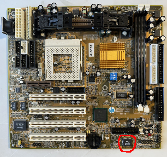

Alright, I'll see what I can figure out. The seller says that it's just a splash screen and I should still be able to get into the BIOS, but I'm not seeing the keyboard getting power/initializing like it does on my 486. Even though it's a PS2 keyboard with a PS/AT converter plug, on the 486 I see the lights flash on the KB almost as soon as I boot.
But you're right, I'm not sure I'm going to be able to find the original BIOS. I did dig around for the BIOS online and haven't found it yet, and looked at the AIRBUS stuff as away, which almost sounds like the current BIOS flashback setup, but the chance of me finding that is probably slim to none. I also contacted Azza to see if they had anything related to this board in their archives/systems somewhere, which of course, they don't.
There is a BIOS for the DTC version of the board on Retroweb, so maybe I can try that if I really can't find the DTA BIOS. Might bork up the onboard audio since they're different codecs, but even if it does, I wasn't planning on using it.

Yeah, mashing DEL doesn't really do anything. I don't think the KB is being recognized. There is a USB port, but the the header actually has all 10 pins and all the usb plates I have only have 9 with the 10th blanked out.
Also, maybe I don't have enough caffeine in me yet, but which chip is the BIOS? I don't see anything stamped with Award on it, and all the chip numbers I am seeing/digging into seem to be for other components like the COM ports/audio chip, etc. I may try that process to force the bootblock and load that 810DTC BIOS.

MeatballB wrote on 2024-10-05, 18:04:
It's likely the intel chip on the bottom right of the board (to the right of the battery holder).

Well...crap on a cracker...I drilled out the blocked hole on one of the USB adapters/header plugs I had and was able to get into the BIOS with a USB keyboard. The beep code is still hammering away like mad, but I'm in to.....this.
Likely the one I circled in red

Reply 50 of 183, by Shponglefan
stamasd wrote on 2024-10-05, 18:22:
Still doesn't seem to have a way to update the BIOS
One option would be to desolder the chip and replace it with a socket. Then at least the chip could be swapped / reflashed externally.

Reply 51 of 183, by stamasd
Shponglefan wrote on 2024-10-05, 18:25:
Which is what I've said several times in the thread, but it seems like the OP's comfort level is not there for that.

Reply 52 of 183, by stamasd
MeatballB wrote on 2024-10-05, 18:17:
Next step: see if you can configure a floppy drive in that BIOS, attach a FDD and try to boot from a DOS boot disk
Also: what are the markings on that chip I circled above? I can't distinguish in that pic (too low resolution)

Alright, we're cooking with gas now. That BIOS chip is stamped Intel N82802AB8 / A0230103 / '96'98
The attachment chip.jpg is no longer available
The BIOS is definitely wonked and it seems like a lot of stuff has been stripped out, but I was able to 'boot' to a floppy, sorta. What I thought was artifacts at the top of the screen is actually the screen, just shrunk down to a small size and duplicated across the top. You can see a bunch of mini Win98 Boot Disk images up top here.
The attachment minibios1.jpg is no longer available
I _might_ be able to boot into a floppy and put the commands in to flash the BIOS, even without seeing it. Before I try, if you all want me to try to save that BIOS, I can try, if someone can walk me through the process.
I'll also note, the beep code just continues to beep constantly, so I pulled the speaker for my sanity. 😀
