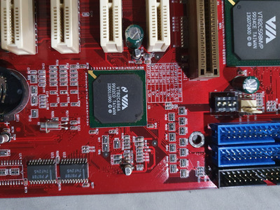

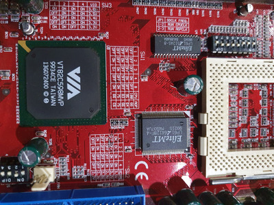

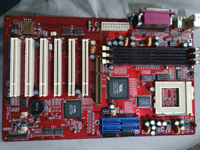

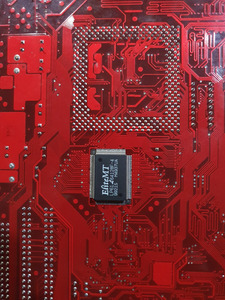

Here are some pics of the Ultra. Looks like it has a different Tag ram chip.

Oh you have a bga south bridge where as mine is a chip with legs…
I always suspected this was a major difference
I wonder if a interposer is possible to upgrade the legged footprint to a bga mount
I see different numbers on the north bridge also. But I do not know what they mean? Anyone?
I think the tag chip is basically the same but from a different mfg
The blue ide sockets probably are indicative of ata66 provided by the upgraded sb

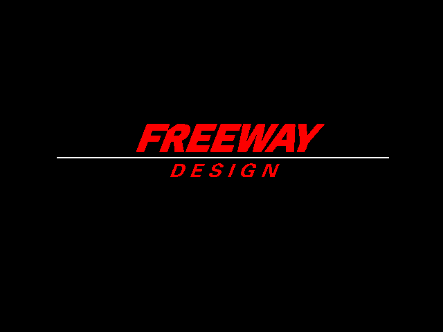

oh BTW, here is this 😁
this is pulled from the bios. if someone can figure out how to put it in the new bios that would be cool
Sphere's PCB projects.

Man, that is a nice BIOS splash screen! 😃
