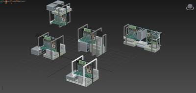

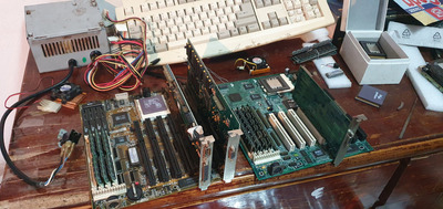

As unfortunately many years ago I threw away the old case I had, I can't put them together like that. I don't want to use a more modern case. but my real plan is to mount them on a kind of plank, guts out, as an exhibition. I have designed several ways to do it. even make it transportable. Before I only thought of including the 486 (with an am5x86) and the Pentium (MMX) but now I can include on the opposite side this Super Socket 7 and with a lot of luck the PII, so I will have 4 systems in a rolling "exhibition"
I leave some representative images of what I'm talking about.

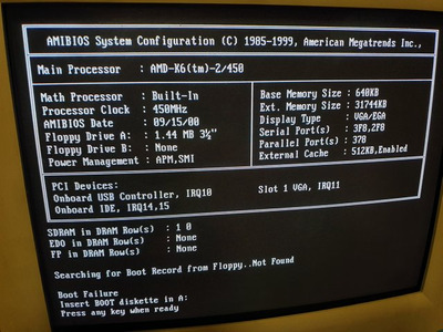

Reply 43 of 52, by kinetix
well, still stuck at "Checking NVRAM"
the battery is OK.
already tested with a different ram stick (128MB PC133). will have some more, all different, to test tomorrow . update: 2 more different ram sticks (32, 128), same result
and with a different CPU, a K6-2/450.
and different video card, just in case.
I will upgrade the BIOS and see what happens. it is a little hard to get the chip off the socket, hahahah
if nothing work , that could mean fight again with the capacitors

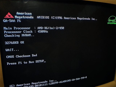

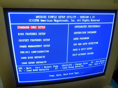

Reply 49 of 52, by kinetix
Success!
I reprogrammed the bios with the latest stable bios version, and it worked. Before it had version 1.3, now it has F6.
Before doing that I compared the original data from the eprom with the same version from the "theretroweb", and saw a section of empty data (spaces) with several small differences. But the "fat" data was identical.
Now I just need to do some stress and stability tests.
