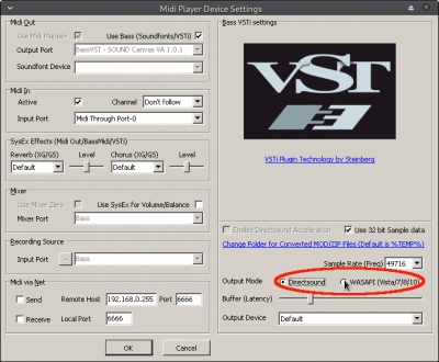

Can someone tell me how to use it in Linux with DOSBox? I downloaded and installed the trial version and followed this tutorial:
https://l9000.net/wiki/Sound_Canvas_VA_and_DO … Box_under_Linux
But it doesn't realy work, games in Dosbox don't produce any sound, music at all.
All the DOS games that I play are alredy set up correctly; every game set up to use General MIDI or Roland cards and they works fine.
They all works with MUNT or with any kind of software-synthesizer or with my Audigy 4's wavetable.
In the program, when I click on the "TEST" button, It gives sound, so it seems it's works. But it still never produce any sound in Dosbox.
I can't figure it out what and where I have to chnage to make it works. I tried changeing all the settings to a different one what the tutorial mention, but no luck.

Reply 584 of 866, by realnc
You don't need "loopmidi" (whatever that is). You just load SCVA in MIDI Player. Then configure Midi Player to use "MIDI Through Port-0":
If you run " aconnect -l" in a terminal, you should then see something like:
$ aconnect -l
client 0: 'System' [type=kernel]
0 'Timer '
1 'Announce '
client 14: 'Midi Through' [type=kernel]
0 'Midi Through Port-0'
Connecting To: 128:1
client 24: 'Virtual Raw MIDI 2-0' [type=kernel,card=2]
0 'VirMIDI 2-0 '
client 25: 'Virtual Raw MIDI 2-1' [type=kernel,card=2]
0 'VirMIDI 2-1 '
client 26: 'Virtual Raw MIDI 2-2' [type=kernel,card=2]
0 'VirMIDI 2-2 '
client 27: 'Virtual Raw MIDI 2-3' [type=kernel,card=2]
0 'VirMIDI 2-3 '
client 128: 'WINE midi driver' [type=user,pid=72670]
0 'WINE ALSA Output'
1 'WINE ALSA Input '
Connected From: 14:0
Just set DOSBox to use 14:0 and it should work:
[midi]
mpu401 = intelligent
mididevice = alsa
midiconfig = 14:0
Reply 585 of 866, by Rencer
Thanks, realnc.
That picture of your settings helped me to solve the problem!
At the BassMidi settings (Bass VSTi for you) the default output was "Directsound" and that is why I can't get sounds out from the MIDI player.
I changed it to WASAPI and now it works. Thank you.
