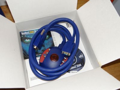

Hello all,

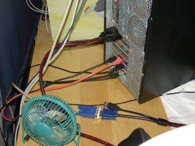

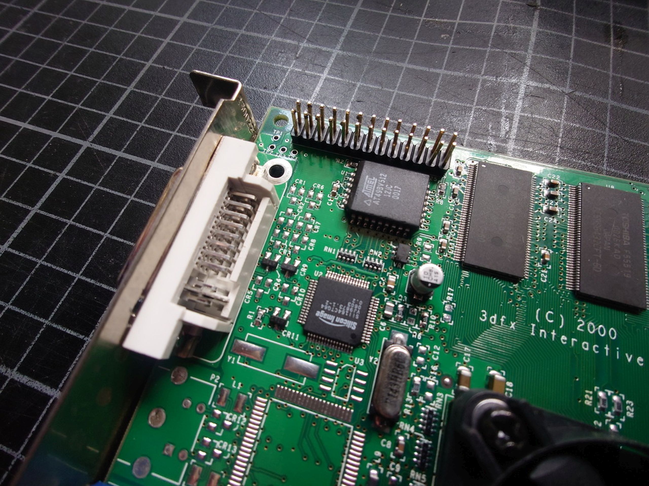

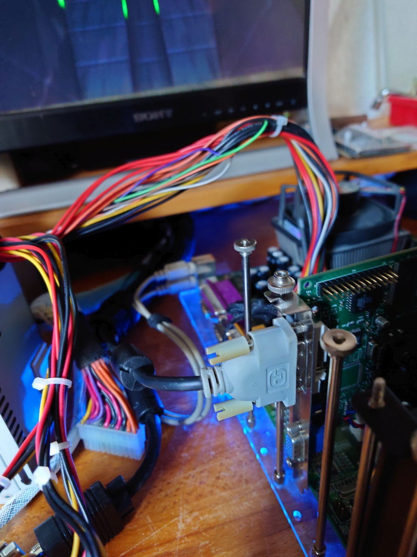

Well I have some good news for you 3dfx Voodoo3 3500 TV AGP 16MB users/owners, as that I did some useful research last night, it's that some time ago I bought a M1-DA to VGA convertor cable and thought to put this thing to use, the VGA connector is male so to solve that I used a VGA/SVGA DB15 D-SUB 15 Pin 3 Rows Female To Female Mini Gender Changer Adapter on it's male 15 pin D-Sub connector, that way I could connect the CRT to it and presto this worked!
The image quality is fine to around 1600x1200, I have 1024x768x32 and yea no issues at all, bottom line is that is much less strain on the 3dfx Voodoo3 3500 TV AGP's M1-DA connector, this is my goal so I wont have to use that horrible blue 3dfx IO Pod anymore 😎
So I bought this M1-DA to Male VGA Convertor cable on ebay in China for around 23 Euros incl shipping from China to Netherlands, it may not seem great, but it's much better than even I had expected, it fits very easily, no need to bend out the shielding of the 40+5 pinned M1-DA connector on the cable, it fits easily.
But hey it's a solution right! So with this you won't have to overpay yourselves for a Voodoo3 3500C + TV-Out Compaq board, so I thought to at least test this and see what it does and post it here as it does actually work!
Here the ebay seller I got mine from:
https://www.ebay.ie/itm/387155543843

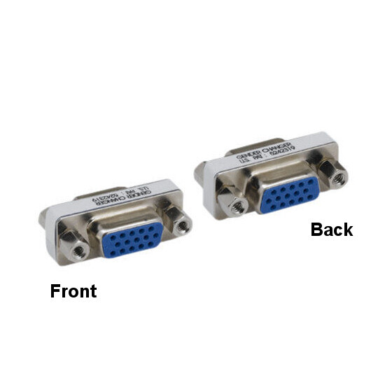

Just make sure you add a VGA/SVGA DB15 D-SUB 15 Pin 3 Rows Female To Female Mini Gender Changer Adapter between this and your monitor, aka one of these:
https://www.ebay.ie/itm/133567891402
With that you're good as gold, it's a fantastic solution for us Voodoo3500 TV AGP users alike
Also you don't need to use the extra USB connector that comes with it, just the heads up for those wondering.
Hereby saving everyone money in the end, here how I connected the M1-DA to VGA Convertor cable to the 3dfx Voodoo 3 3500 TV AGP 16MB Rev.A 3199 and the Compaq S710 17" Blackshade CRT
Here the insides of this beauty:
Here the M1-DA to VGA convertor cable:
And here the VGA/SVGA DB15 D-SUB 15 Pin 3 Rows Female To Female Mini Gender Changer Adapter which you do need to make it work:
All working as it should do and just letting other Voodoo 3 3500 TV AGP owners know that this methods works very well and can be seen as a low cost solution as well and with this ideal solution you won't have to use this horrid large and heavy blue 3dfx IO Pod anymore:
For every problem there is always a solution, that is the how we think at x-3dfx and if I find out something helpful I'd gladly share it.

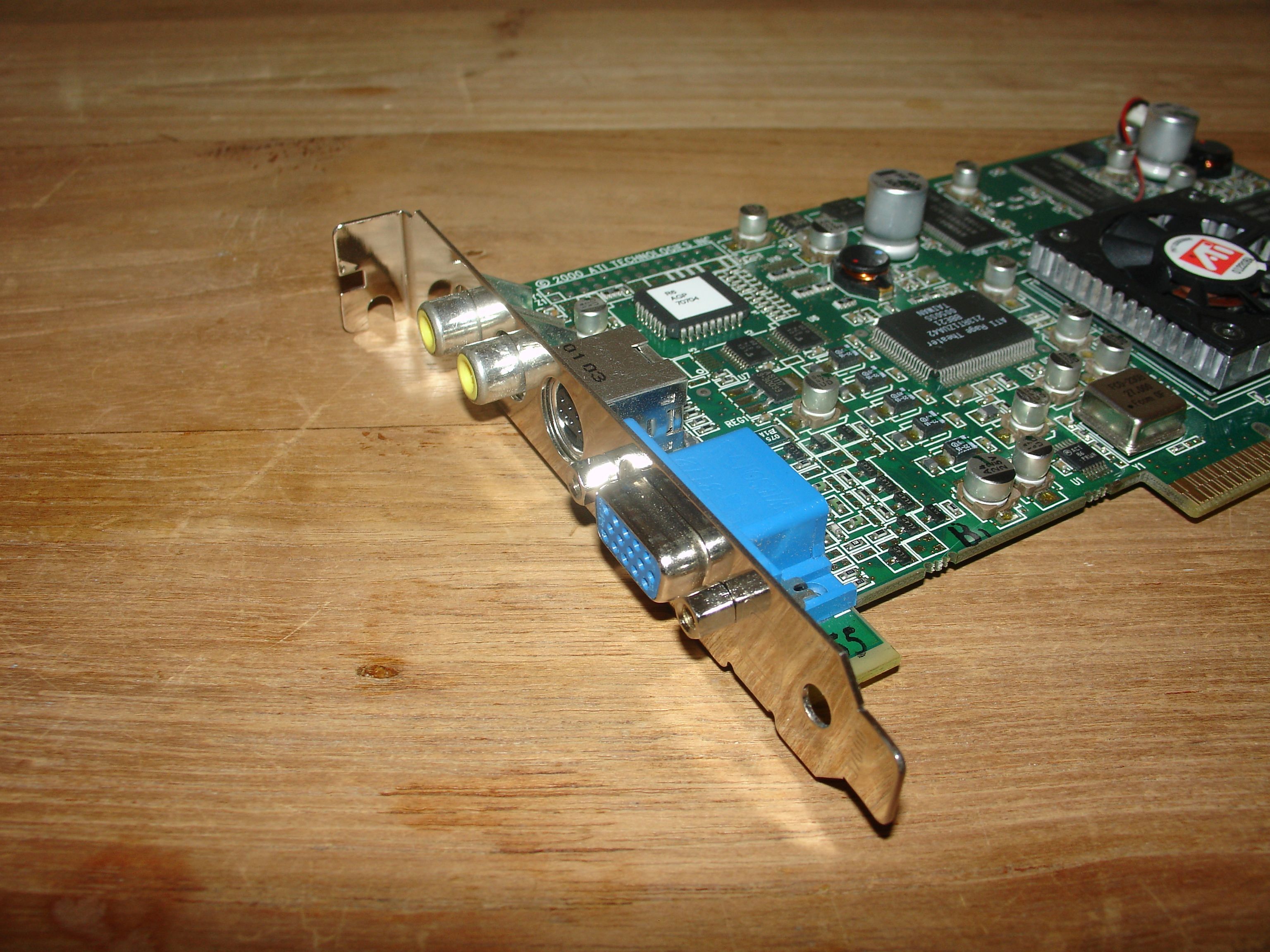

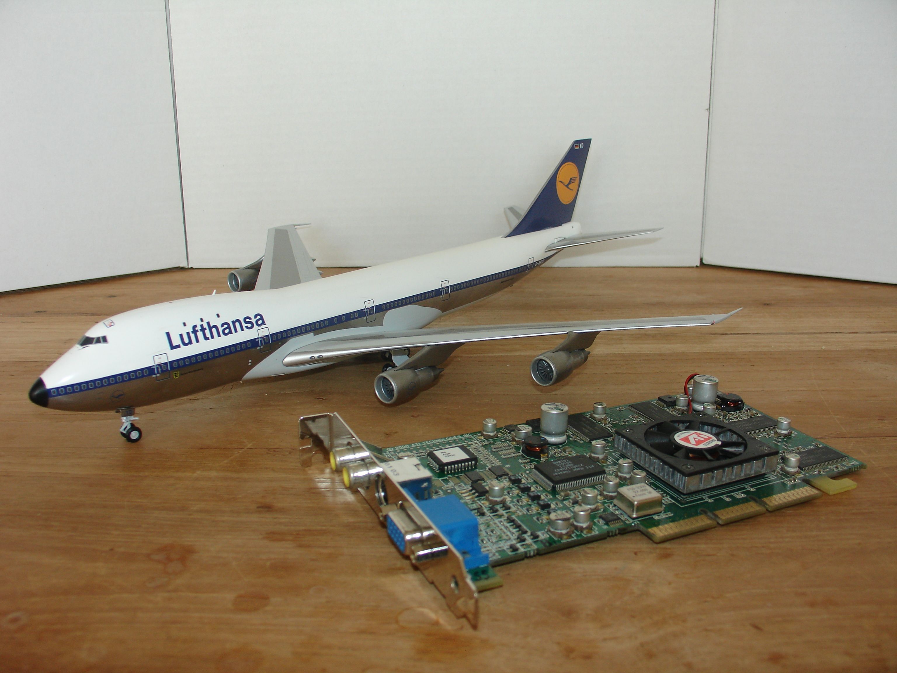

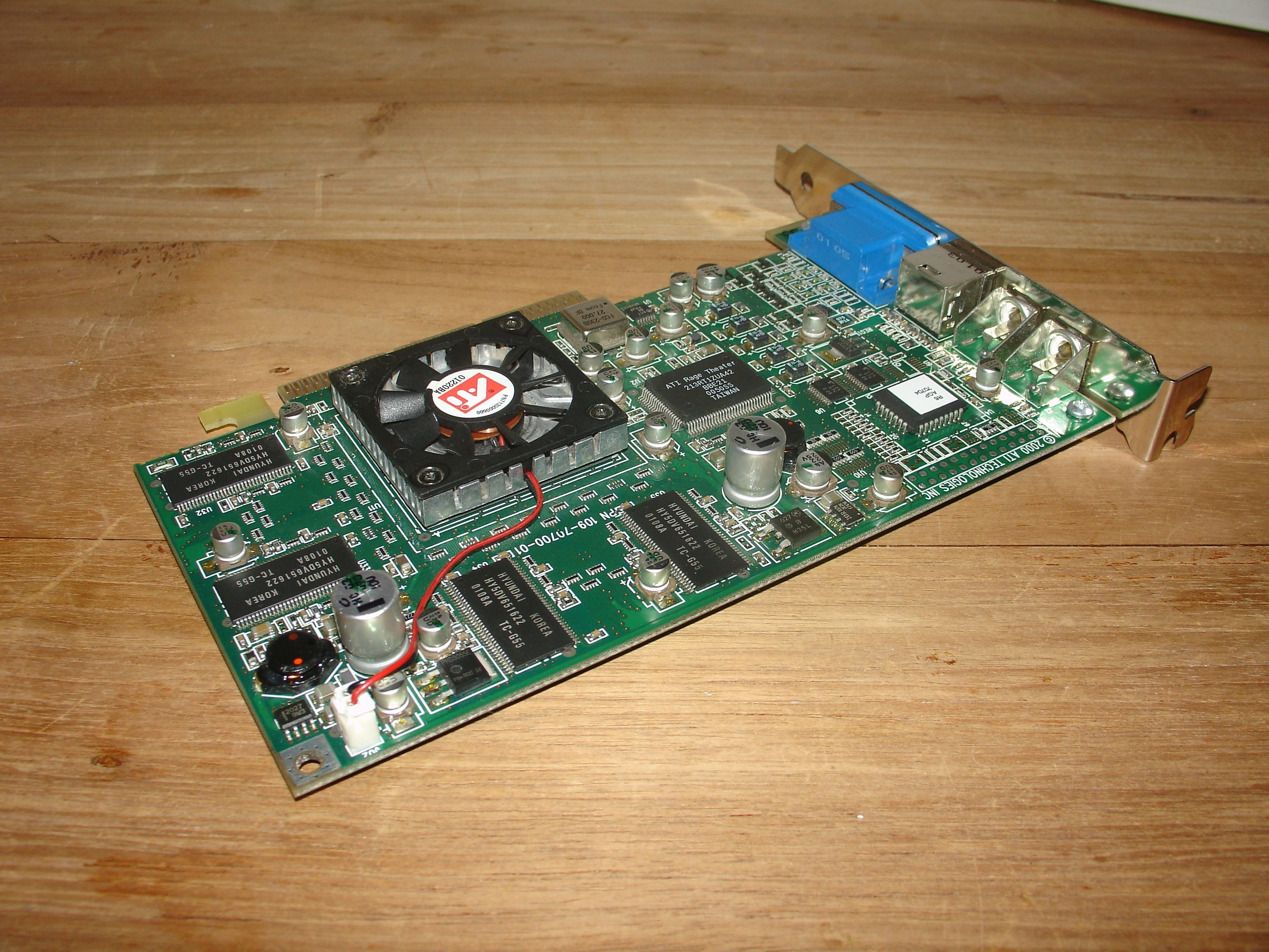

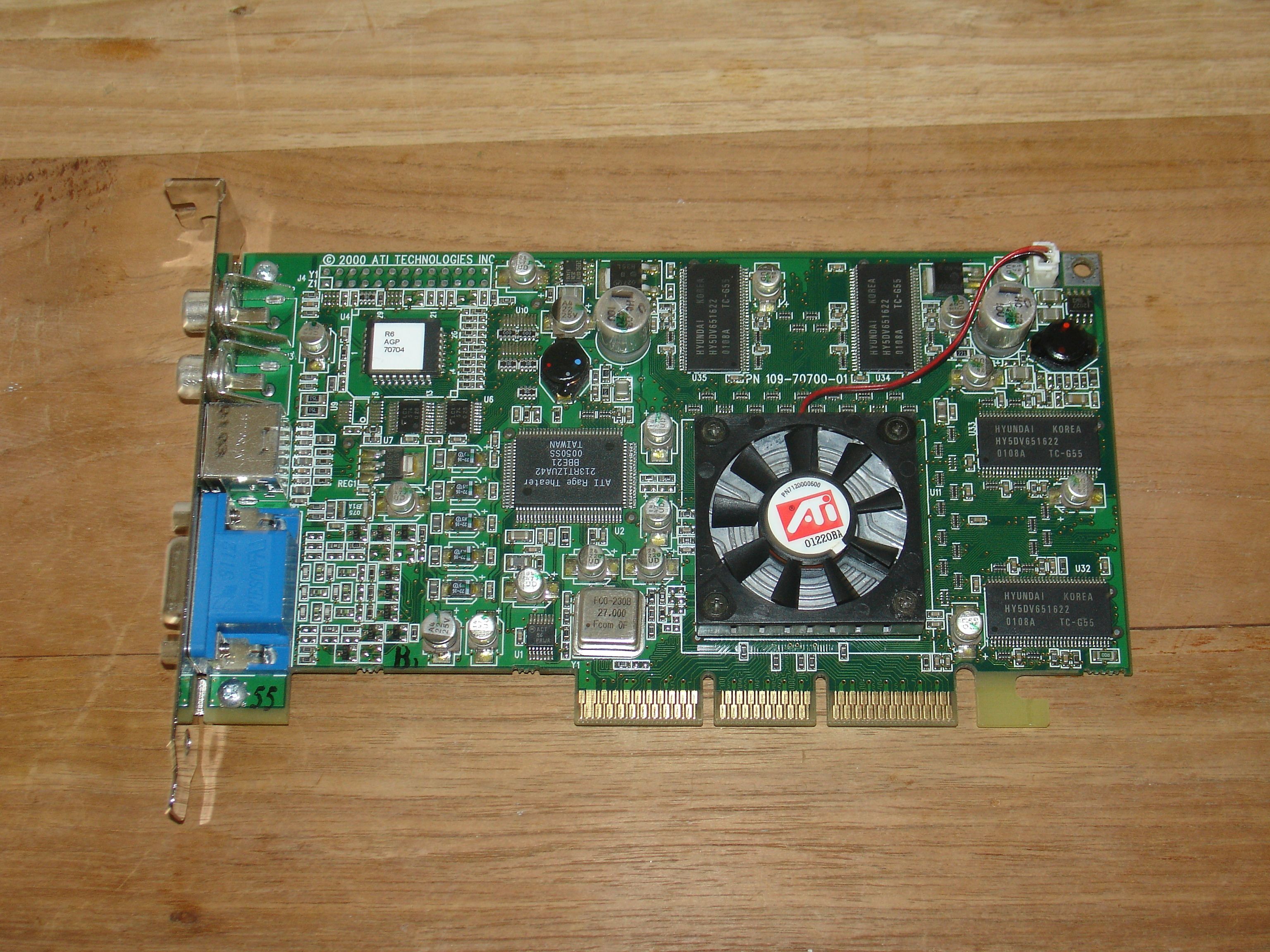

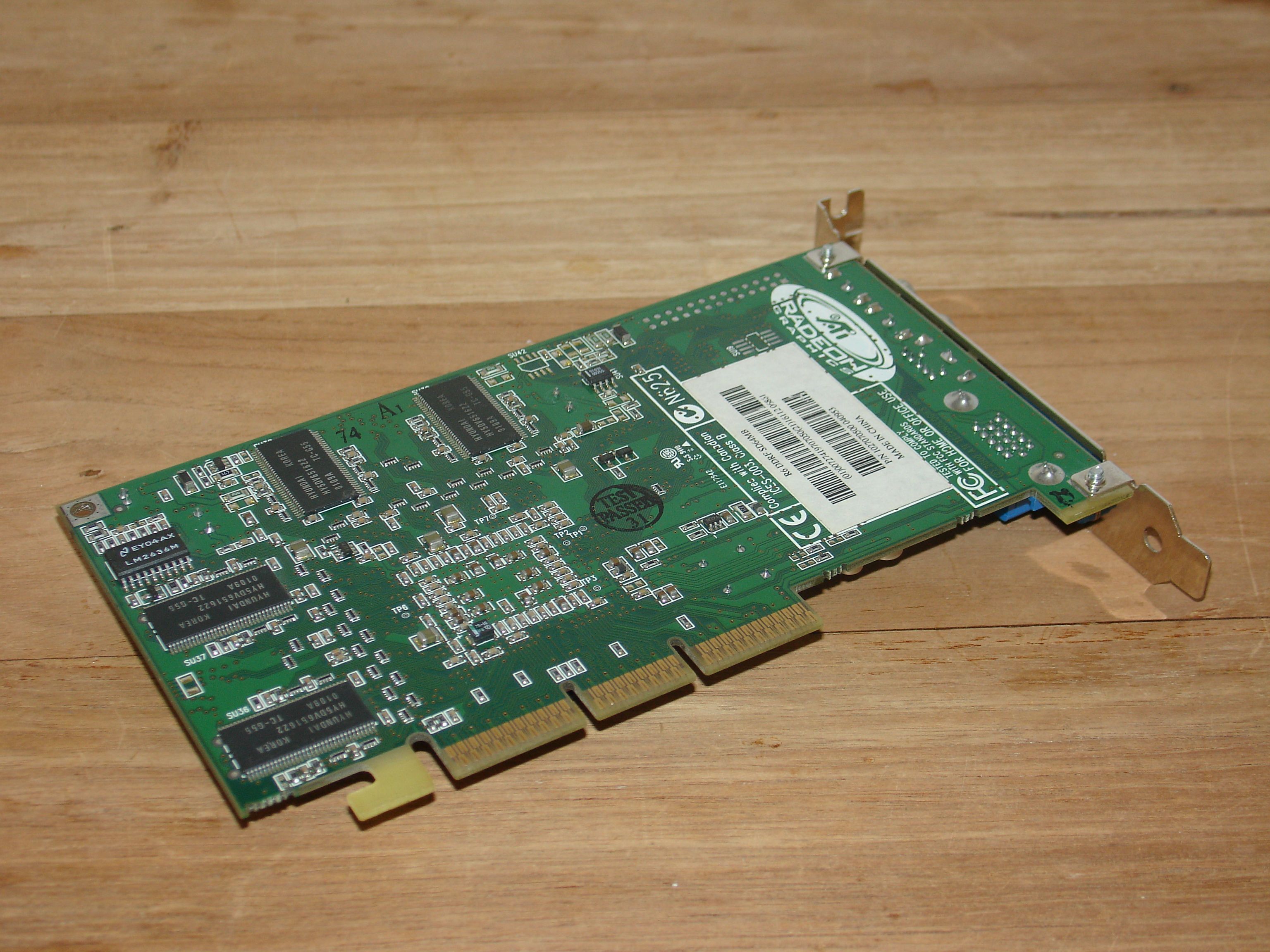

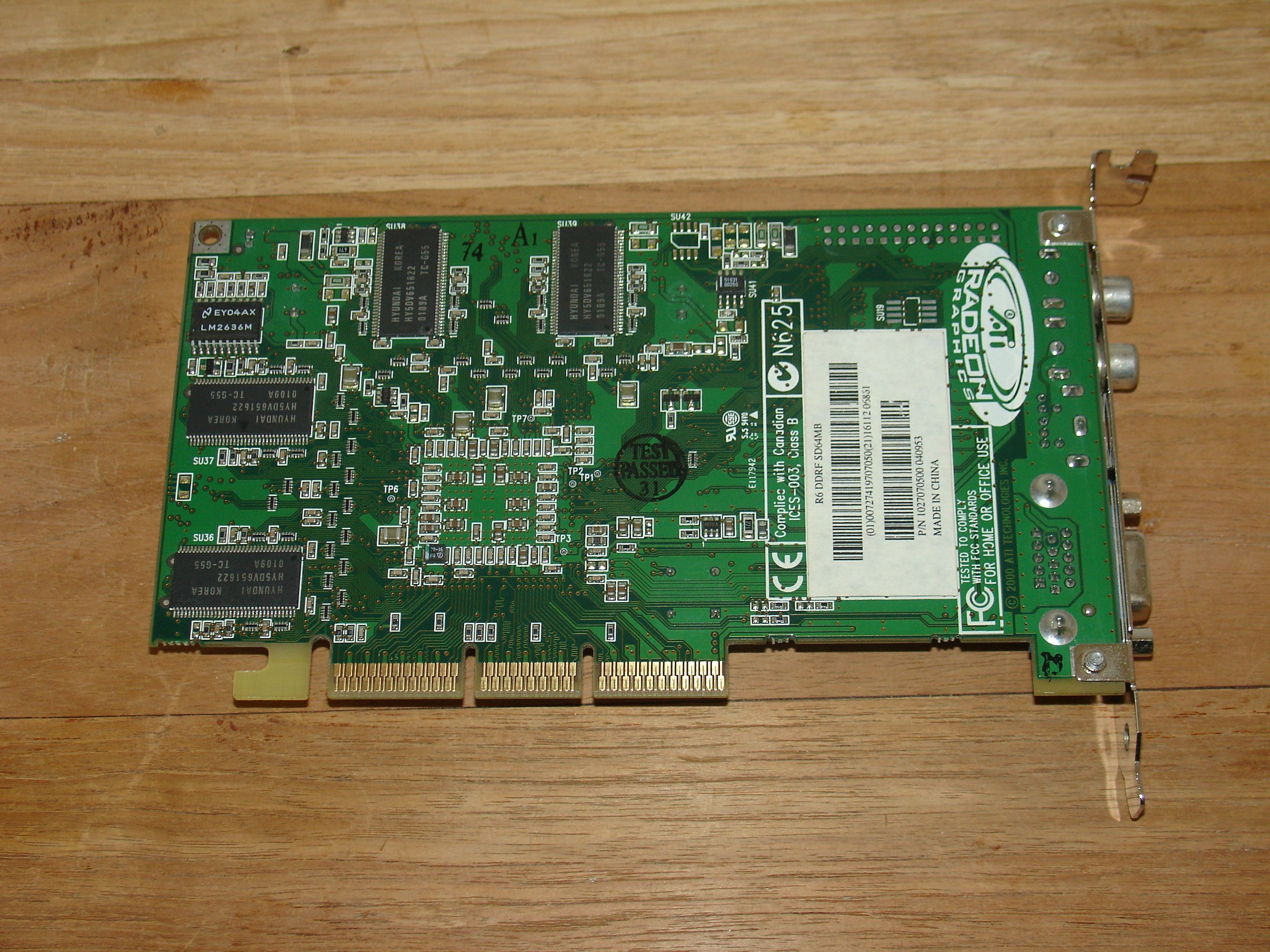

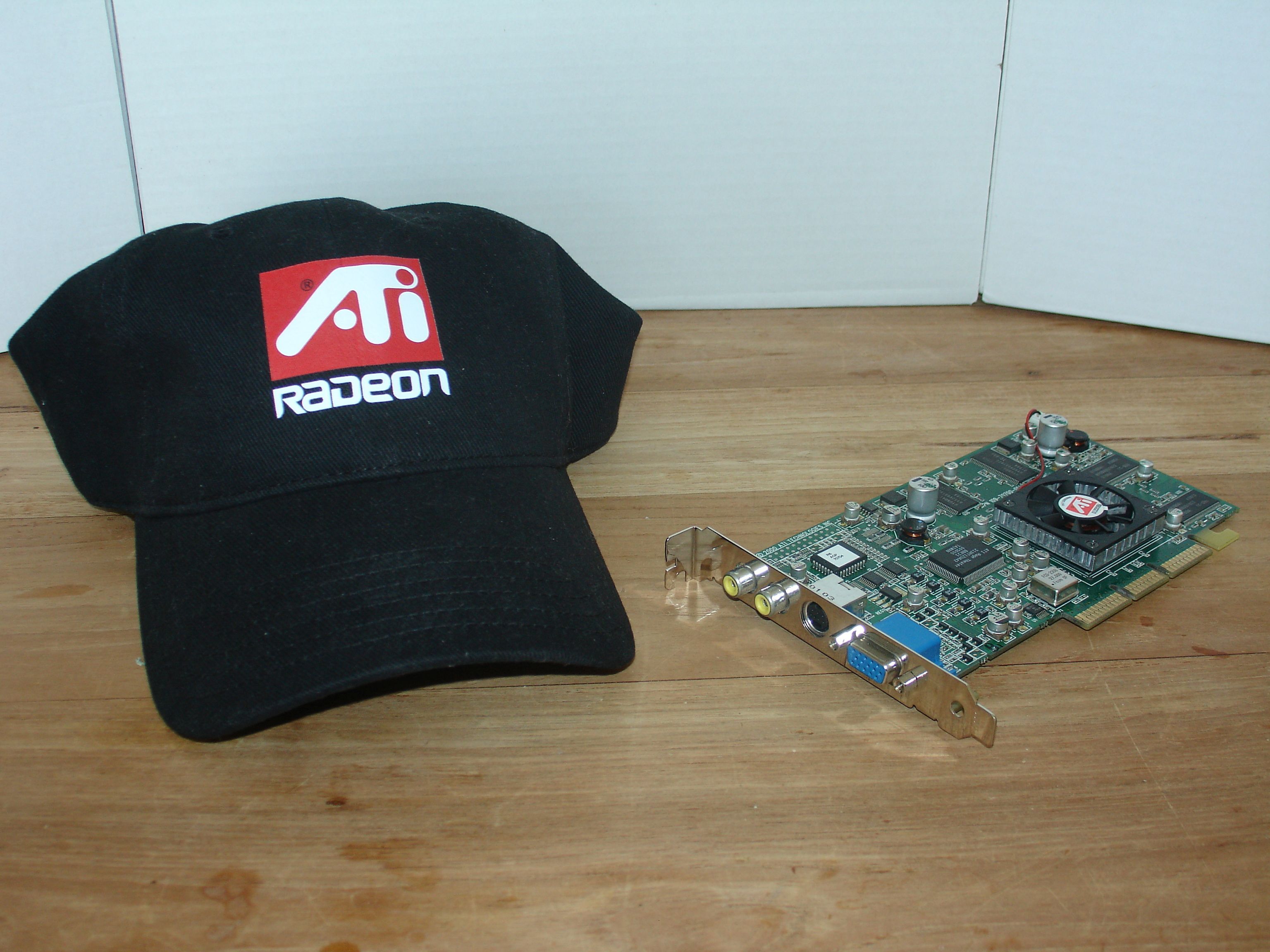

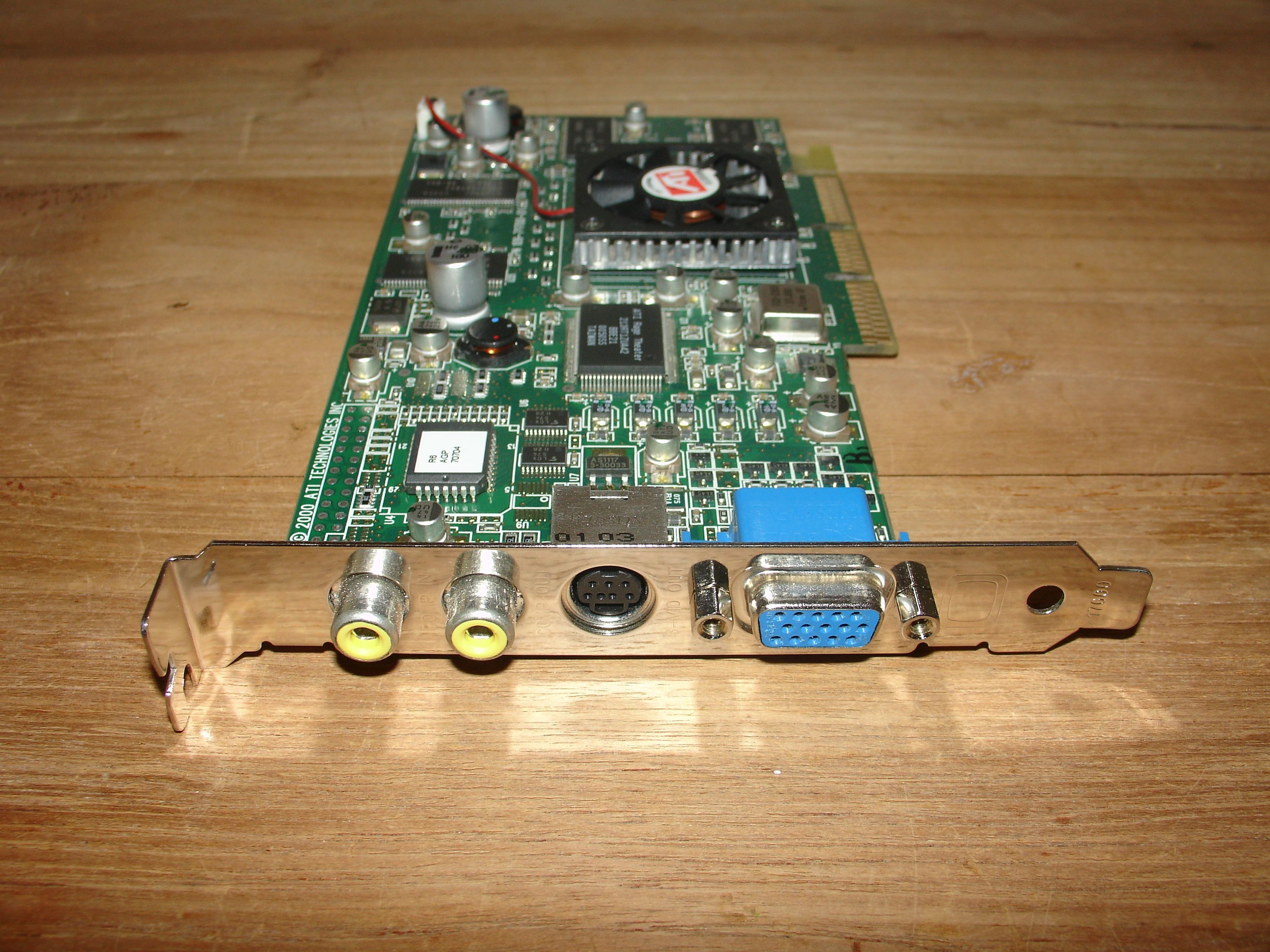

Today on March 19, 2026 a very nice and very hard to find ATi Radeon/R6 AGP 64MB 128Bit DDR Rev.A1 0111 arrived from a friend from Voodoo Alert Forums, Germany.
Which is this gem:
ATi Radeon AGP 64MB 128Bit DDR Rev.C1 0111

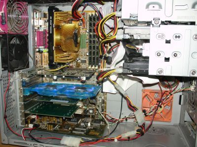

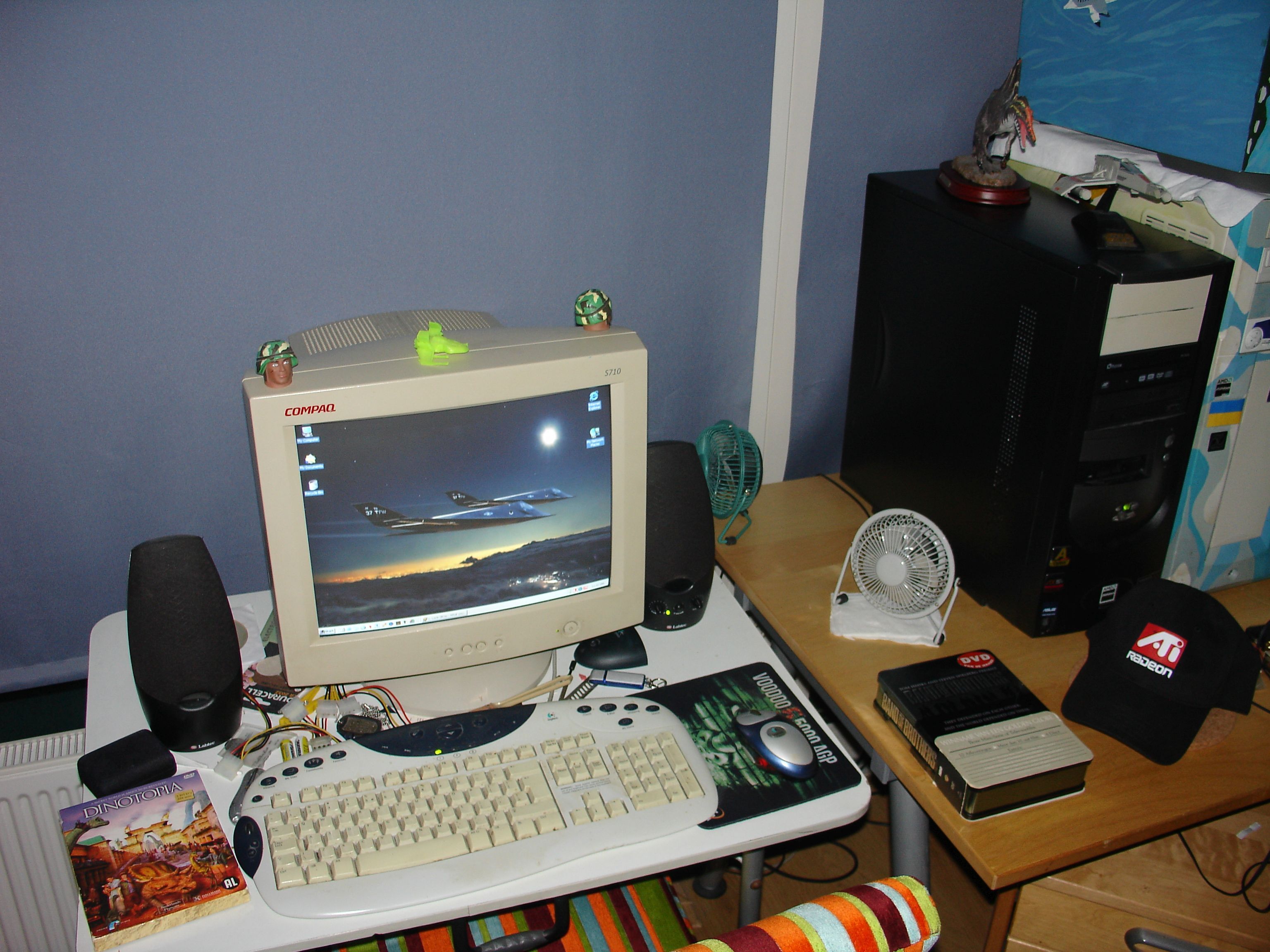

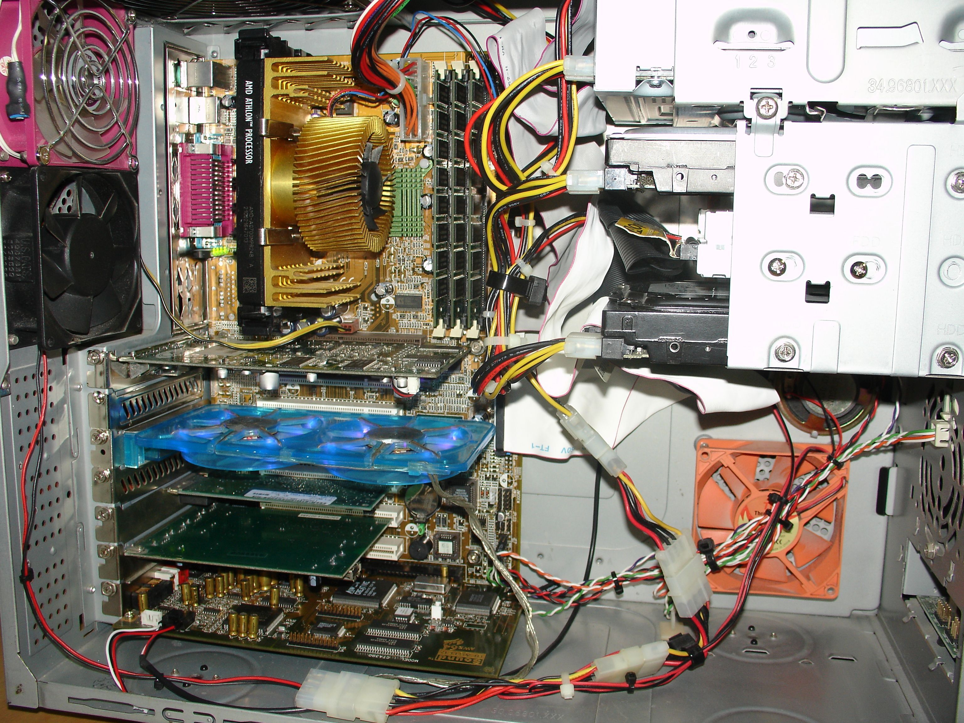

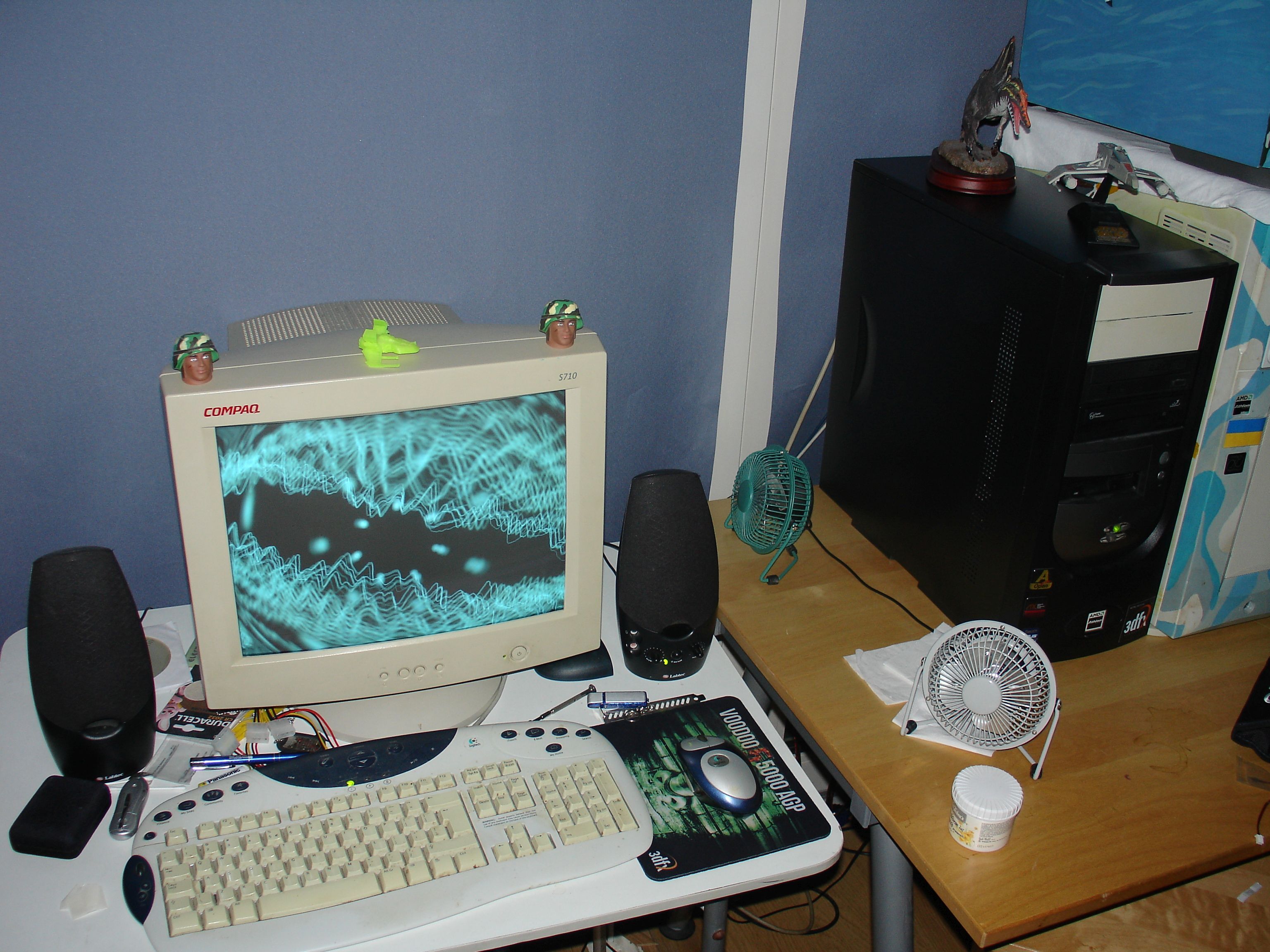

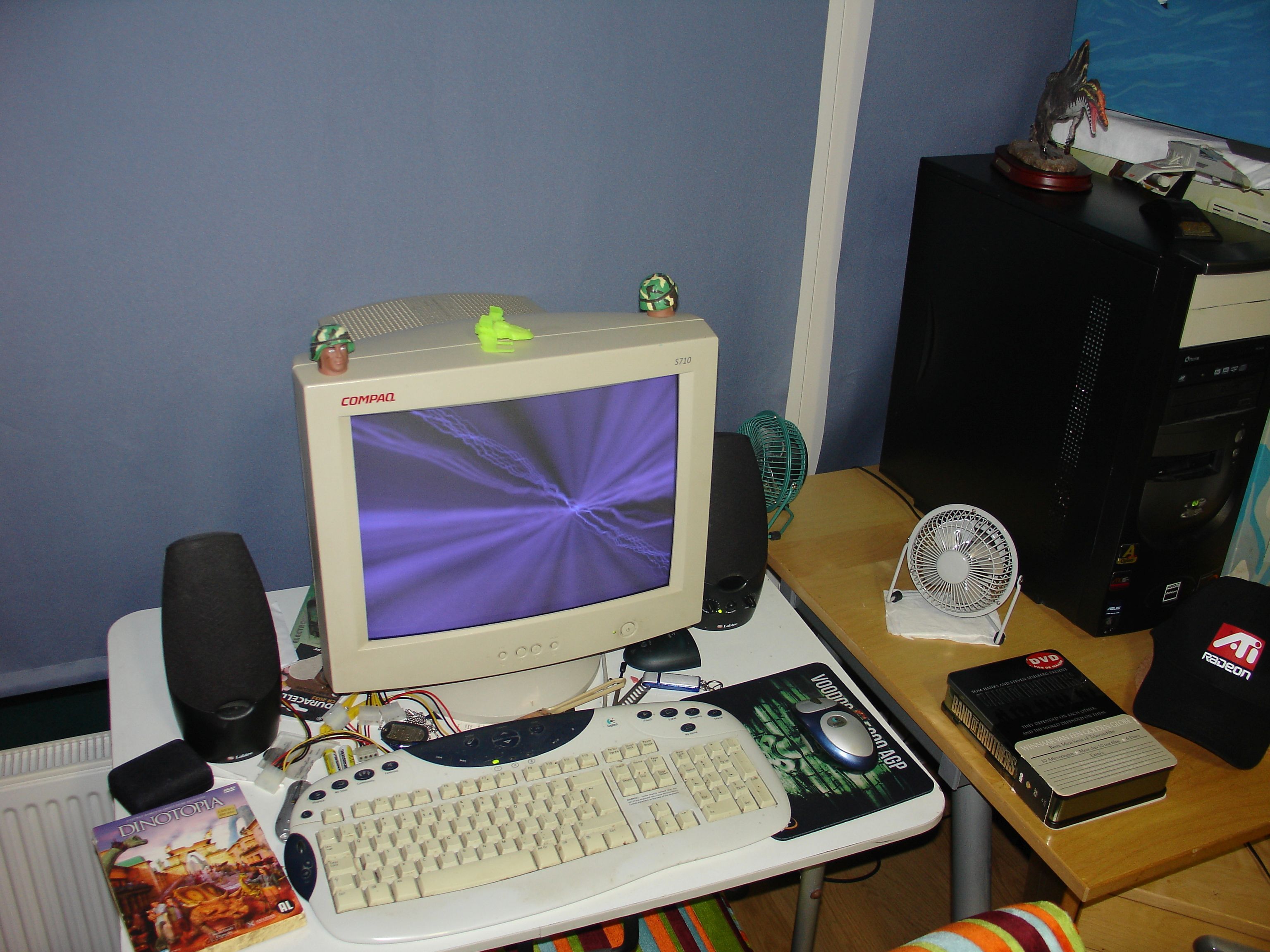

Here the system I use this one with:
Nighthawk
AMD K7 Athlon Thunderbird 700Mhz Slot A
3x 256MB PC-133 Legend / Hynix @ PC-100
MSI MS-6195 AMD Irongate AM751 Chipset
Vantec Cooling Spectrum Slot cooler card for Radeon AGP 64MB DDR, well currently.
Samsung 3.5" FDD Drive
1x 40GB Western Digital Caviar SE WD400EB 7200 rpm HDD Main drive + 8MB Cache
1x 80GB Western Digital Caviar SE WD800JB 7200 rpm HDD Slave drive + 8MB Cache
Plextor PX-760A 16x/8x DVD-RW / 48x / 24x CD-RW UATA-133 Drive
NEC ND-3500A DL-DVD-RW 16x SL-DVD-RW / 4x DL-DVD-RW / 48X CD-RW Drive
NEC 5 port USB 2.0 PCI Card + Front Panel 3 in PCI Card 2 in Front Panel
Intel Pro 100/S Desktop Adapter PCI (10/100Mbit Ethernet PCI Card)
Creative Labs Sound Blaster Audigy2 ZS SB0350
2002 A-Open H-600-B ATX Case
A-Open 350 Watt PSU or equivalent.
Compaq S710 17" Blackshade CRT from 2001
Reso @ 1024x768x32 @ 85Hz | 0.22.5 Dot Pitch
Win2K Pro UK + SP4 & RU-01 for SP4
ATi Catalyst 6.4 for Win2K/XP
Here some pics I made, after searching for this card for more than 10 years, all worth the patience in the end, I added my 1971 Lufthansa B747-230B the D-ABYD named: "Baden-Württemberg" with the R6 card I bought from my friend from Voodoo Alert Forums, Germany, to fit that scene, this also being the first Radeon AGP with 64MB 128Bi t DDR, I thought to match it with Lufthansa's first B747-200B sporting the Lufthansa Sunrise Delivery Livery from 1970 and my ATi hat, even tho I will try to find a better one, this one will just have to do for now:

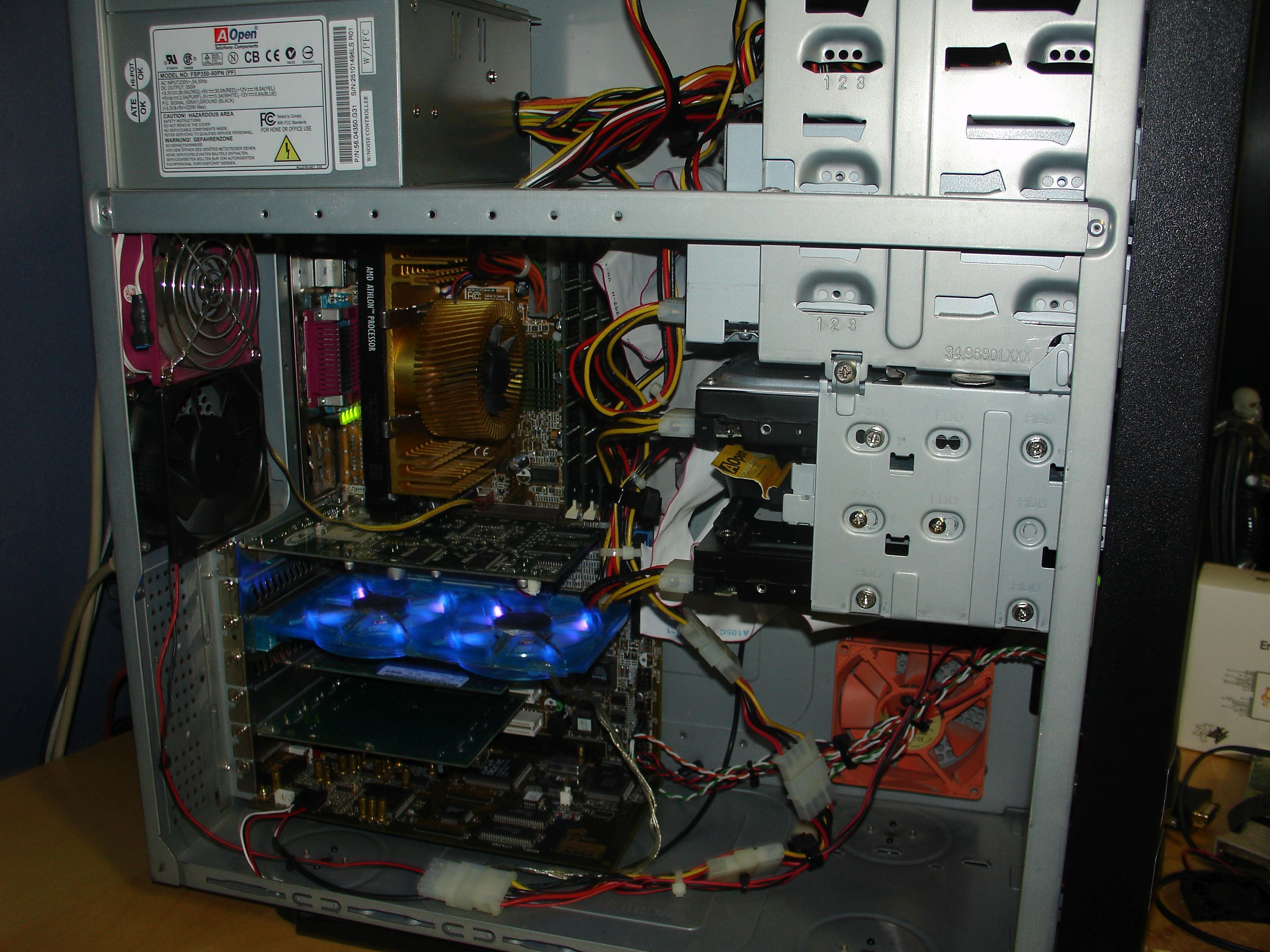

Reply 62 of 64, by Gold Leader-B747
Hello everyone, sorry for not being that active, I had a rough time with the passing of a close family member, it did take me some time to get back in to it again.
But finally I was able to upgrade the Slot A build to something far more proper, I added the following parts just to perfect the system and make it more optimized for it's timeline of Mid 2000.
AMD K7 Athlon Thunderbird 900Mhz for Slot A
2x Noctua NF-A6x15 FLX 60x60x15mm fans
3dfx Voodoo3 3000 PCI 16MB with 5.5ns 128Bit SK Hynix SDRAM Rev.A 4599
And here the final setup of this Year 2000 AMD Dream Machine
Nighthawk
AMD K7 Athlon Thunderbird 900Mhz Slot A Undervolted to 1.60v CPU voltage
3dfx Voodoo 3 3000 PCI 16MB 128Bit SDR Rev.A 4599 with 5.5ns SK Hynix SDRAM
Creative Labs Sound Blaster AWE64 Gold CT4390 4MB ISA PCB Date 3197
(Gold Recap done for CT4390 by by Backfire from Voodoo Alert Forums, Germany)
AmigaSport 3.0 for Win2K/XP for V3 3K PCI
So here the pics of this beauty that is finally completed:
Here the CPU with the two Noctua fans mounted on it's brass colored heatsink, screws all are different I used what I ahd laying around, it's gives cool Makeshift look rofl
Here the two graphics cards:
Here I set the CPU voltage from 1.75 volts to1.60 volts and ran Prime95 Torture test for 9 hours and 7 minutes, all tests were passed and no errors were reported:
Here a test out of curiosity at 1.55 Volts, at first I was like haha! this won't last long, but surprisingly the system ran Prime95 Torture Test for 2 hours and 6 minutes, passing all tests and also no reported errors, this did impress me that my K7 TB 900 has a very high quality die:
But when I wanted to reboot, just because why not, the system hanged and the monitor went black, so after turning off the system and discharging the PSU and then turning it on and going back to the Bios I set the CPU back to 1.60v and all is great again, I played Star Wars Dark Forces II Jedi Knight for a good 4 hours flat with the ATi Radeon AGP 64MB 128Bit DDR ViVo Retail @ 1024x768x32 + FSAA x4 & AF x16 without any issues a nice heavy test but it ran the game like no tomorrow.
So yea this did prove me that with the CPU voltage set to 1.60volts that the system is stable under all workloads, this will make the CPU less hot under long term work loads and this also helps put less strain on the +5 Volt Rail of the Power Supply Unit, well as how I was informed.

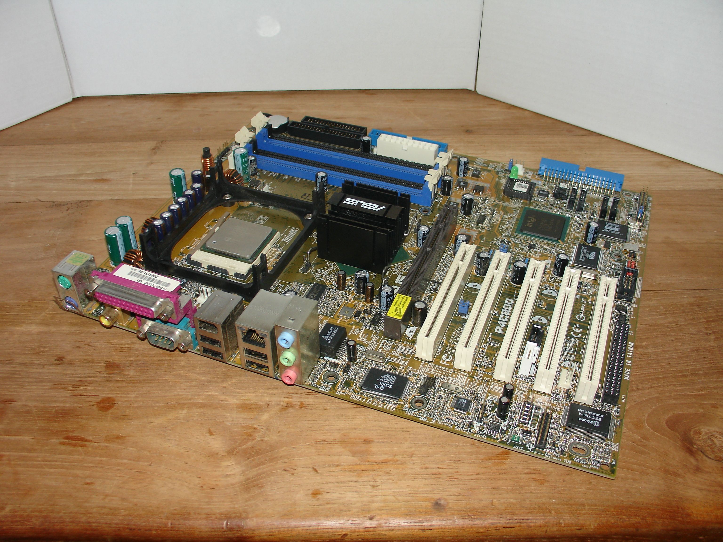

It's tie for something new and different , well from my end anyway, as I never was able to experience the Pentium 4 done right, the Northwood series of CPU's were by far the ebst i heard and read about, there were three different Northwoods that are these:
Northwood A 512KB L2 & 400Mhz FSB No Extreme Editions for this one
Northwood B 512KB L2 & 533Mhz FSB No Extreme Editions for this one
Northwood C 512KB L2 & 800Mhz FSB Extreme Editions came @ 3.2Ghz & 2.4Ghz with 512KB L2 and 2MB L3

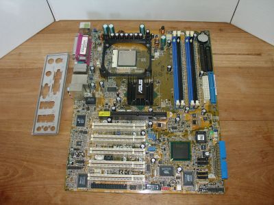

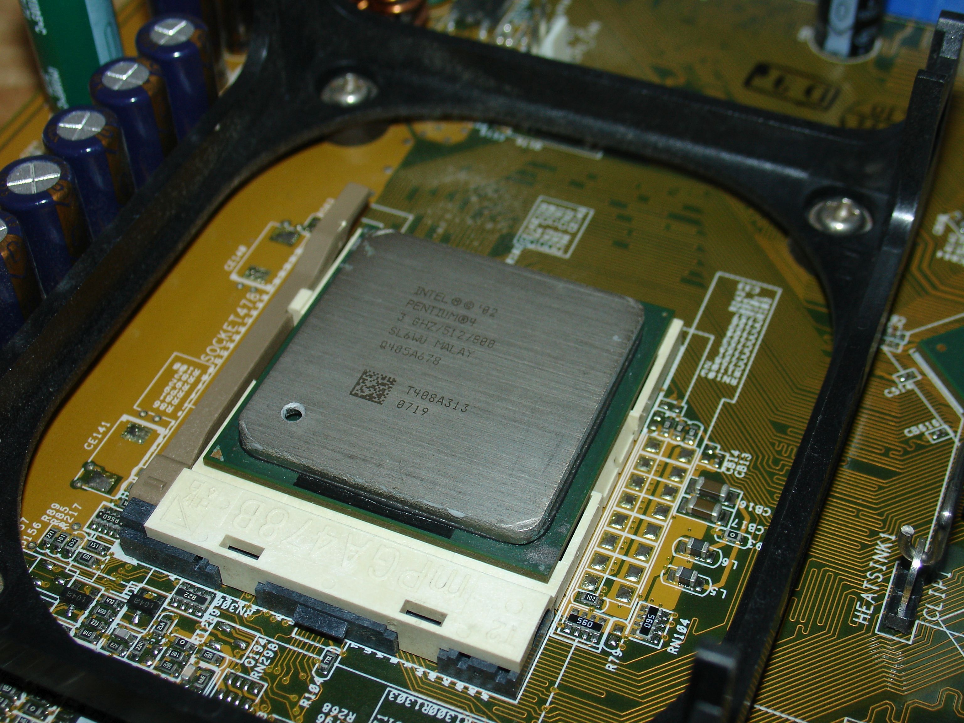

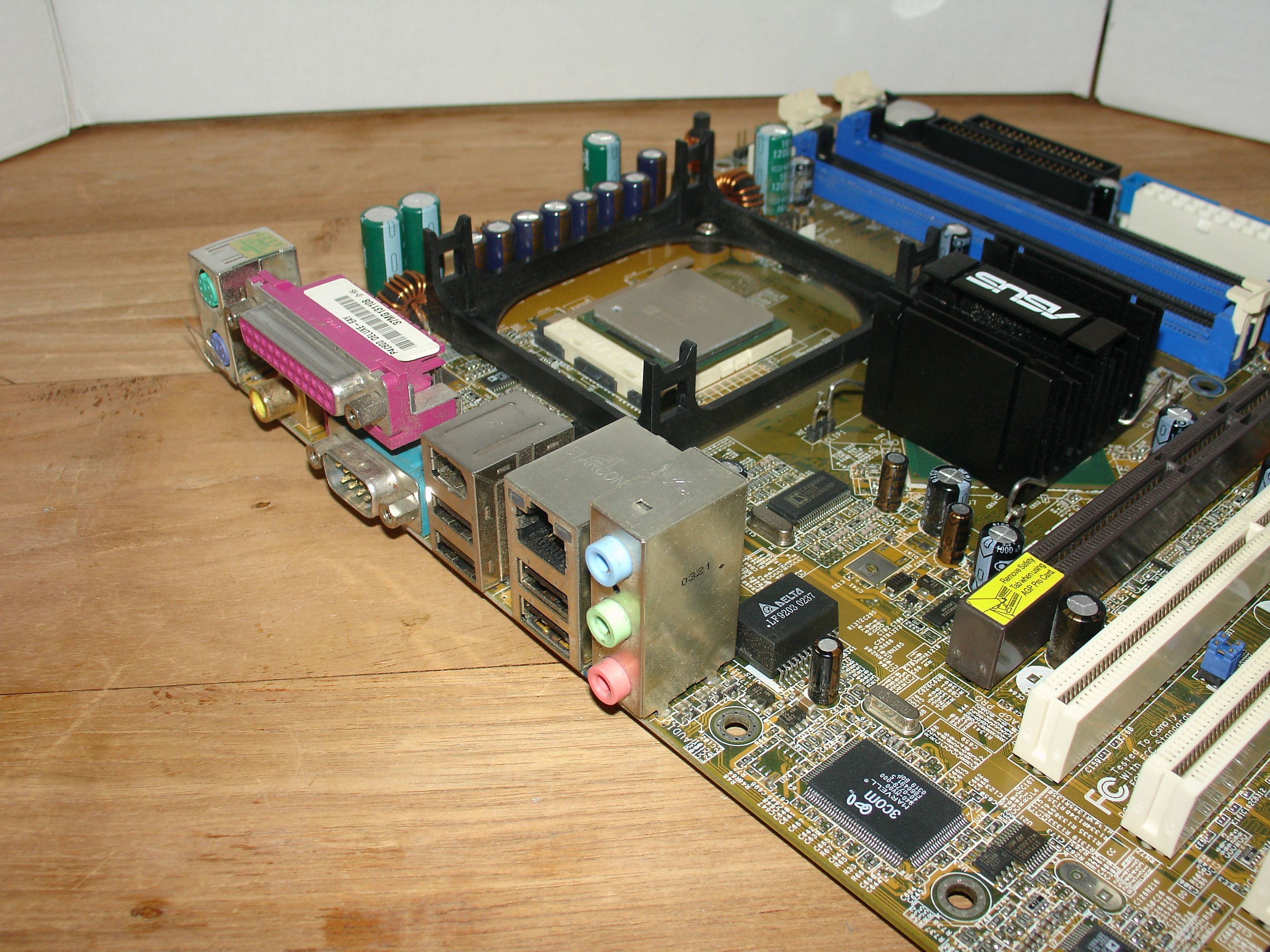

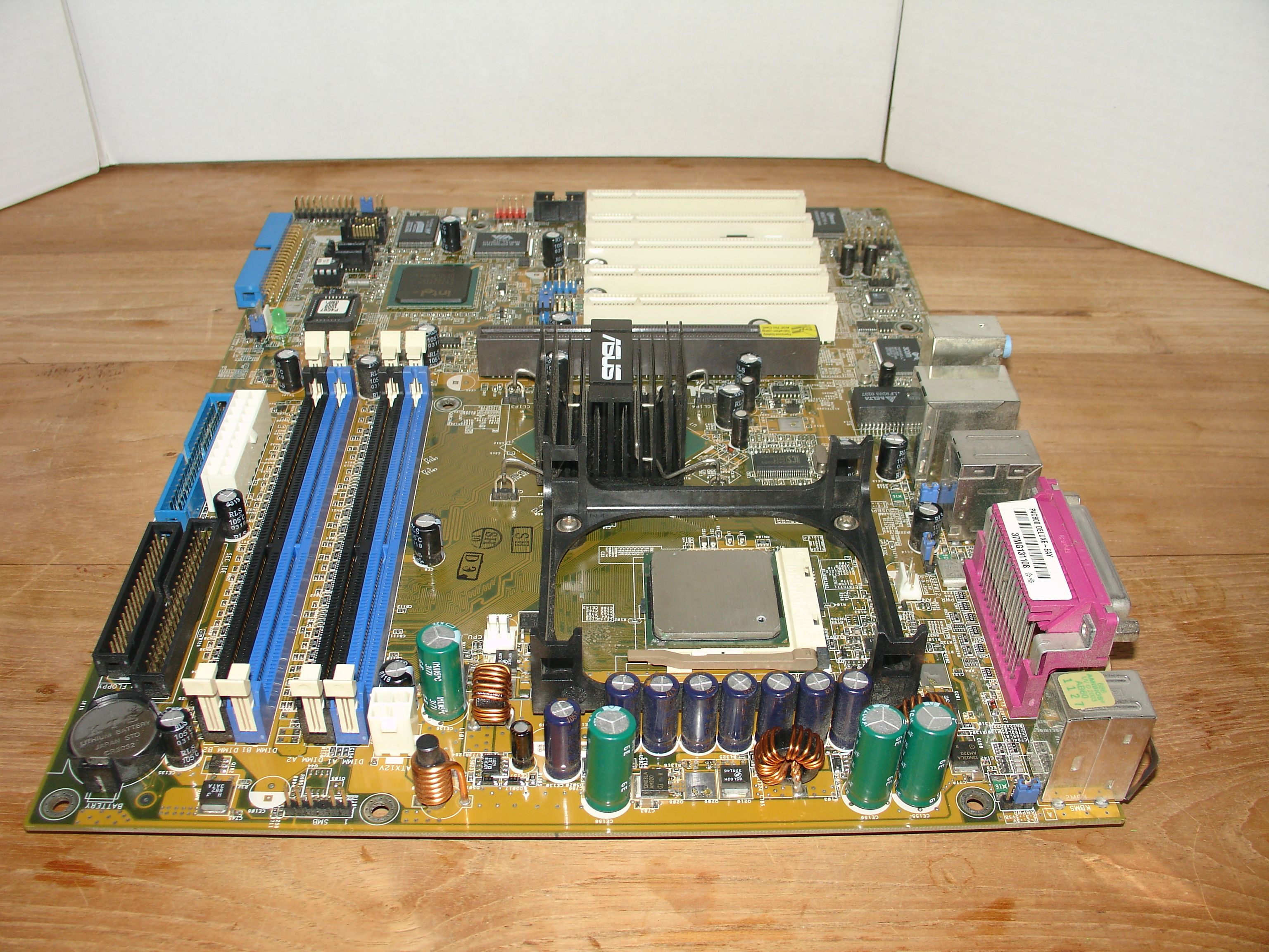

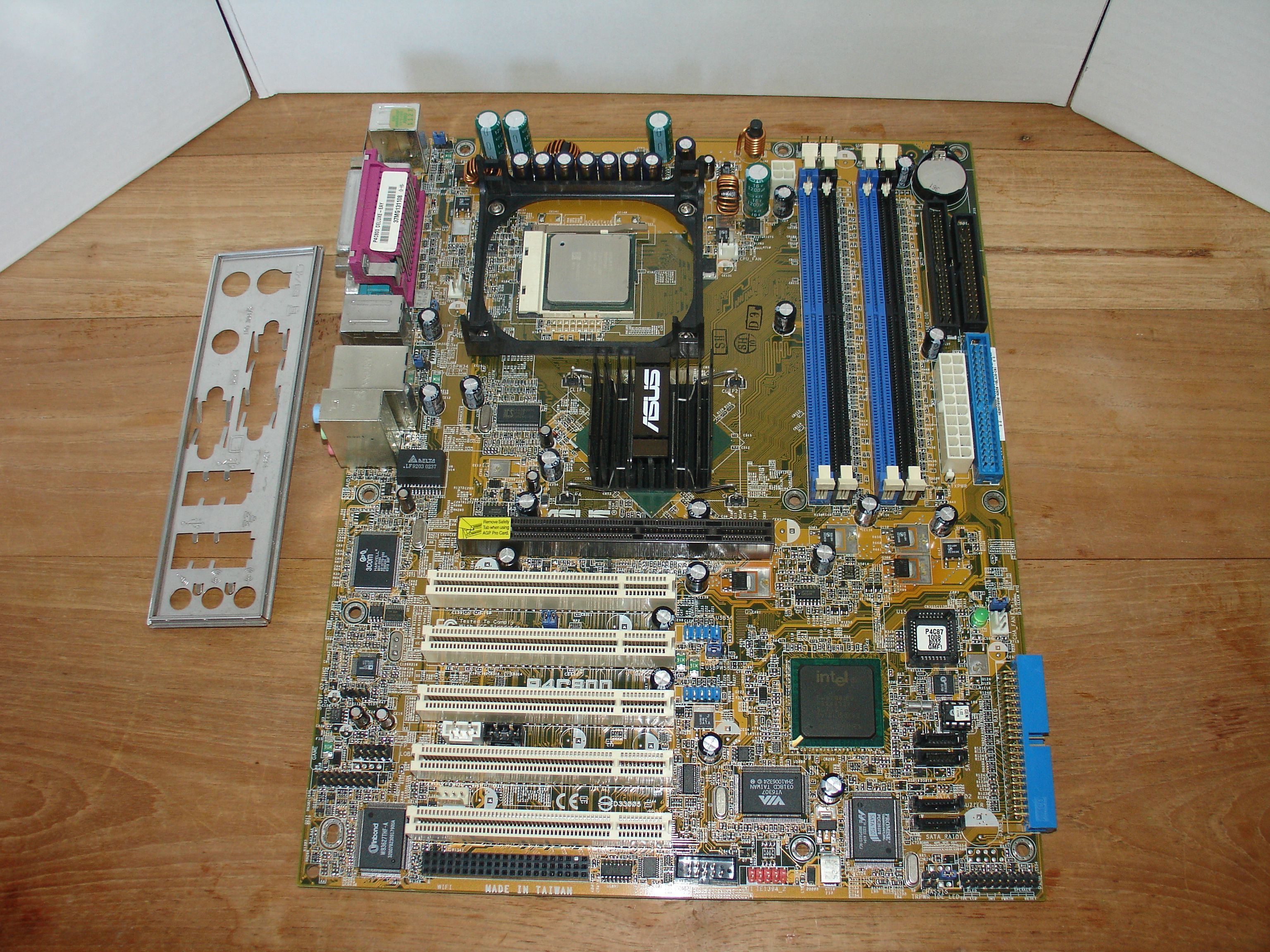

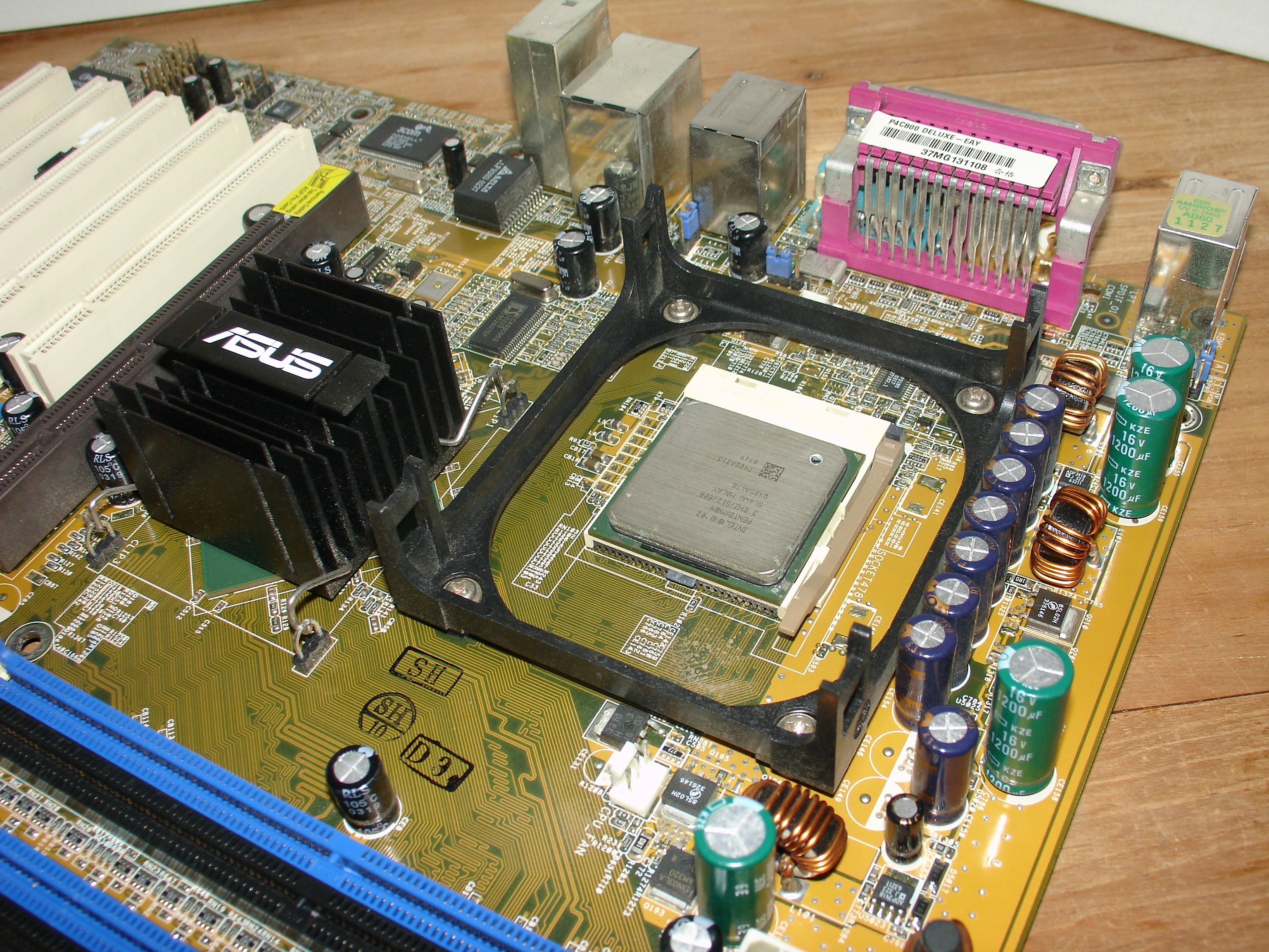

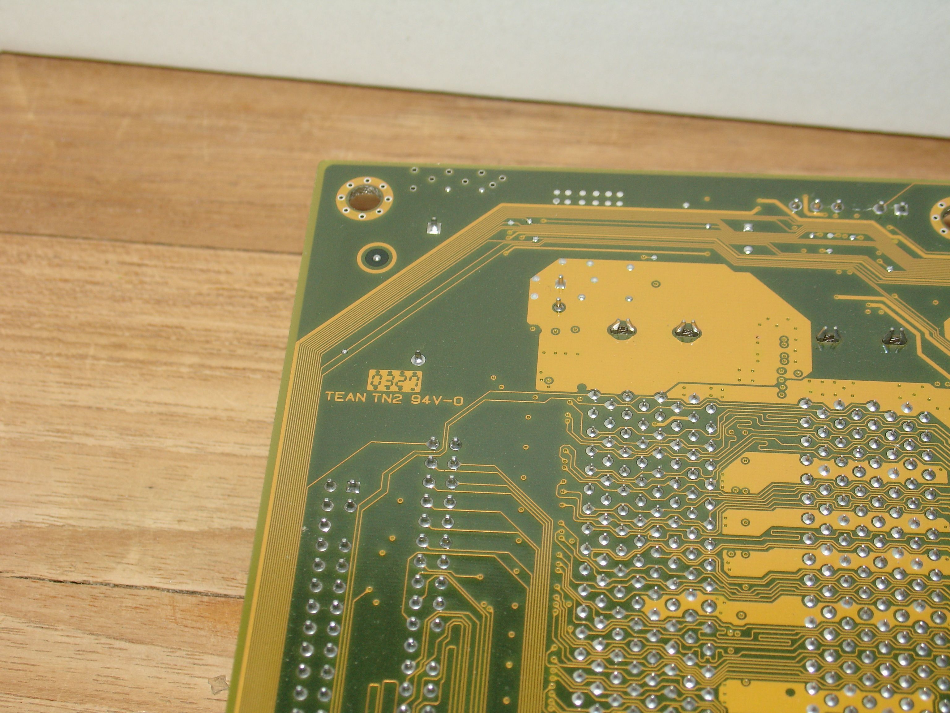

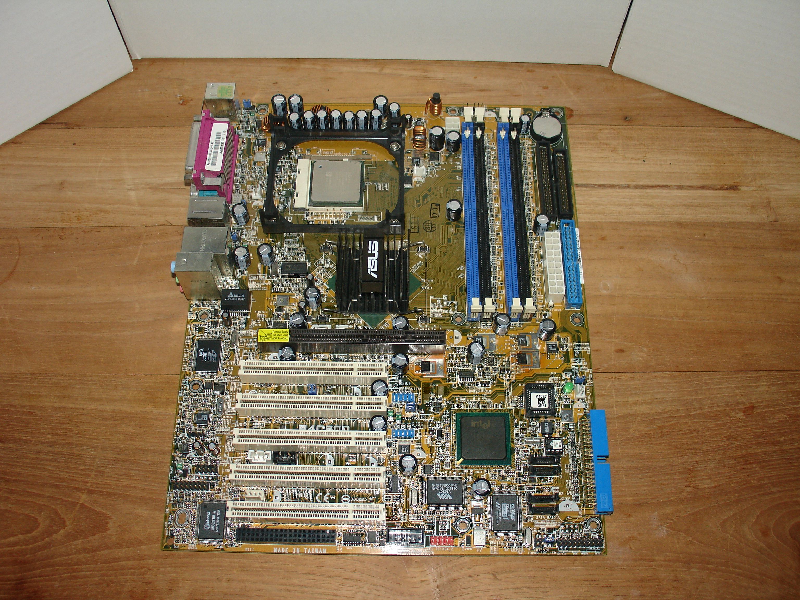

So the one I went with was the last generation of Northwood which is the Northwood C, most of the needed items I already have, this is a build log for this new build and yes I will run my V5 PCI Mac in this build as well, should give that card the CPU speed it needs.

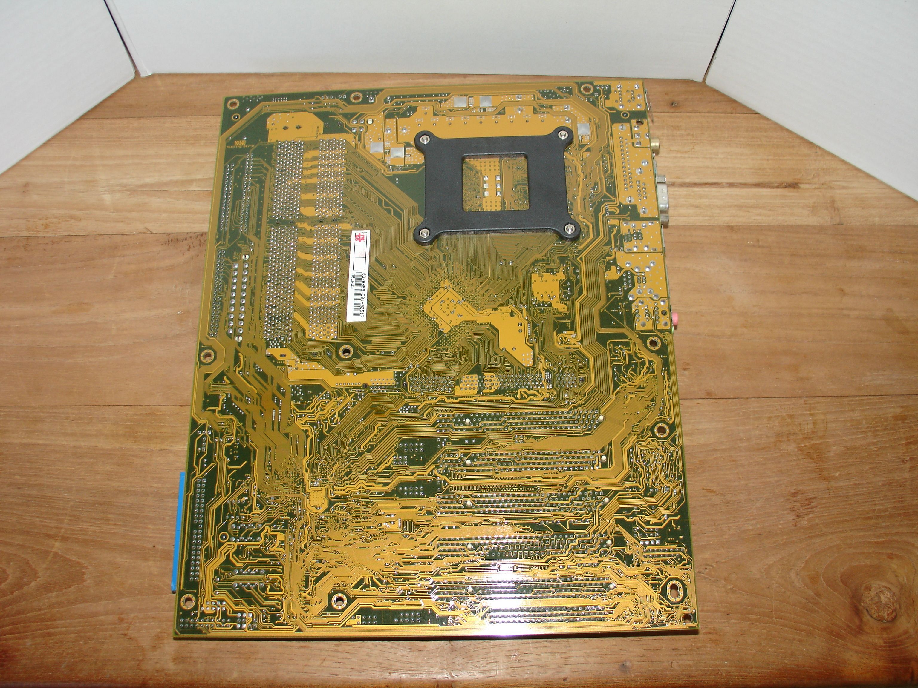

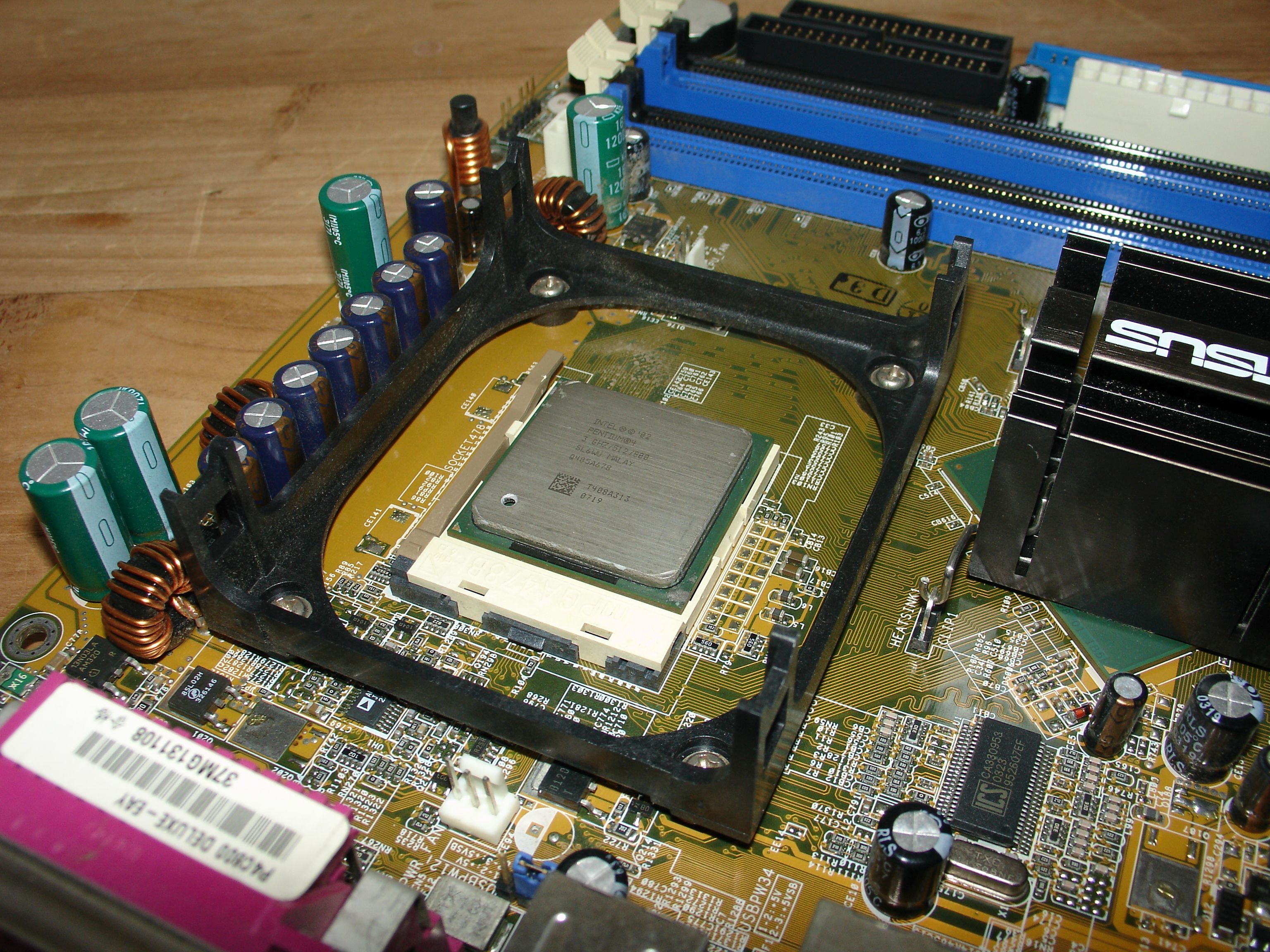

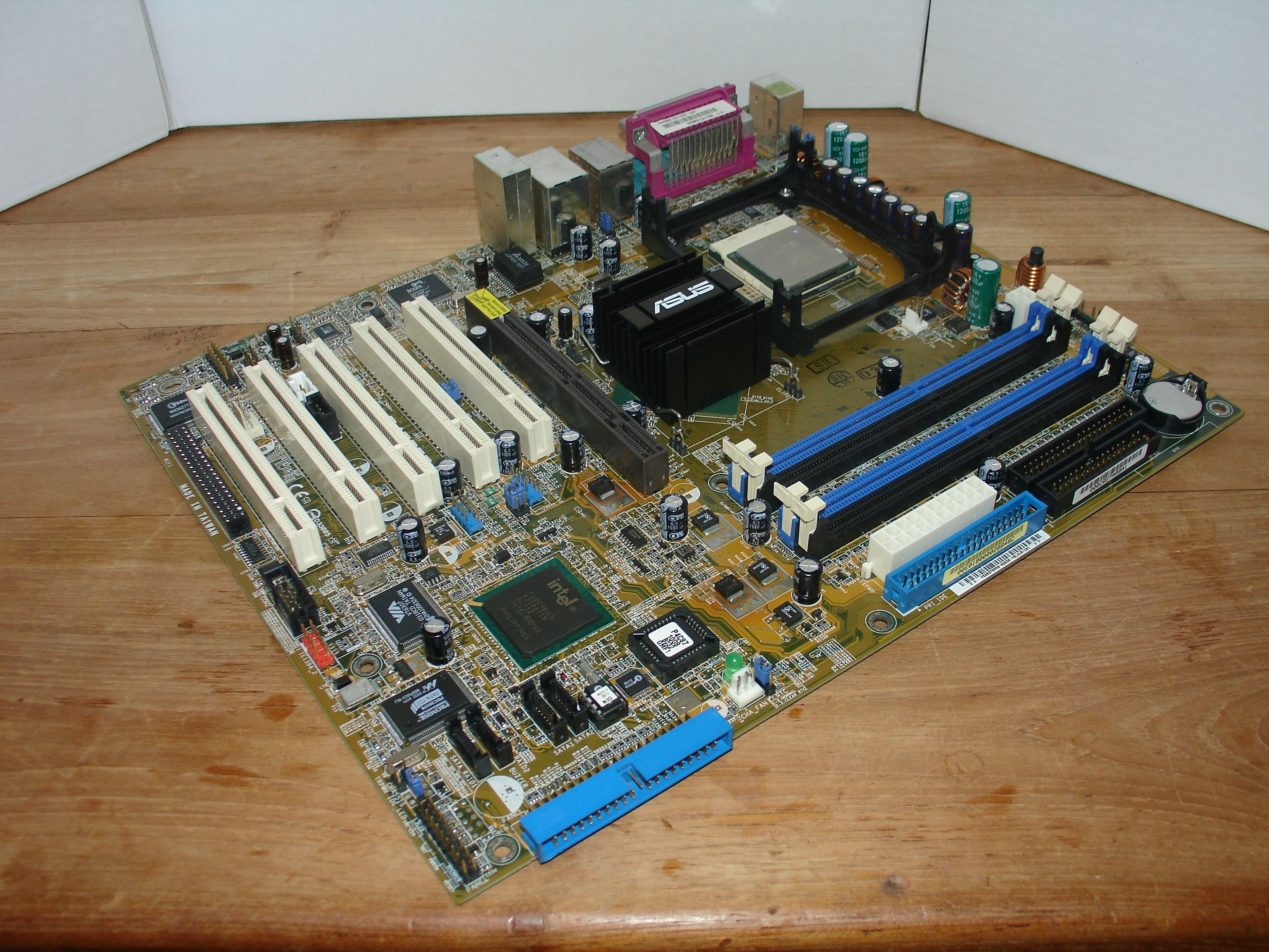

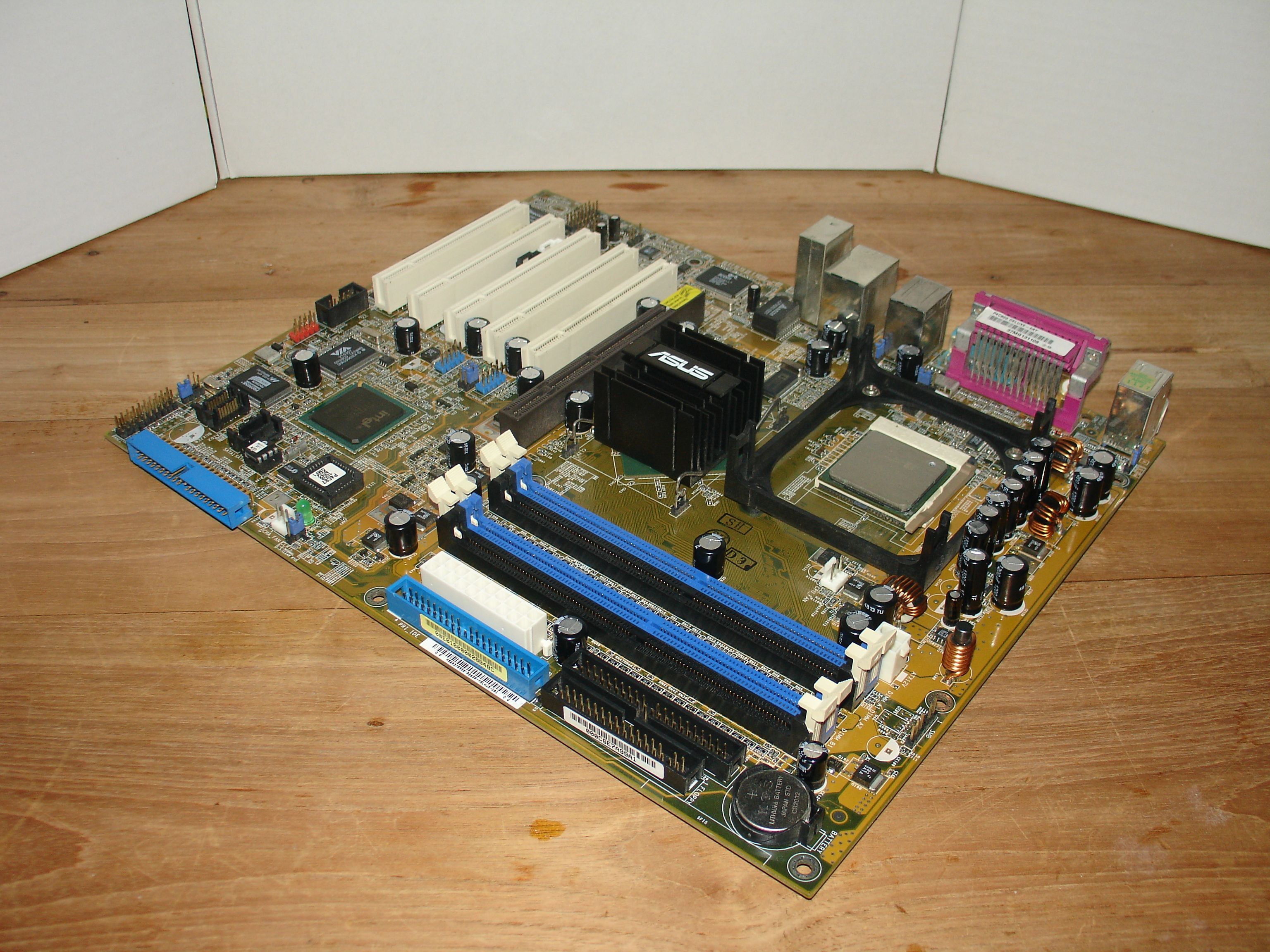

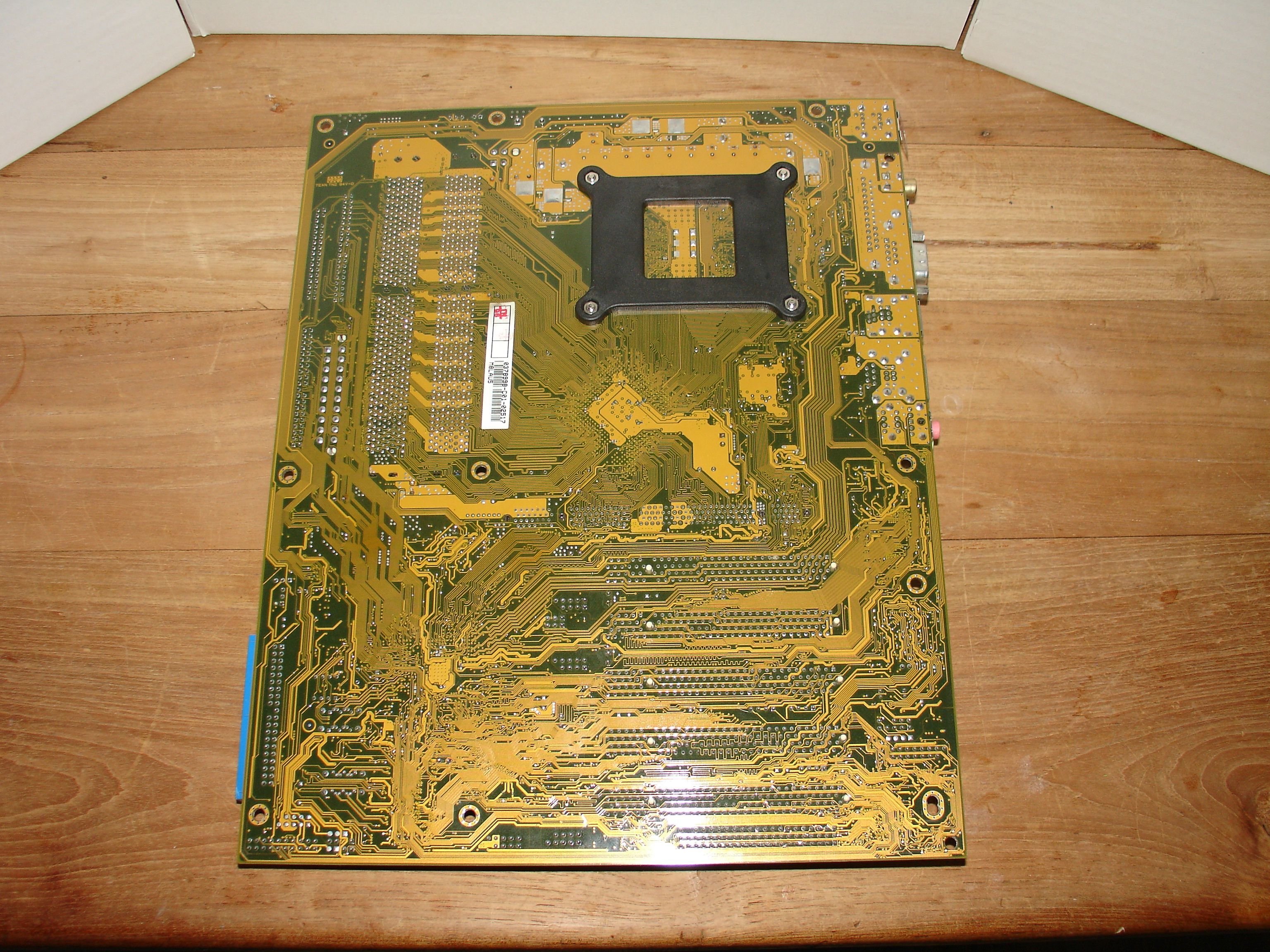

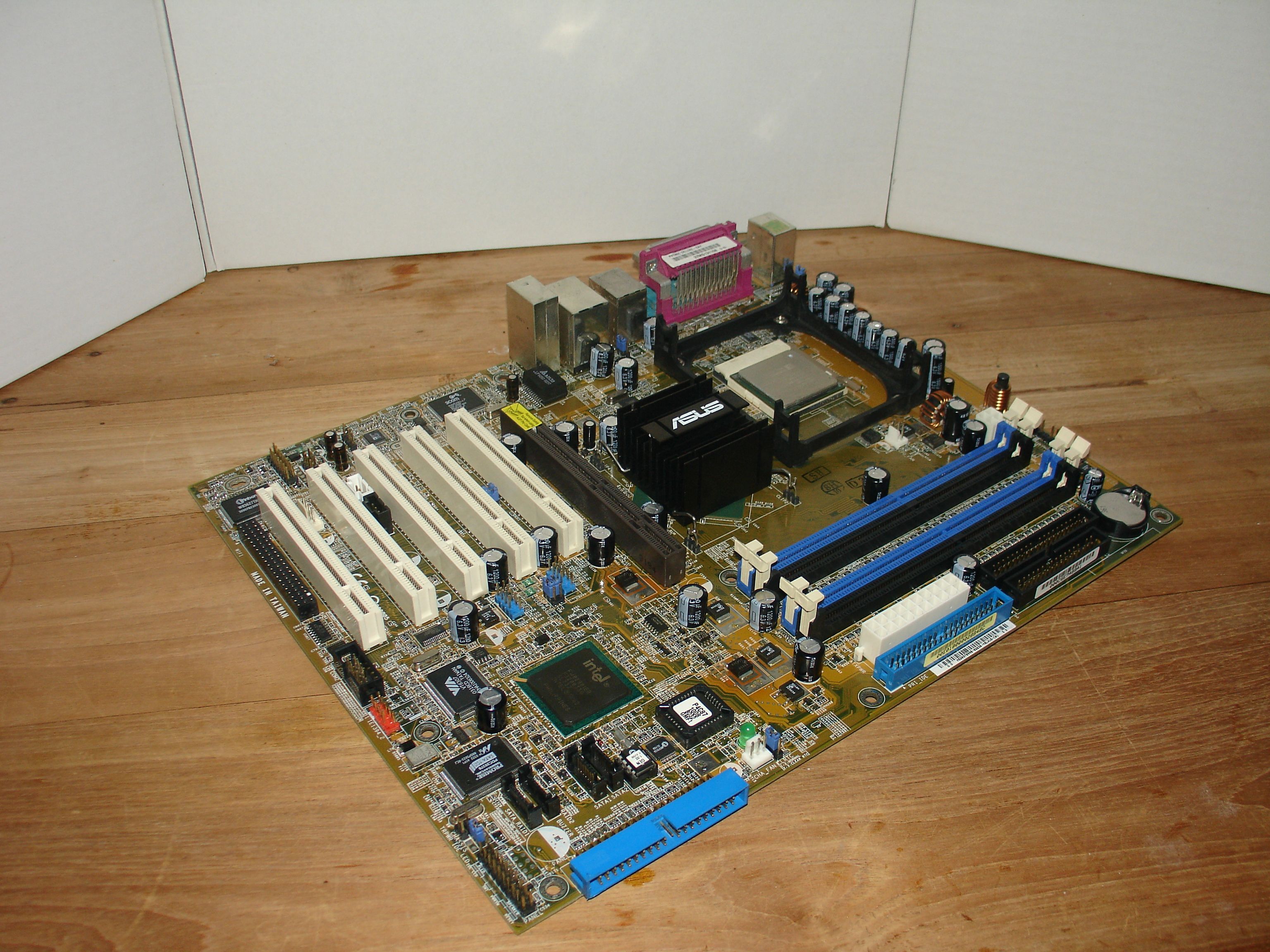

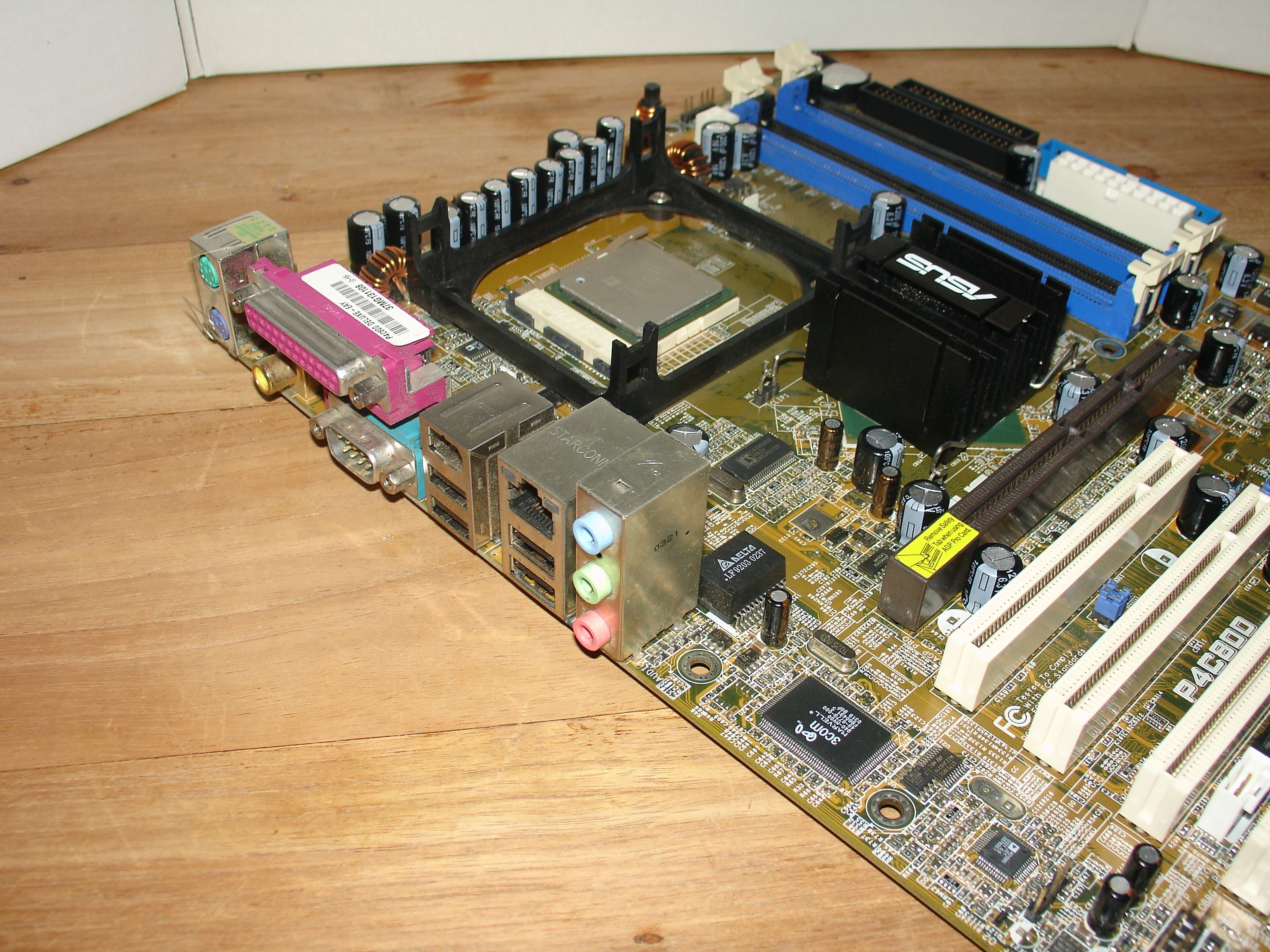

As for the mainboard Richard from x-3dfx helped me finding the one of the best OC boards of all time, which is the following:
ASUS P4C800 Rev 1.04 0327
Which was from this auction:
https://www.ebay.ie/itm/404807128219
There are Rev 2.00's, that I am very aware of, but these were too damn expensive so I went with this one, which seems to have been either well cared for or even recapped, well by the looks of it.
Even so I'd happily send this mainboard to Backfire for a Würth recap, such things can't hurt it I'd think.

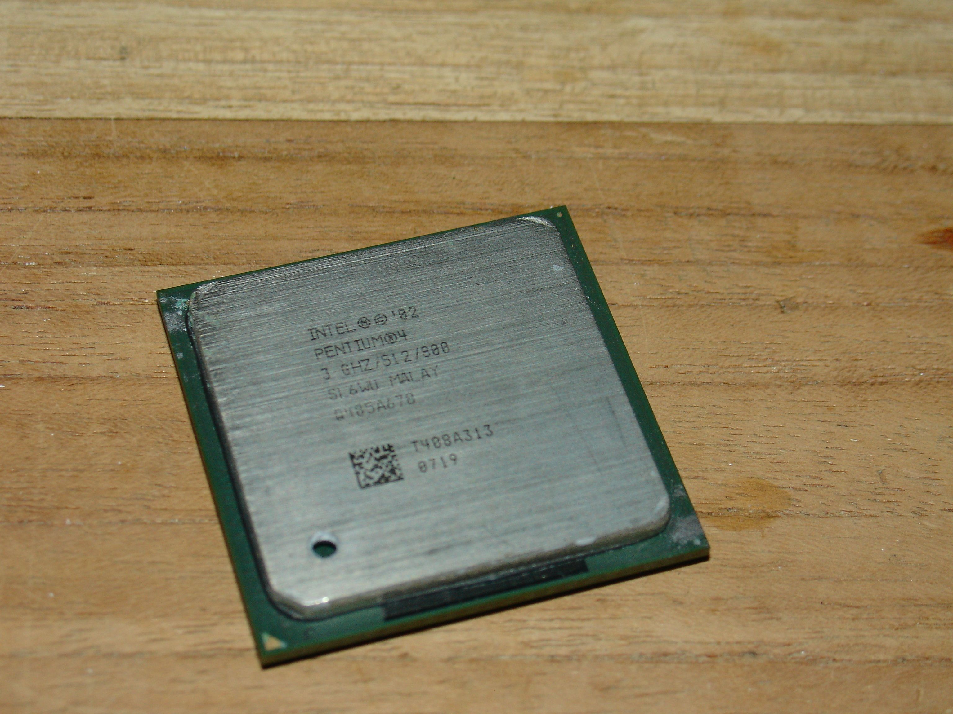

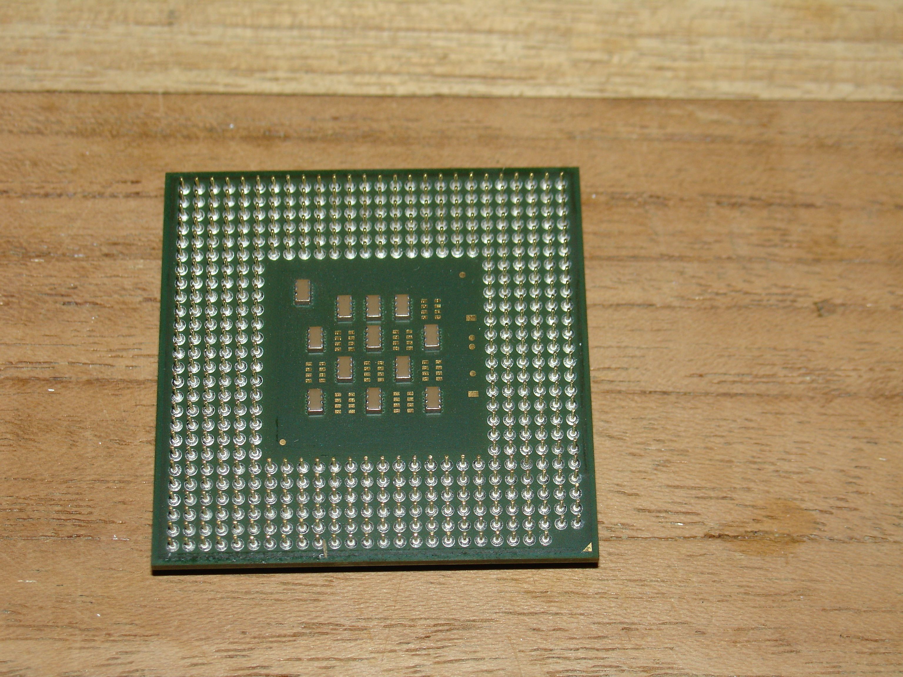

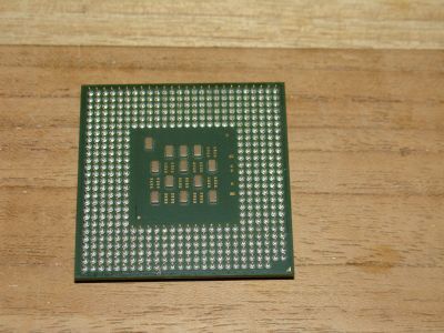

Here the CPU stand alone:
Intel Pentium 4 HT Northwood C 3Ghz, 512KB L2 & 800Mhz FSB for Socket-N 478:

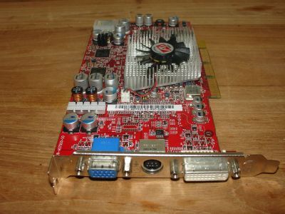

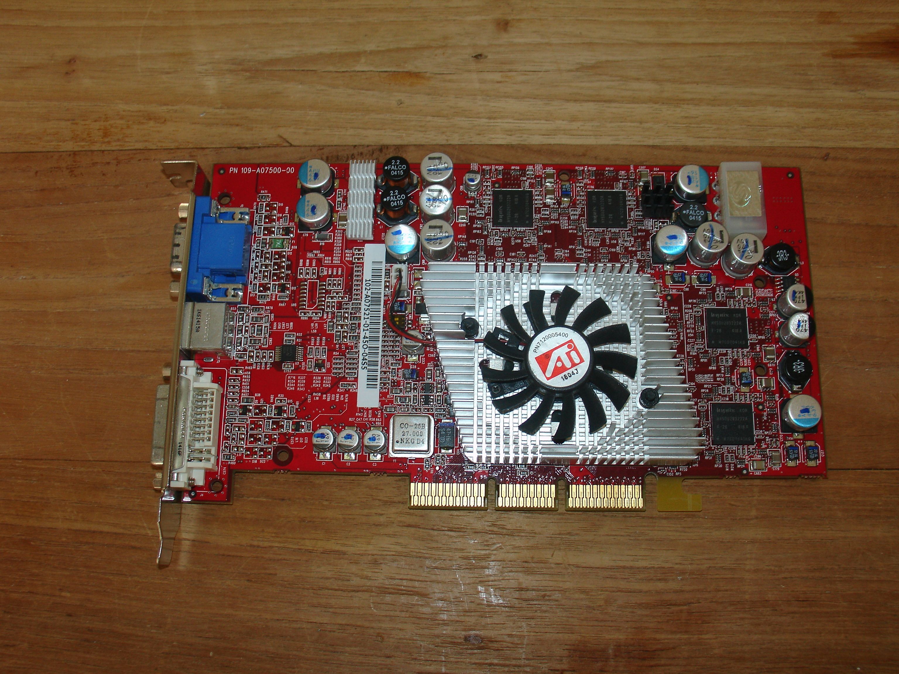

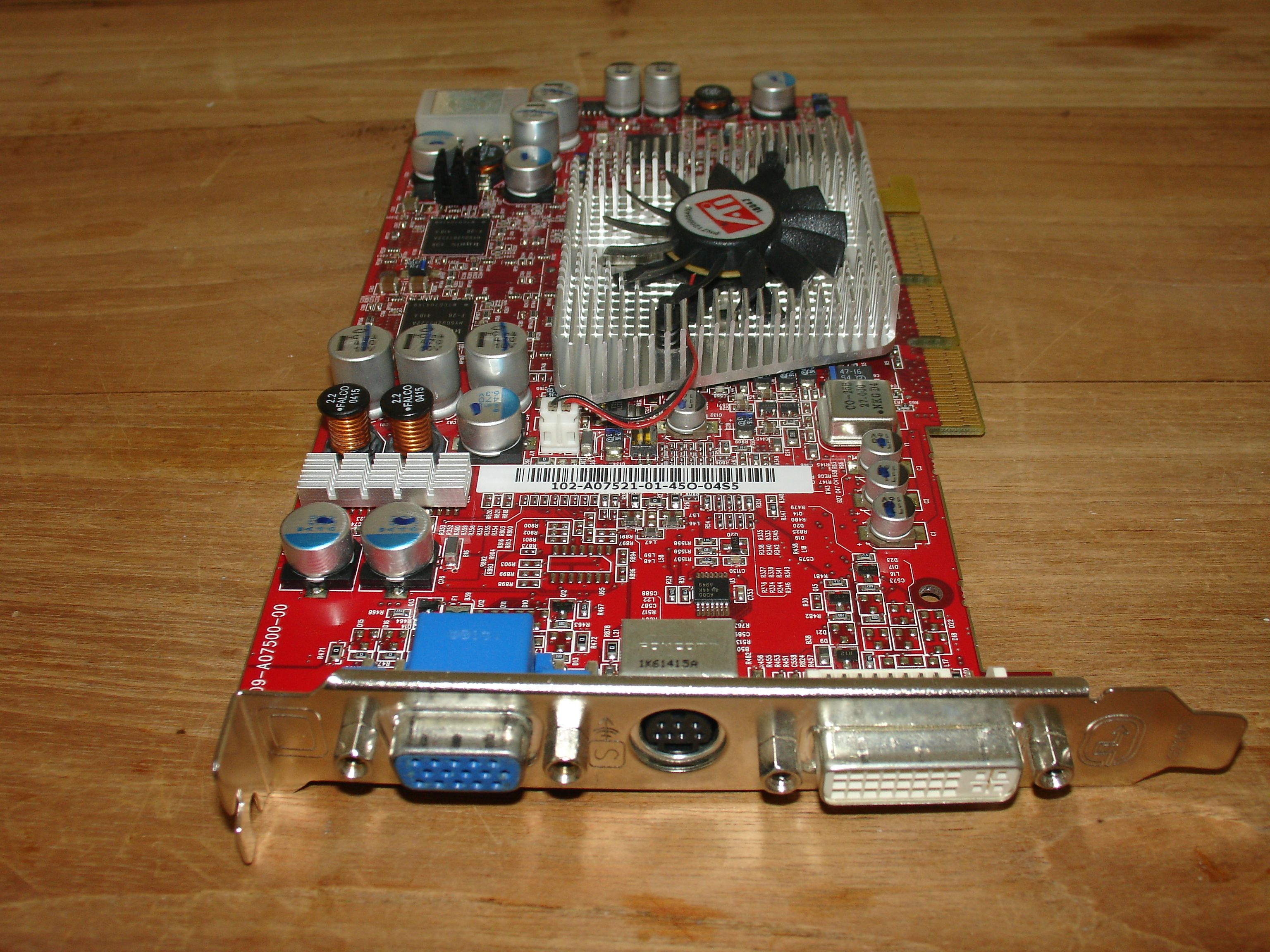

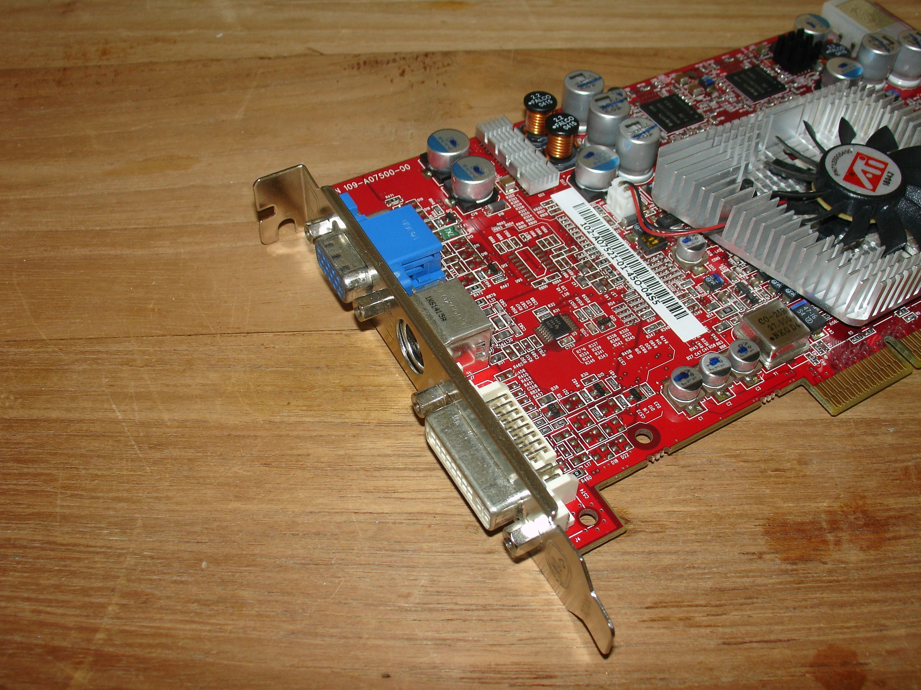

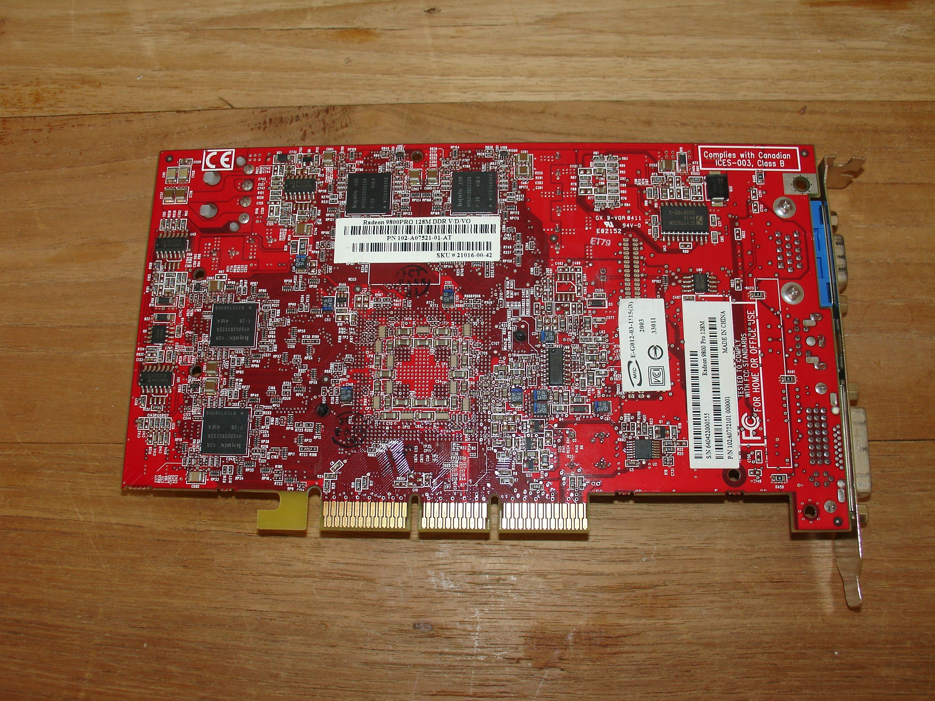

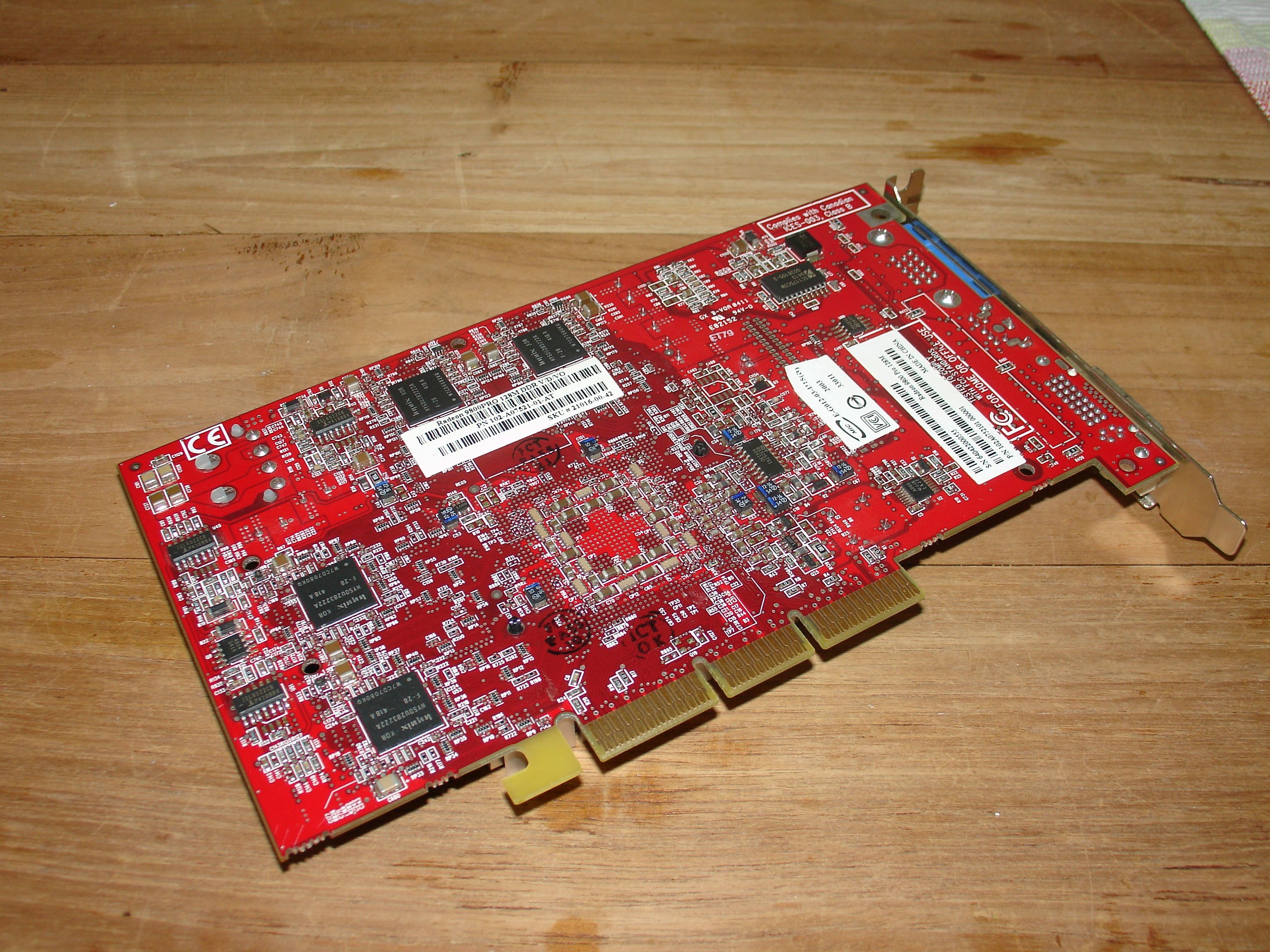

And here the main graphics card for this build which is powered by ATi's R350 KAHN-B VPU.
The ATI Radeon 9800 Pro (released in 2003) featured hardware F-Buffer (Fragment Stream FIFO) technology. This on-chip memory buffer allowed the GPU to execute pixel and fragment shaders of near-unlimited length without the severe performance loss traditionally caused by multi-pass rendering
Sapphire Atlantis Radeon 9800 Pro AGP 128MB 256Bit DDR Rev.C1 0411
So yea there ya have it, more to come as more parts arrive!

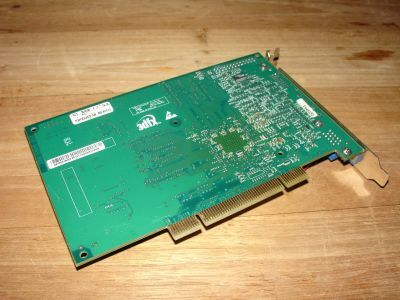

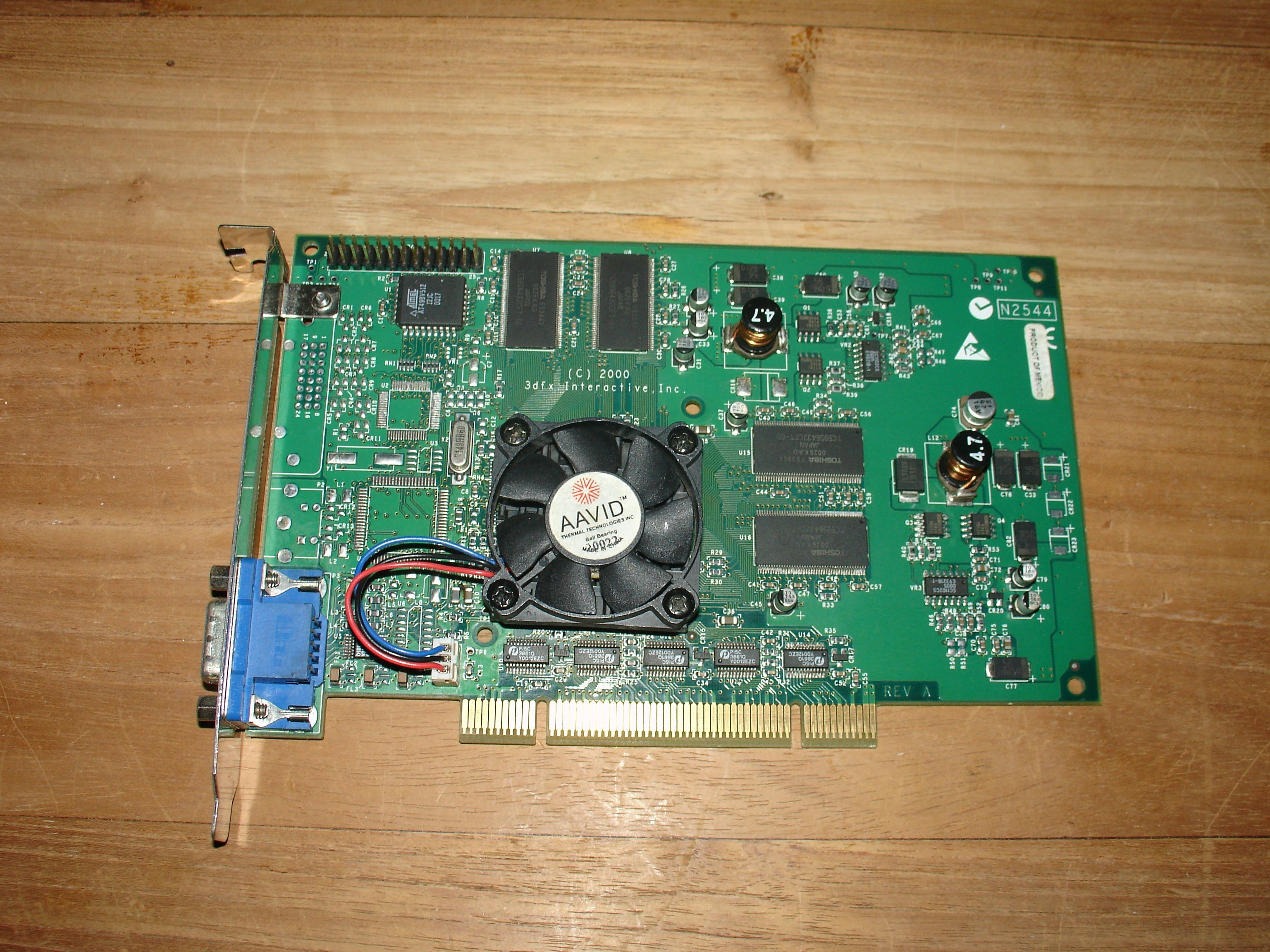

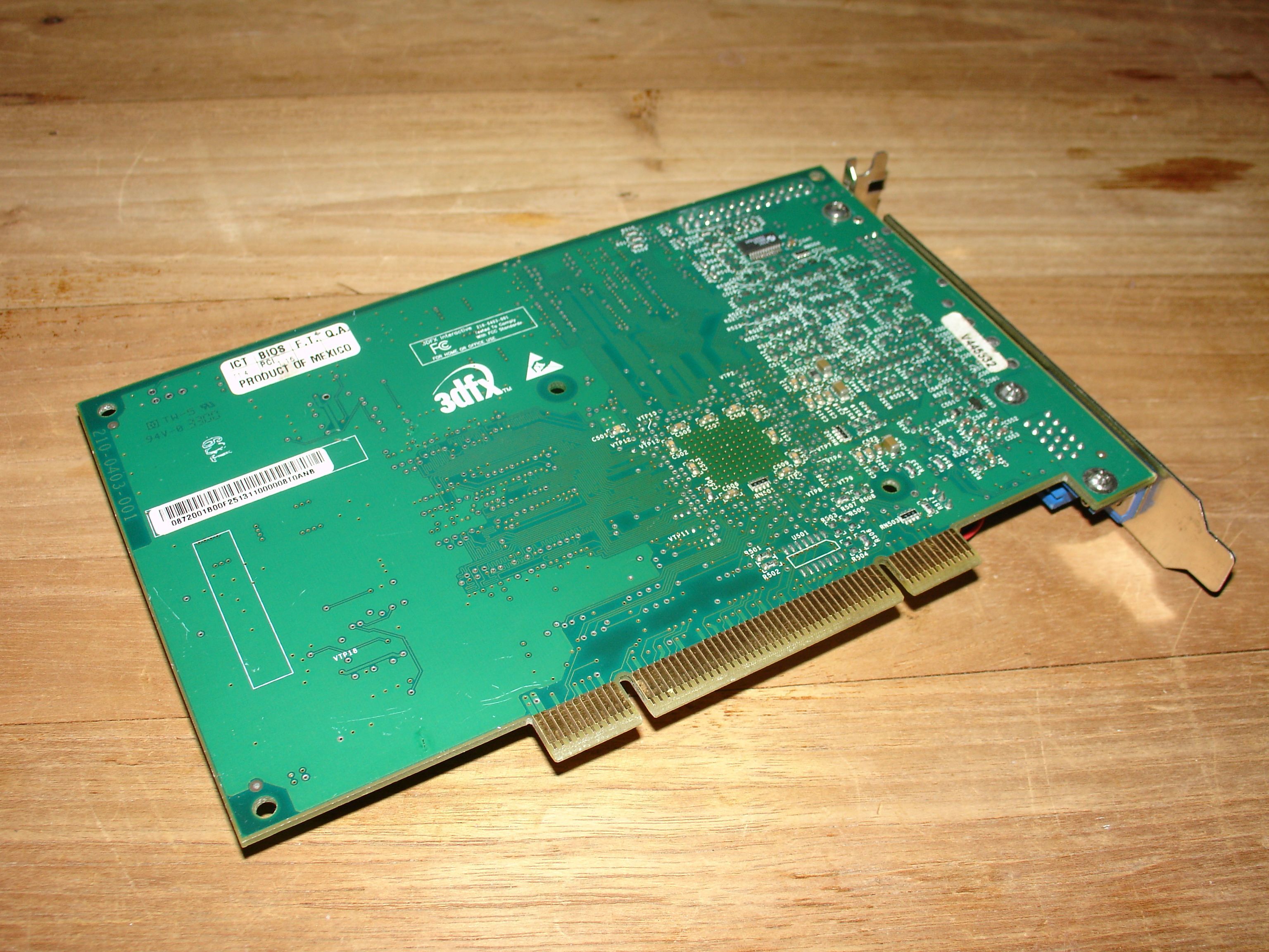

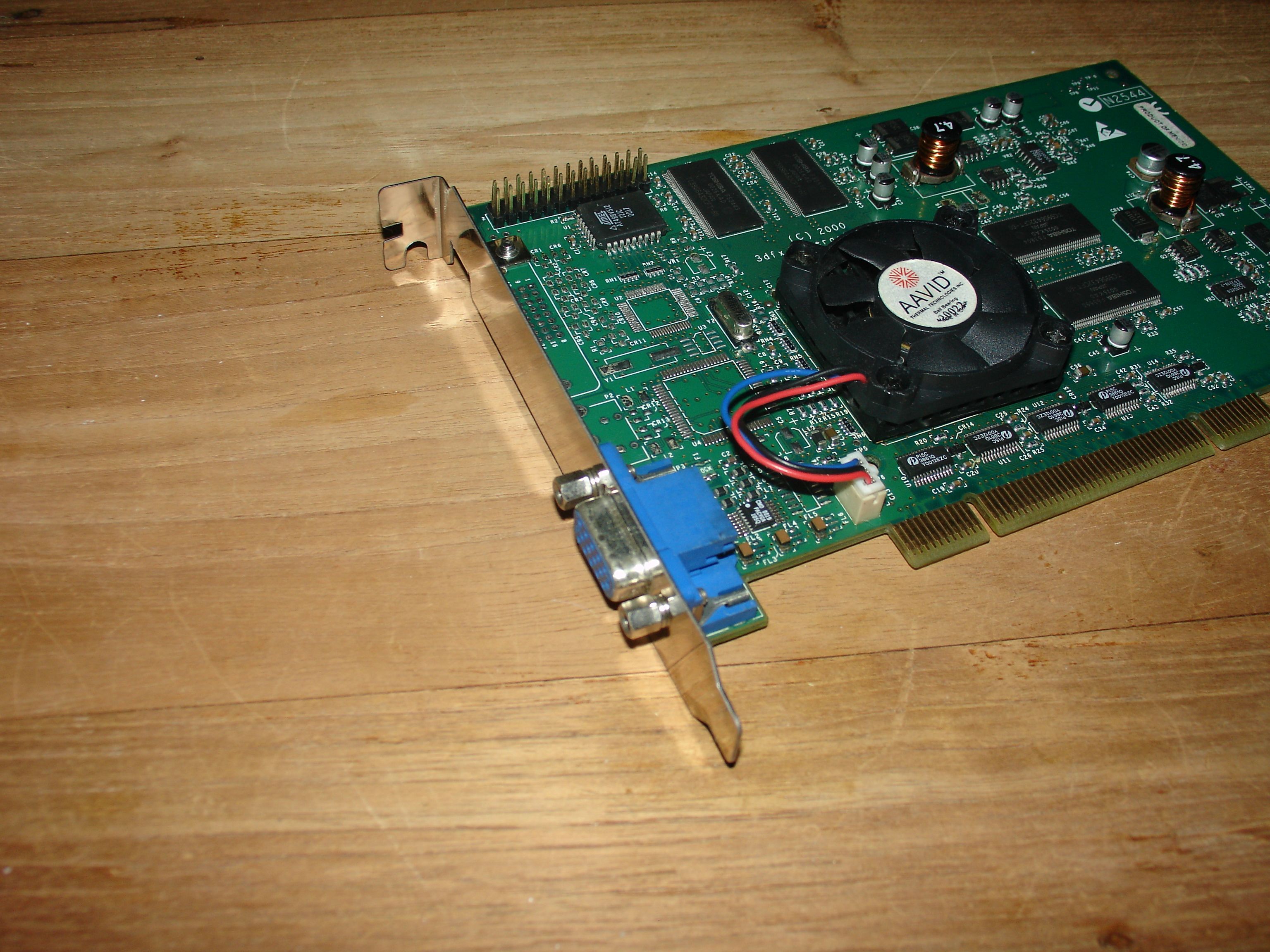

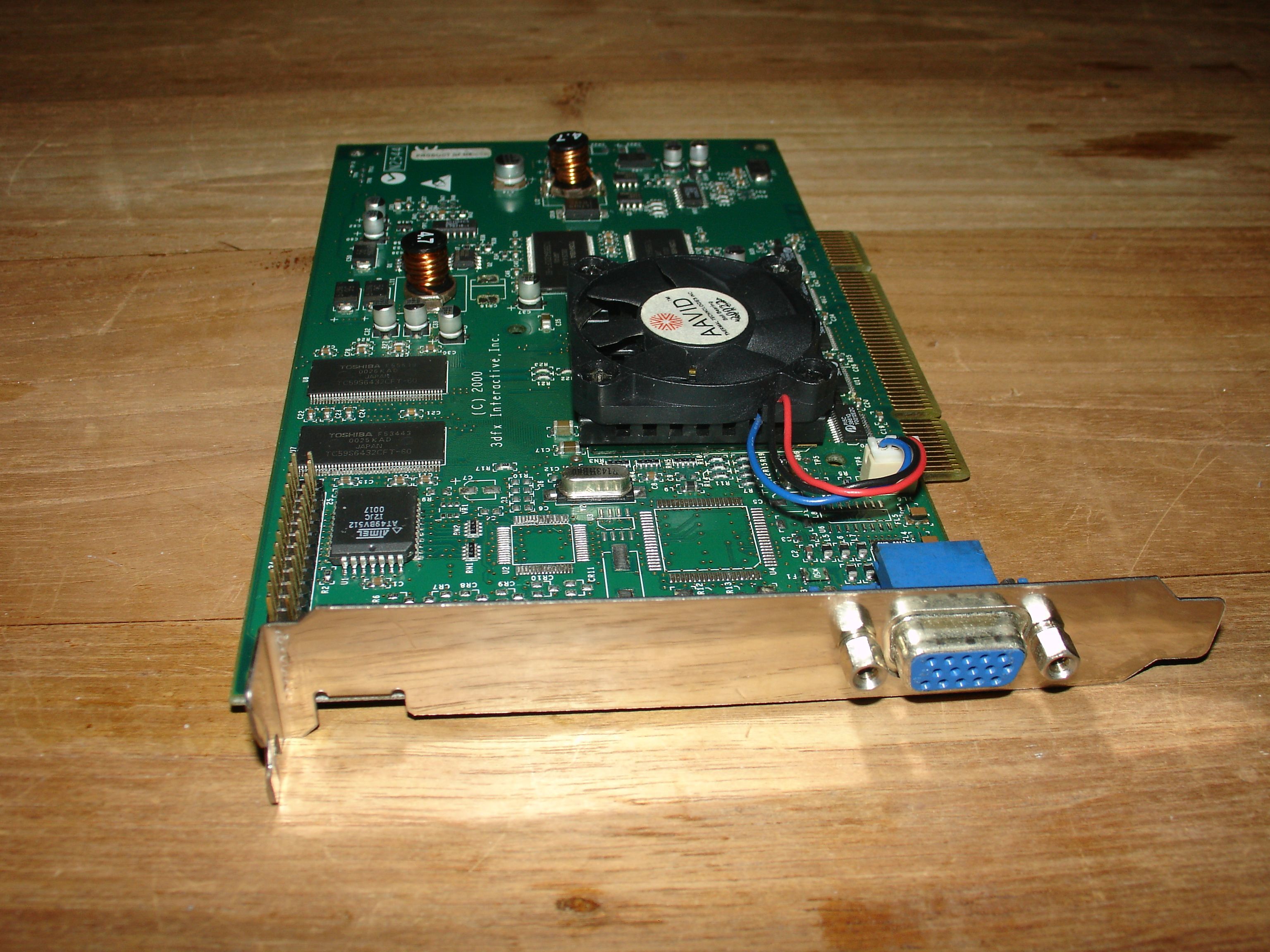

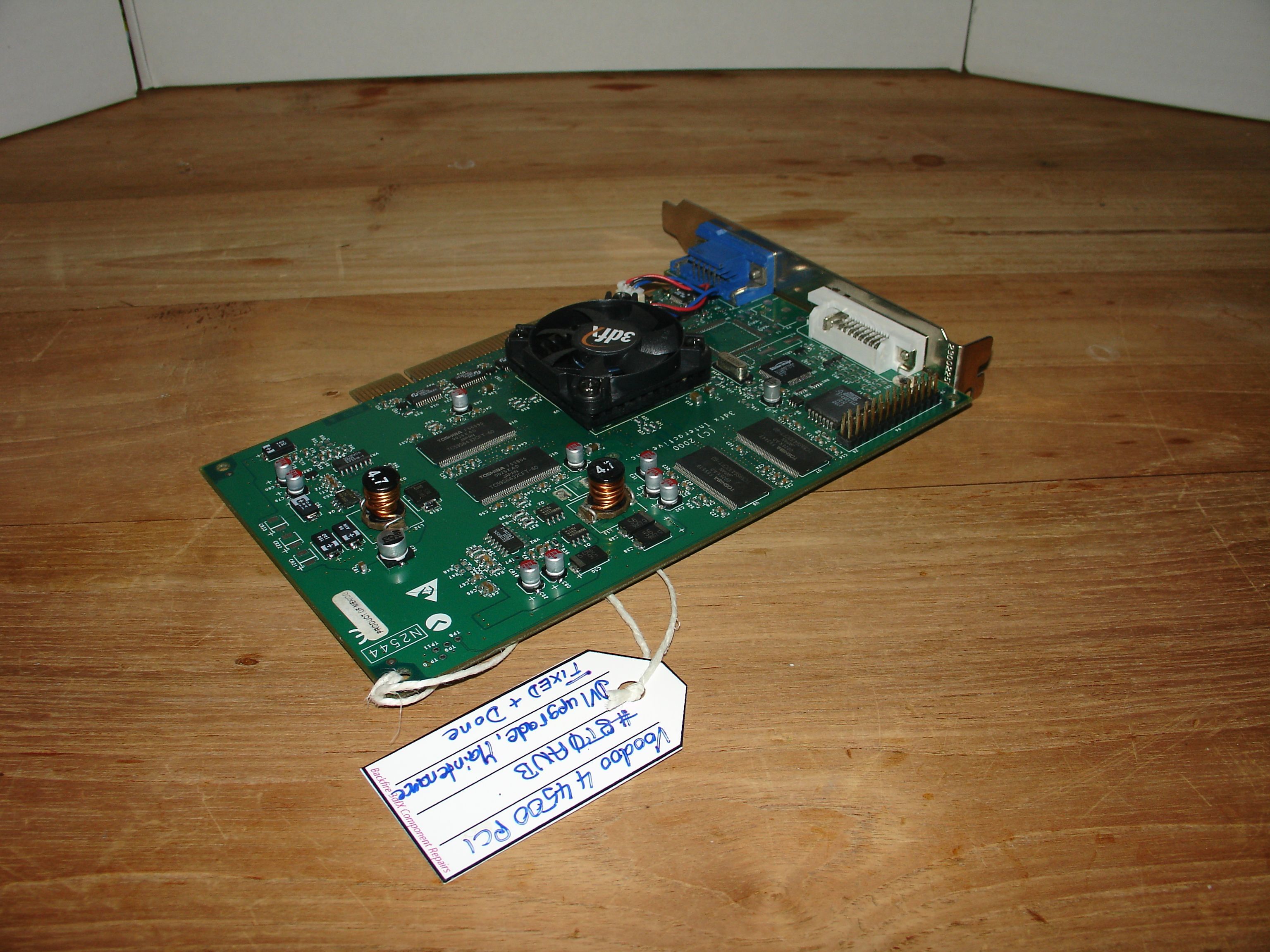

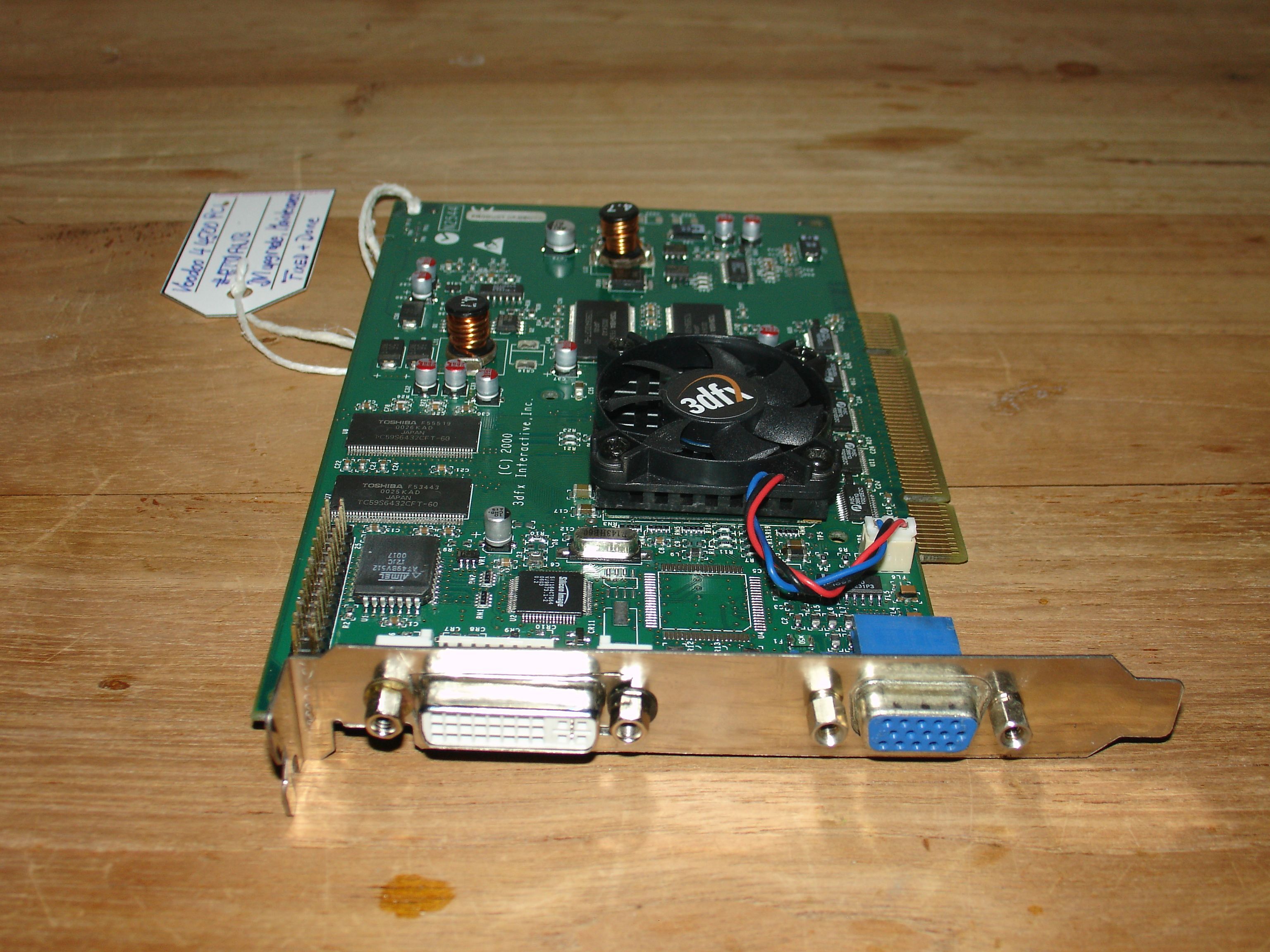

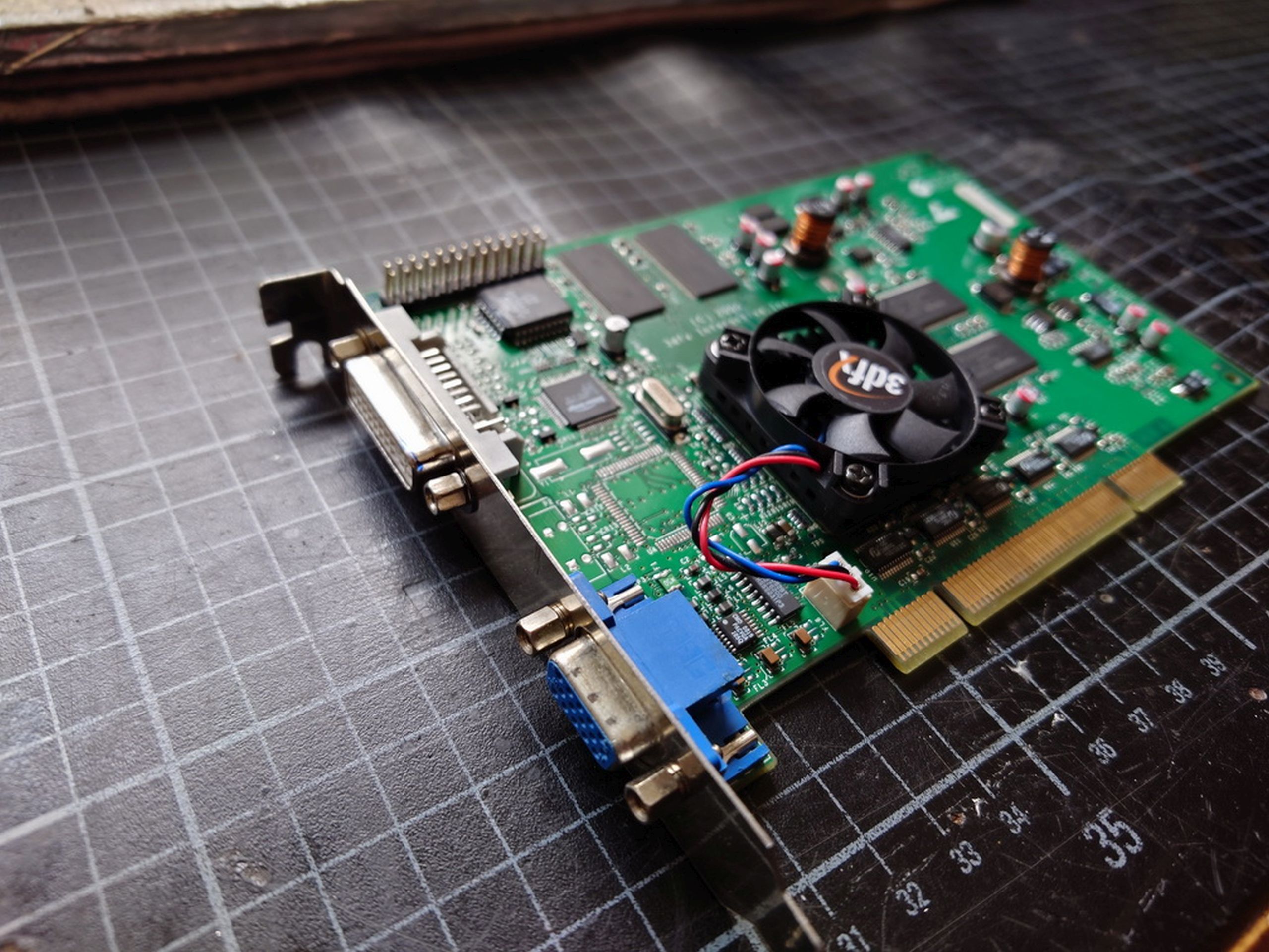

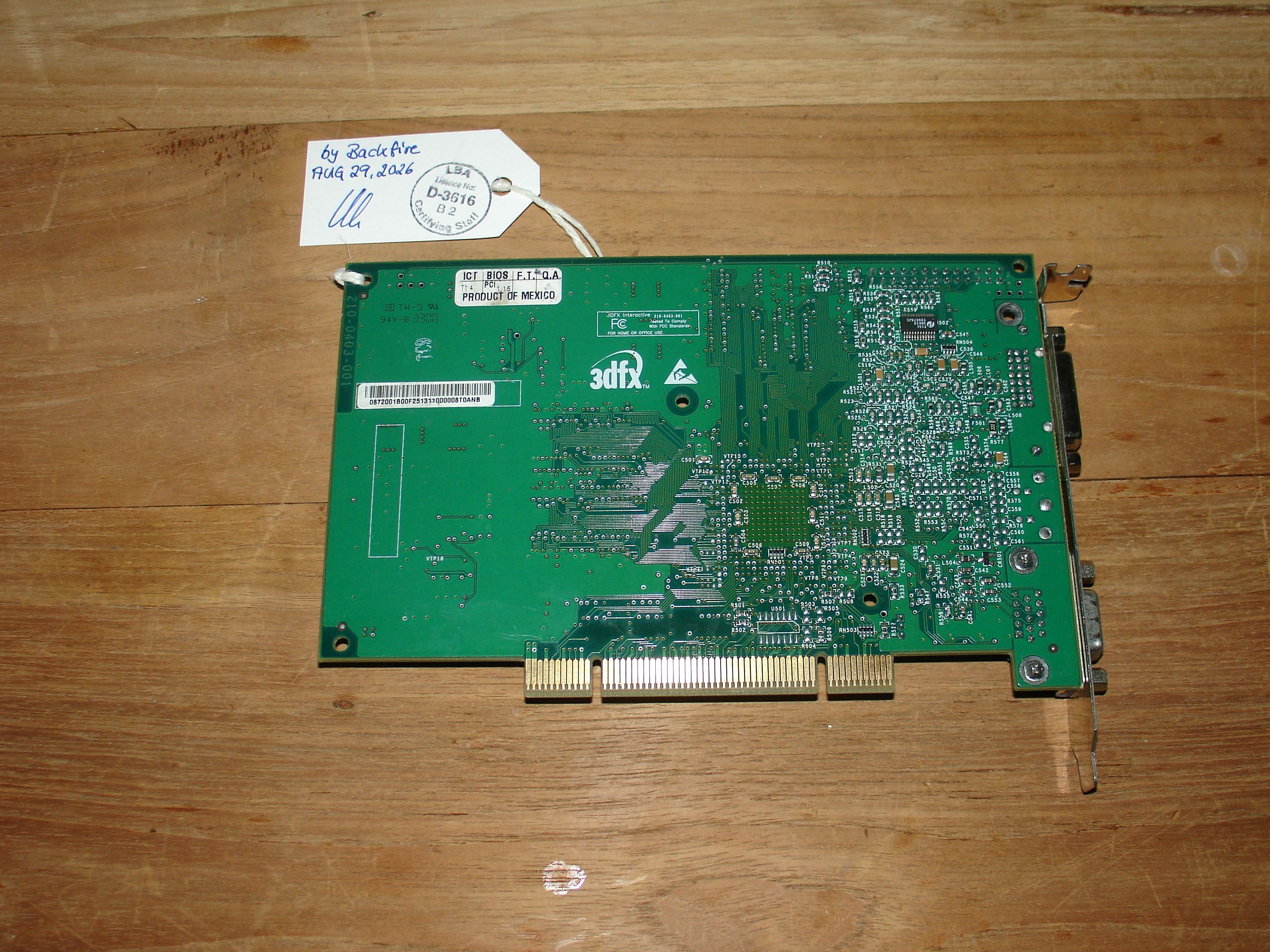

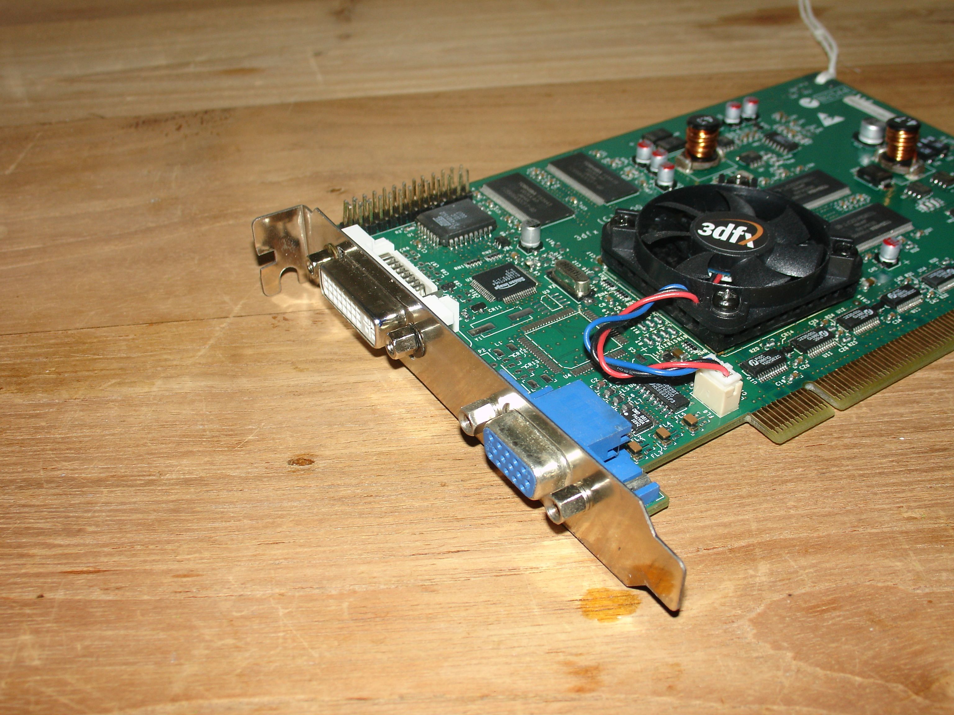

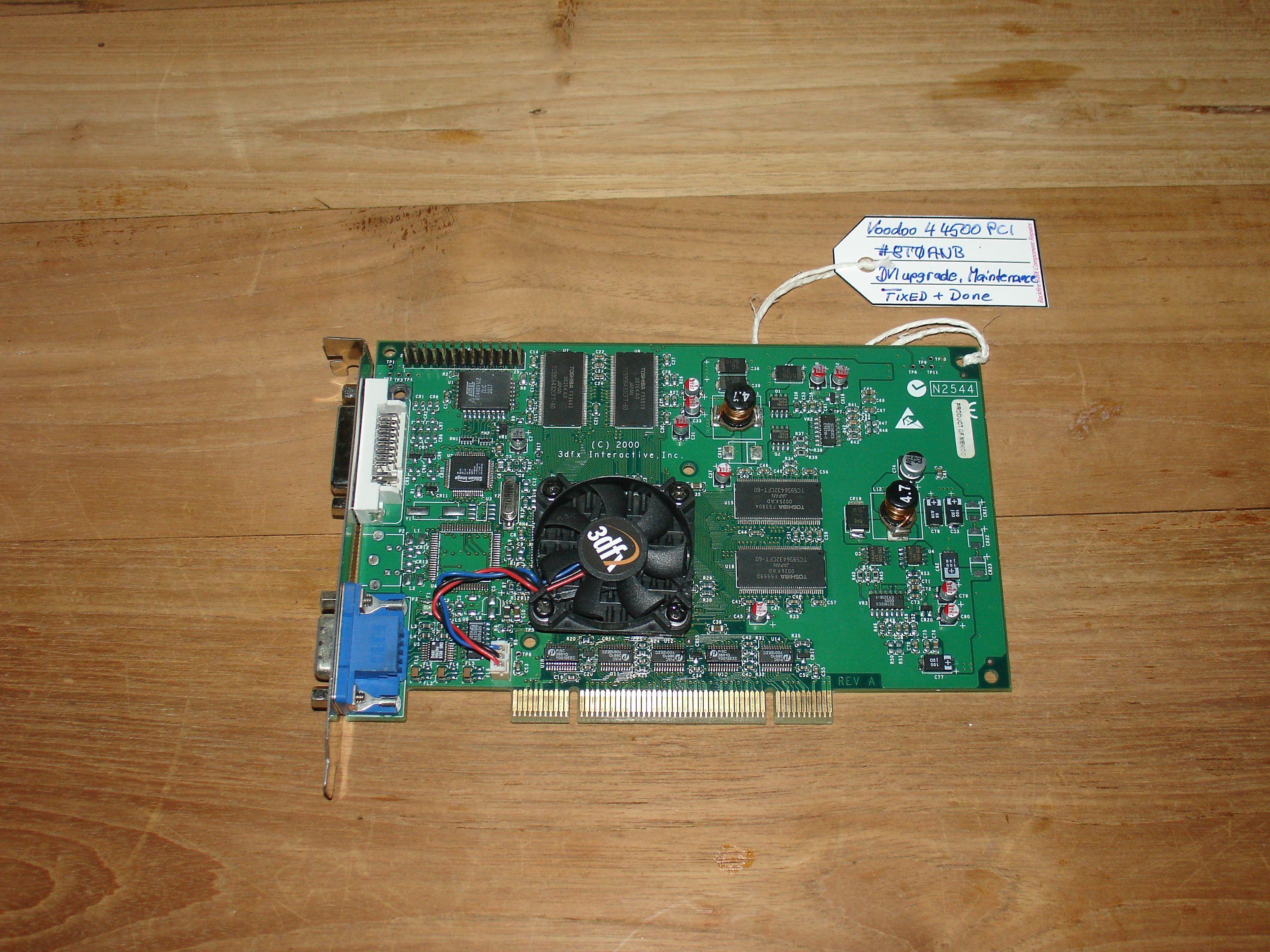

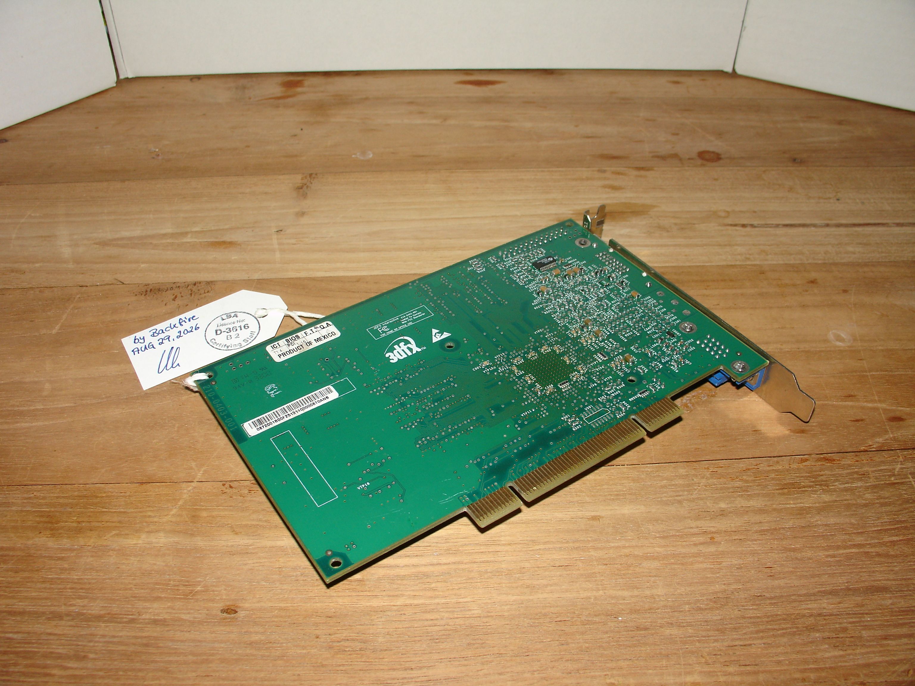

Today the 3dfx Voodoo4 4500 PCI 32MB arrived from Canada!
This card will be sent to Backfire from Voodoo Alert Forums, Germany for the 3dfx Voodoo4 4800 PCI Macintosh Upgrade Project that will be the following improvements:
Upcoming reworks:
01. 64MB 5ns Etron Technology 128Bit SDRAM
02. Full recap with Würth Polymer Capacitors
03. Full Solder reflow
04. DVI-I will be added for Flat Panel support
05. Custom made Retention PLate that adds a DVI support hole alongside the D-Sub VGA support hole.
06. Bios Updated to 3dfx Voodoo4 4800 PCI Macintosh by Backfire reading out a total memory of 65536KB
07. New High Quality Industrial 7000 rpm Fan & improved heatsink
3dfx Voodoo4 4500 PCI 32MB 128Bit SDR Rev.A 3300
This card was made during week 33, of year 2000.
This card will be the secondary graphics card as the 3dfx option in my Dual Pentium !!!/EB 1000Mhz Build.
Tomorrow on July 01,2026 I will ship this card to Backfire in Ronnenberg, Germany for the 3dfx Voodoo4 4800 PCI Macintosh Upgrade Project, once it returns I will make new photo's of it and show you this piece of beauty in action, from a production Voodoo4 4500 PCI to a Modified Engineering Sample of a Voodoo4 4800 PCI Macintosh a card that never saw daylight.
