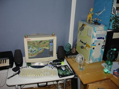

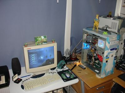

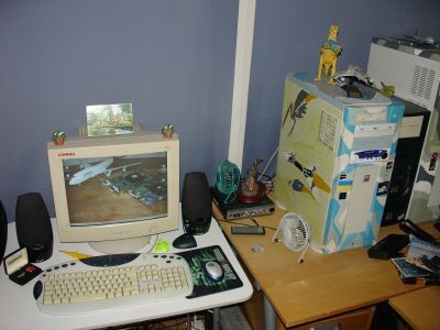

Anyways back to it, here are all my retro PC's as of how it looks like at the moment and what I use them for also revealing their inner parts aka PC guts as some would refer them as, ya get the idea.
This is the one that I first started working on, on January 24, 2016 to around completing it April 24, of 2020
This build consists of parts from 1998 - 2003, they are all date correct from that five year time line.
And as being a major fan of retro PC's in perspective, mainly the ones AMD had back in the day when 3dfx Interactive was the master of all graphics cards as well especially that over 500+ games used the Glide API it's self, the golden era of PC gaming in that aspect has always kept my mind focused to do rebuilds from this era and relive the games, programs as well as flight simulations from those times with date correct parts from that timeline or mixed timelines with a 5 year difference, as long the setup made sense you were as good as gold.
This is not a cheap thing to do, but it's the one thing that has always kept me going, it is a very worthy challenge to take on to as well and I am sure many of you experience that at a similar level 😎
Mainly by finding the right parts in pristine quality or parts you need to recap or rework with the help of good friends or great contacts that have good knowledge on how to take on such things, people you met and have known for over the past 25 years or so, this is where my life is at all this time.
This is also my main retro system at the moment.

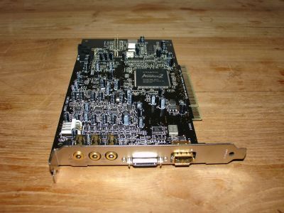

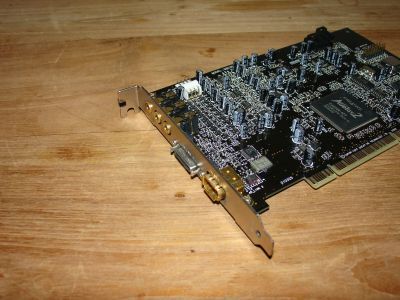

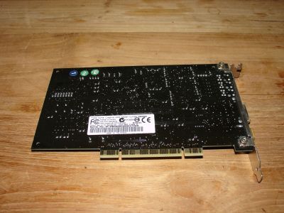

Creative Labs Sound Blaster Audigy2 ZS Platinum Pro SB0360 Rev.A 2703

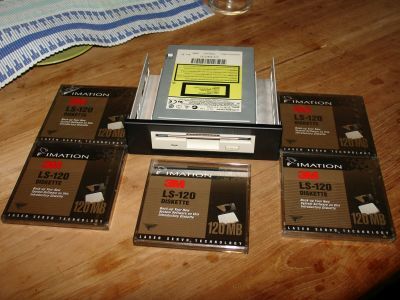

Mitsubishi Electronics LS-120 F200 Super Floppy Drive

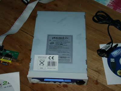

BTO Plusdeck 2c Cassette Tape Convertor/Player/Recorder Drive

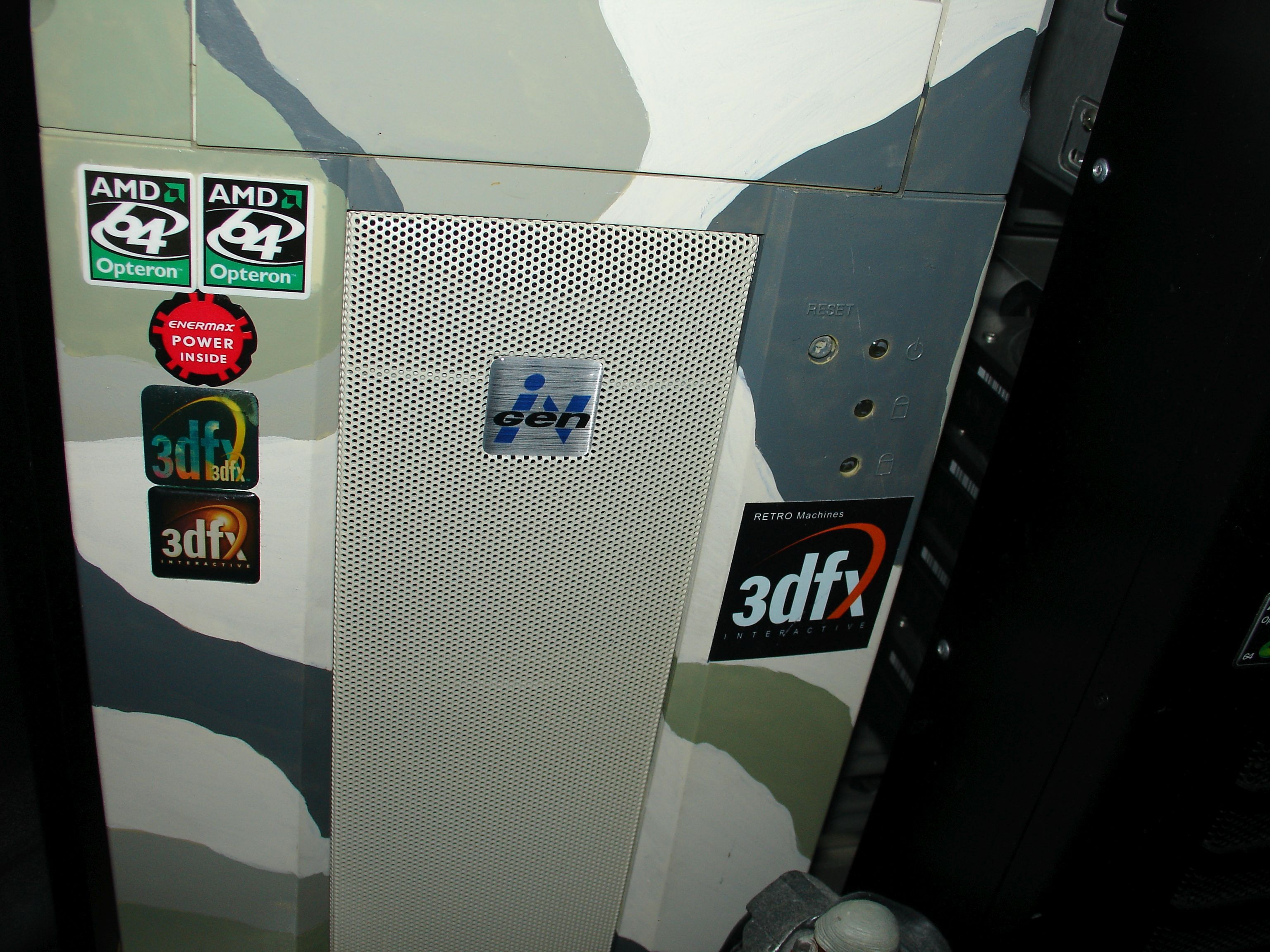

A decal of the flag of Ukraine to respect and support my friends in Ukraine during their current situations

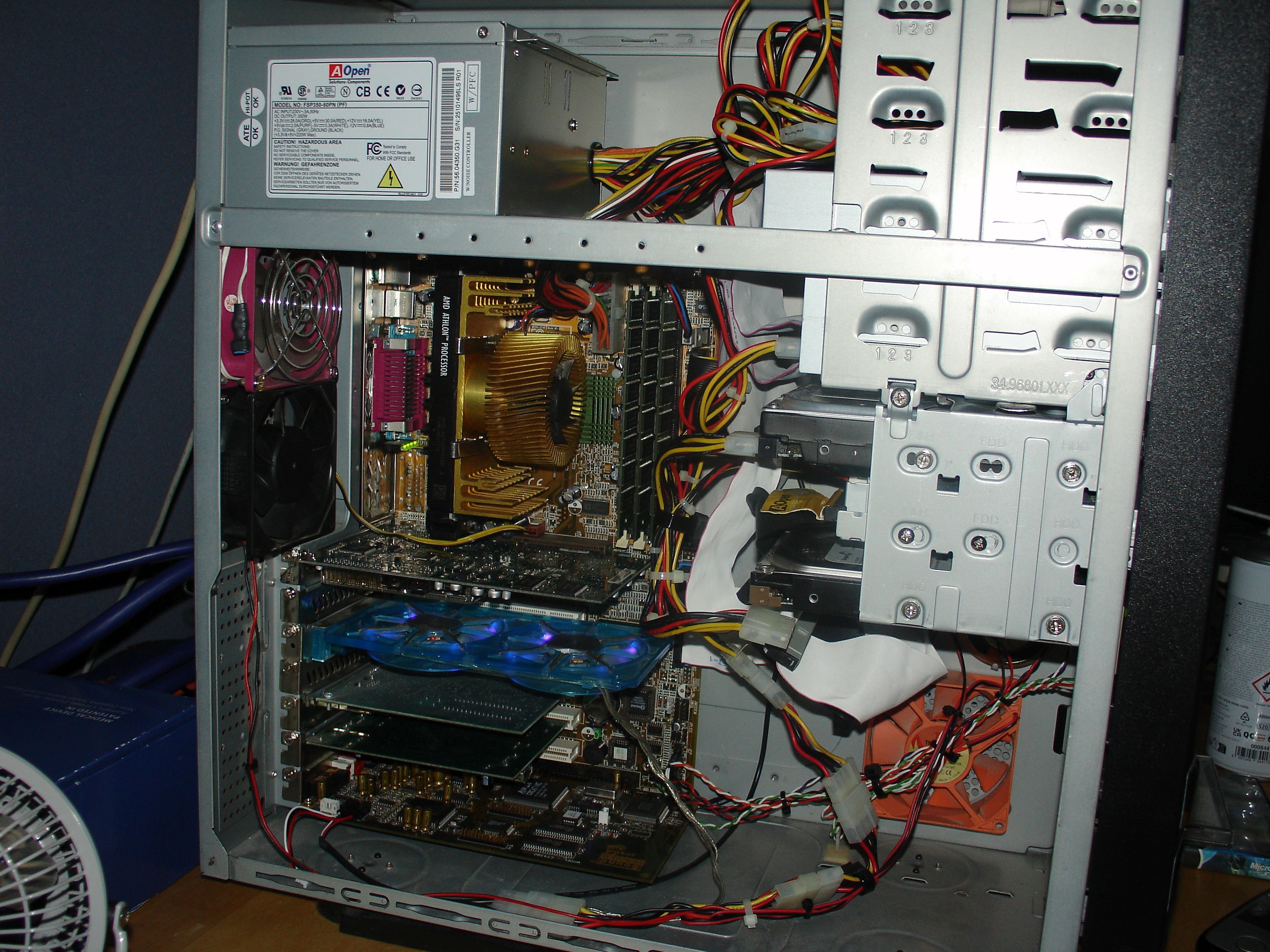

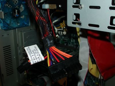

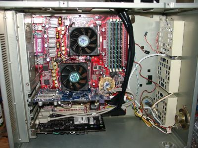

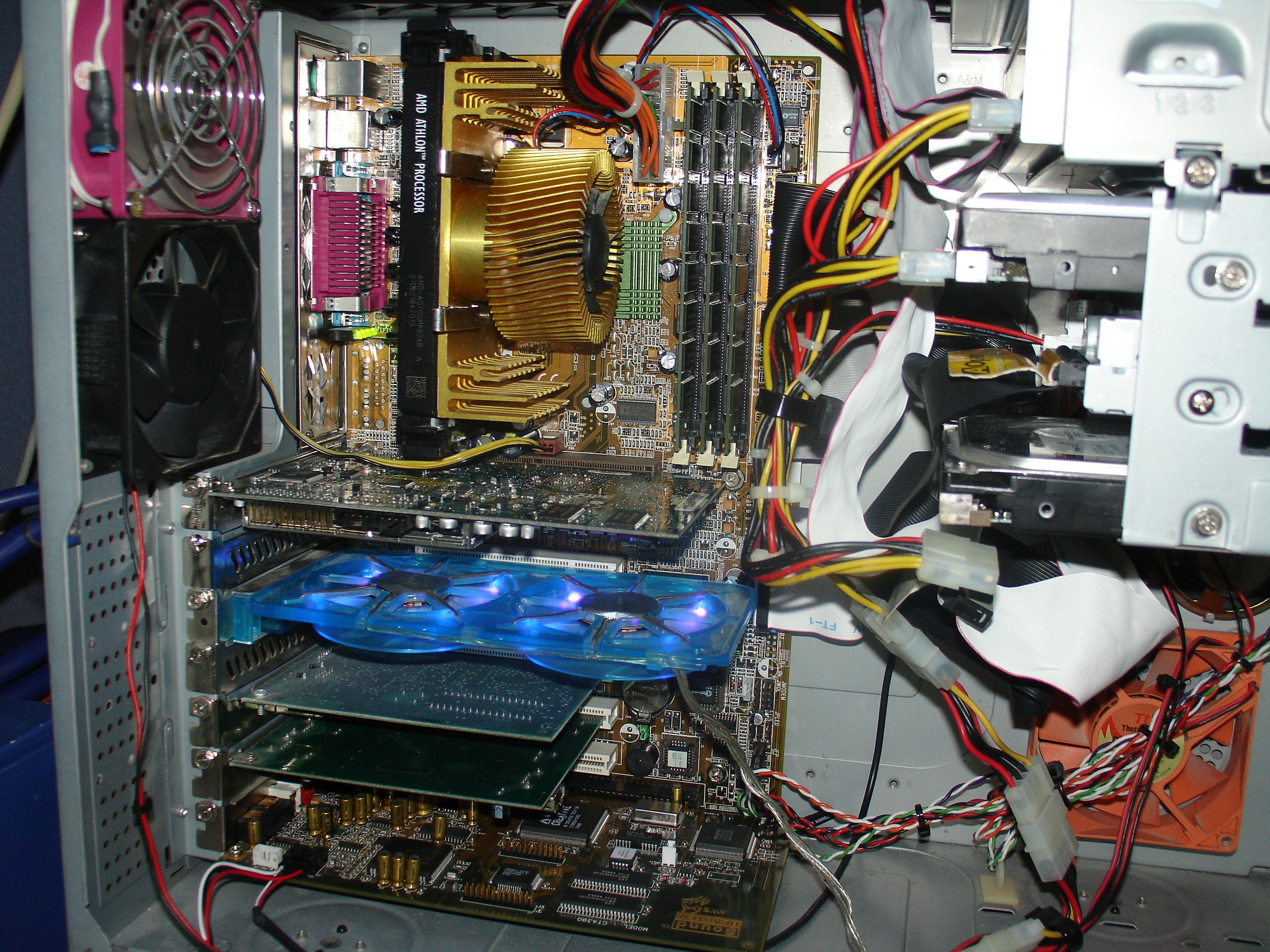

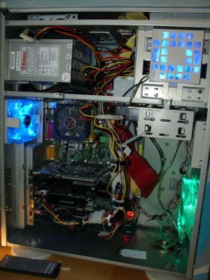

Here it's insides:

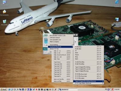

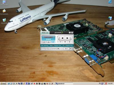

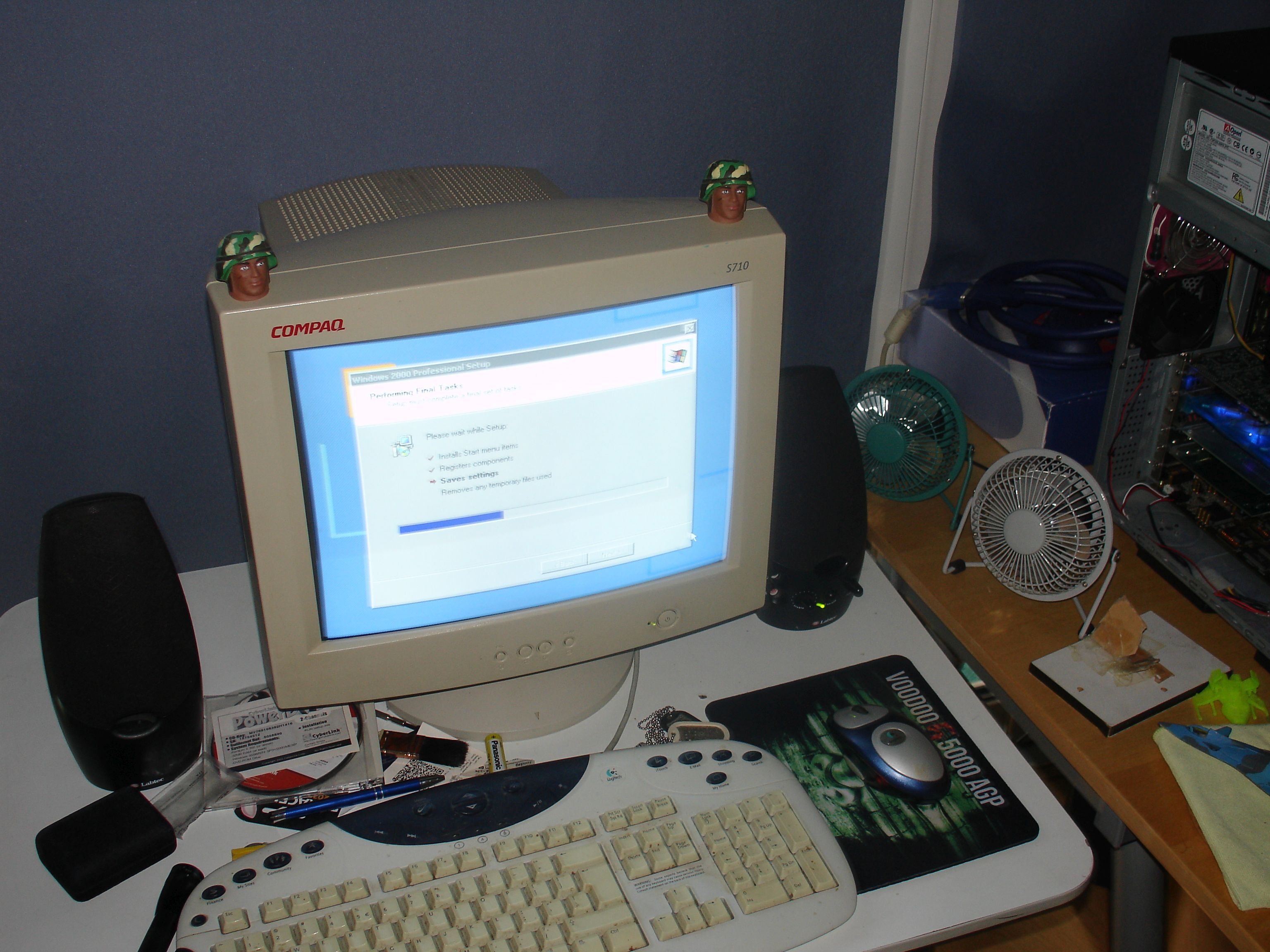

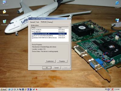

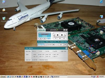

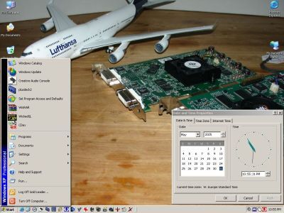

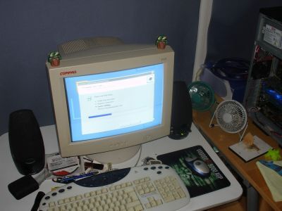

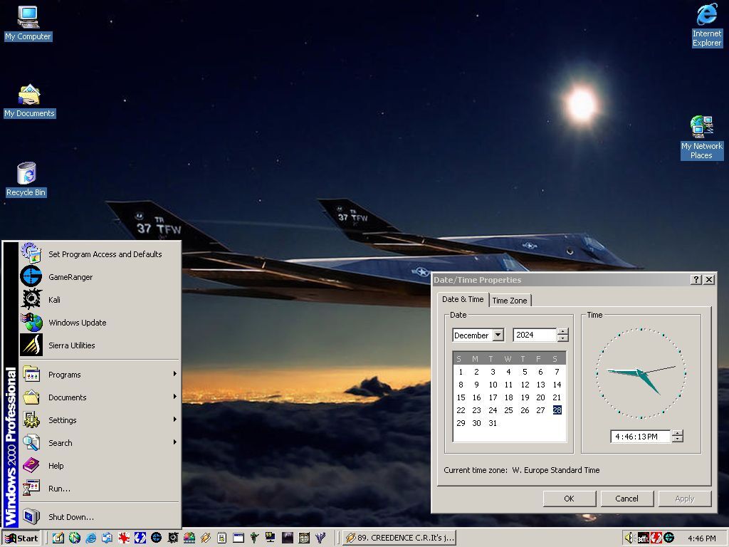

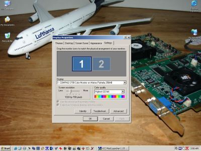

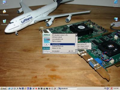

Here the installed parts & Windows XP Pro desktop, that last pic I just made a few minutes ago, as that this is also my main retro gaming/workstation build.

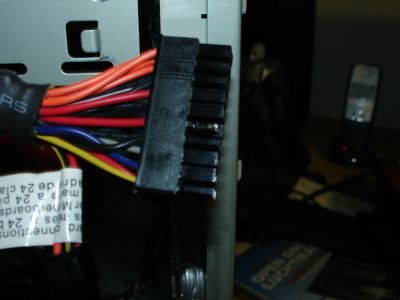

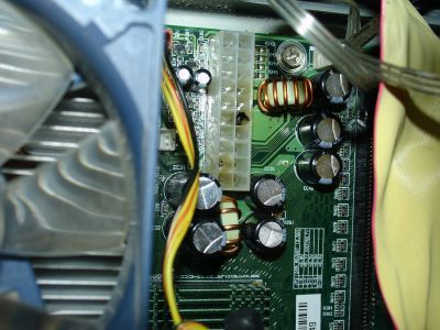

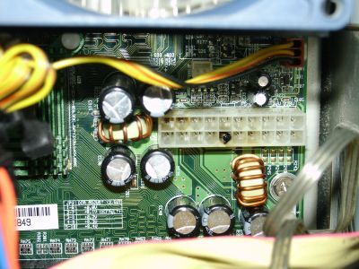

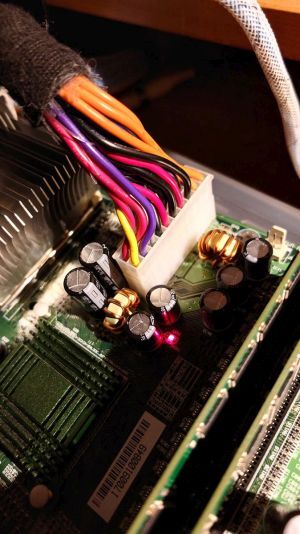

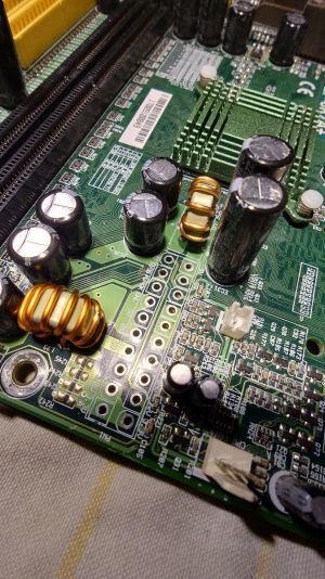

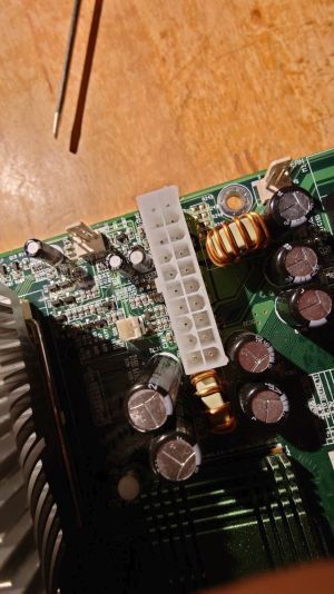

Here the fully recapped with Japan made Panasonic Low ESR Type capacitors plus it's ATX 20 pin connector renewed after a power arc incident with an old Antec True Power 550 Watt Bronze 80+ rated PSU.
This was all done by my friend Backfire from the Voodoo Alert Forums:
Here the burnt 20pin ATX Power connector from the mainboard and the PSU that was used the EP-8K7A+, the power arc caused this to happen:
Here the photo's Backfire applied when he was removing and replacing thee 20 pin ATX Power connector on the board:

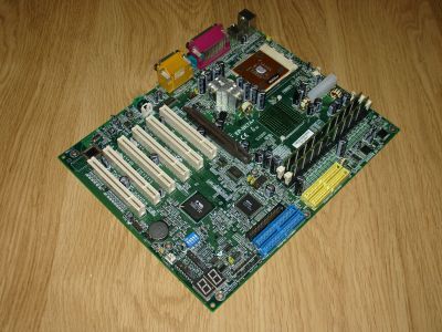

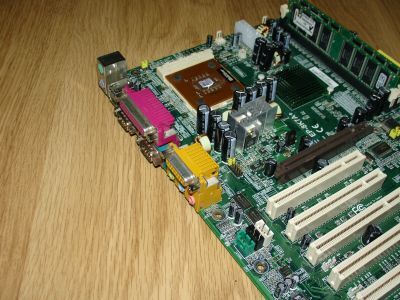

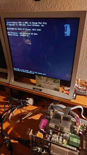

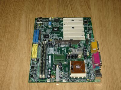

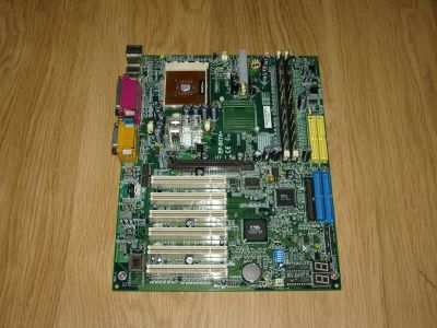

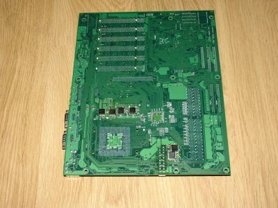

EPoX EP-8K7A+ Rev.A 0148-3 with an AMD AthlonXP 2200+ Thoroughbred-A CPU @ 1.8Ghz
& 2x 1GB PC-2700 matched set HP/Micron @ Single Channel PC-2100 / DDR 266Mhz @ CL2 .
This mainboard was made in year 2001, during week 28 on the 3rd day of that week as the PCB Date clearly describes 0128-3
Backfire has over 48 years of electro engineering experience and he works for TUI Airways maintaining the APU's & Jet Engines of their B737 NG fleet, he has done this for the past 28 years, he has always been my go to guy if something with precision and care had to be done like a recap or repairing 3dfx graphics cards etc, he has repaired well over 200 Voodoo5 cards stand alone where of 20 were 3dfx Voodoo5 6000 engineering samples of all six revisions.

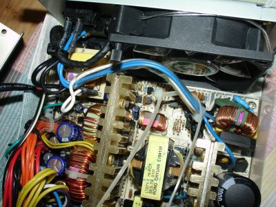

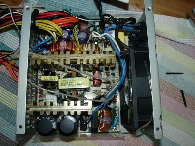

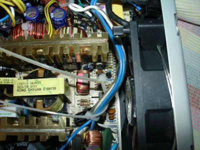

Here the PSU of this build that Backfire also recapped by using Japan made Panasonic & Germany made KEMET capacitors;
Enermax EG465P-VE 460 Watt PSU

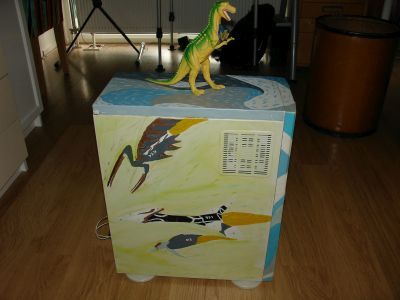

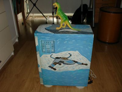

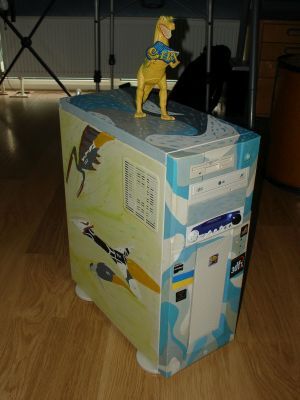

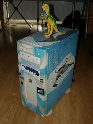

Here the Mascot of this system that I named Reggy, it's my T.rex toy from 1985 which I used to call "Little Rex" back then, I just found Reggy a more fitted name after my best RL friends calls Trex' s as Reggies 🤣, so that kind came out both ways, it holds an original EPoX Logo from 1999; I kinda gave it a purpose again this way
The art on this case I self painted on November 27, 1999:
Left side the main starfighter from the game Descent2:
Pyro GX
Right side; two starships and one starfighter from Freespace2:
Shevan Strike Cruiser
Vesudan Strike Dreadnaught
Terrain Hercules Mark III Heavy Strike Fighter

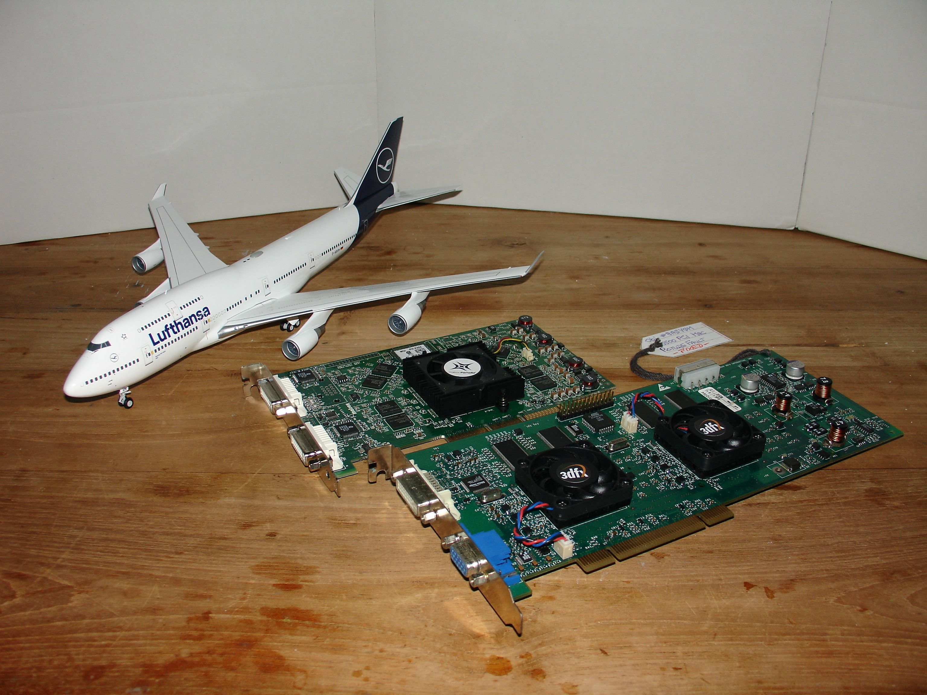

This part will be about the graphics cards used in this main retro build a Matrox Parhelia AGP 256MB DDR and a PC flashed Voodoo5 55000 PCI Macintosh 64MB SDR and a lot of photo's and screenshots will be displayed in this post, just literally revealing everything these cards are capable of doing and how they work as well in the best optimal ways and it's nice to share with you guys here that also may have these cards.
Graphics cards have always inspire me and my Autism goes all balls to the wall when it's especially about graphics cards, good lord of the Force!

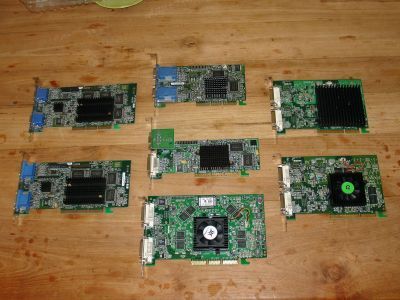

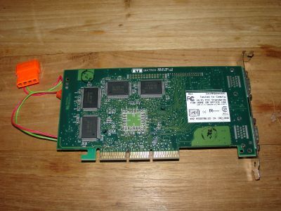

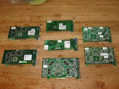

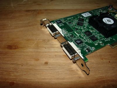

So here to begin with is the main graphics card of this build; the Matrox Parhelia AGP 256MB DDR; this is a Universal AGP 2.0 x4/x8 model of the Parhelia AGP 256MB DDR, this was a gift from a Matrox Employee from Matrox HQ for the EU market, he told me only 1500 of these were made and the much more common AGP 3.0 x8 model went by the millions from 2003 right on down to 2008.
He had asked me to make an offer I was like well let's start at 45 Eur, he was like that is okay by me actually, I'll add an other 6 cards, and for 45 Eur incl first class shipping from Ireland to the Netherlands this is what I got from that kind guy!
Matrox Millennium G400 Dual Head AGP 32MB 128Bit SGR Rev.B 4399
Matrox Millennium G400 Dual Head AGP 32MB 128Bit SGR Rev.B 1800
Matrox Millennium G450 Dual Head AGP 16MB 64Bit DDR SGR Rev.A 4500
Matrox Millennium G550 Dual Head AGP 32MB 64Bit DDR SGR Rev.A 4102
Matrox Parhelia AGP 256MB 256Bit DDR Rev.A 5103
Matrox Parhelia LX P650 AGP 64MB 128Bit DDR Rev.B 4505
Matrox Parhelia LX P750 AGP 64MB 128Bit DDR Rev.B 0905

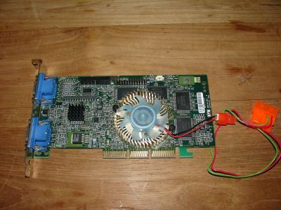

About 6 months later I also got this G400 MAX as a major respected gift from my friend SWZSSR from x-3dfx;
This card is in use in the P3.E 850 Slot 1 build:
Matrox Millennium G400 MAX Dual Head AGP 32MB 128Bit SGR Rev.B 4399 + Soltek Brass Orb

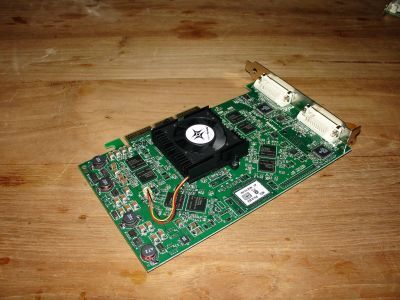

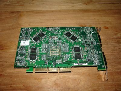

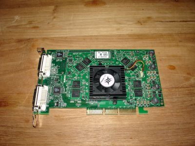

Matrox Parhelia AGP Universal 256MB 256Bit DDR Rev.A 5103

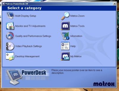

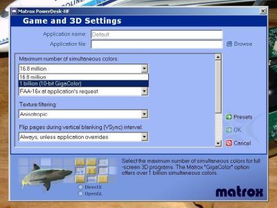

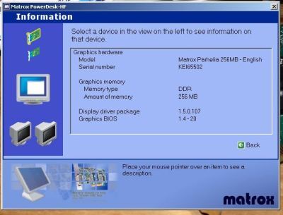

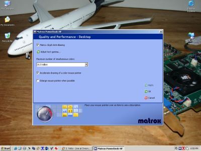

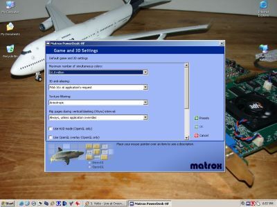

As drivers go for the Parhelia to get the best optimal performance from it but with the most laid out control panel this is what needs to be done to get this to work:
To get this working at it's most optimal performance and speed. I had to tinker with the drivers to get a best of both worlds kind of scenario.
So what I did first was install the September 2003 driver which is Matrox Power Desk 1.5.0.107:
Here the September 2003 driver installed with it's awesome control panel, that to which will come in great handy later on.
Also note it's classic gaming control panel, it doesn't have many options, it's something to do with:

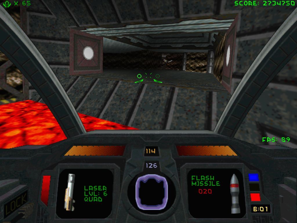

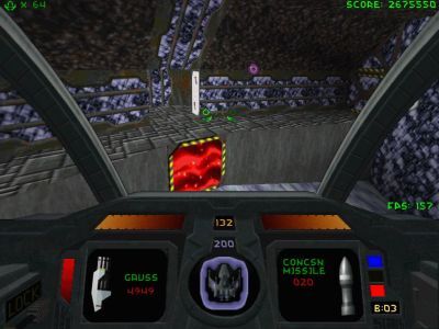

Here the performance of Descent 2 with D2X Rebirth 0.58.1 and D2X Retro 1.3a with the September 2003 driver kit:
Them frame rates aren't too bad right!, But of course I know there can be some improvements here and there, that which you'll see later on in this post 😎
So it was time to make things a lot better! 😁

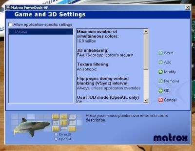

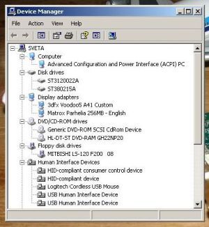

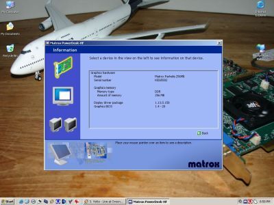

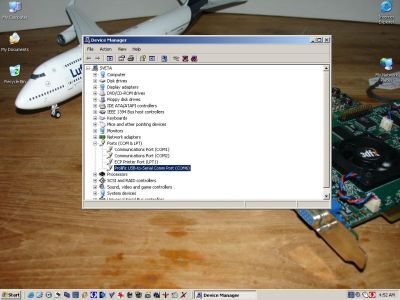

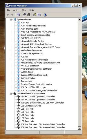

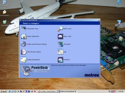

Likewise then I downloaded the May 2007 driver which is Matrox Power Desk 1.13.0.158 and just installed the driver package, more not.
Then I went to the Device manager and updated the WDM drivers of the Parhelia AGP 256MB then did a reboot and this gave me the control panel from the September 2003 driverkit as well as the most up to date gaming performance WDM driver kit from May 2007!
This also gave me a lot more OpenGL options in the control panel as well, as with the later control panel all the gaming options were removed, so this little workaround did wonders and I also helped others with this ideal little solution of mine 😀
Here the info tab of the May 2007 driver
Here the May 2007 WDM driver with the September 2003 control panel combined, for the card it's self this is a best of both worlds solution:
Here the performance of Descent 2 with D2X Rebirth 0.58.1 and D2X Retro 1.3a with the May 2007 driver kit:
So nice gains here and there for both drivers I used the following settings:
Max in game settings with Super Sampled Rotated grid FSAA x4 + AF x2 from the Matrox Power Desk control panel.

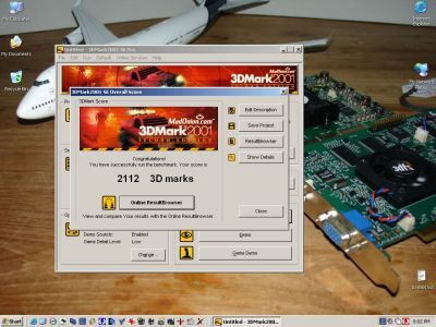

Here two 3-way runs I did of 3D Mark 2001ASE Build 330 with the Parhelia AGP 256MB DDR with the May 2007 WDM & September 2003 Control panel and the V5 PCI Mac using the SFFT Alpha 41 driver modified by ps47 & myself:

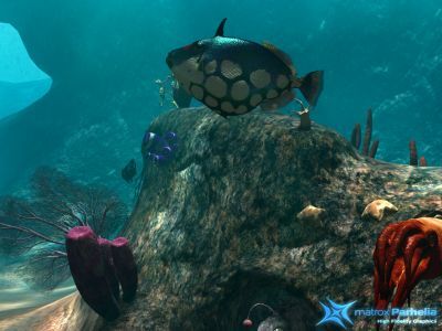

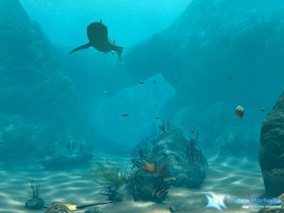

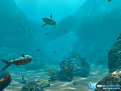

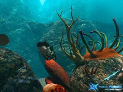

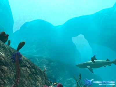

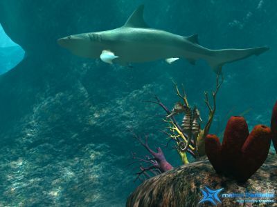

Here the Parhelia running the famous Matrox Parhelia Reef Demo version 1.1

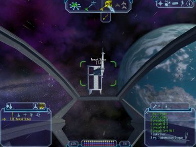

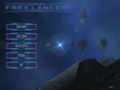

Here some other games I ran with the Parhelia:

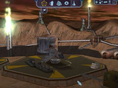

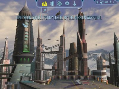

Freelancer by Digital Anvil & Microsoft which was released on March 04, 2003 in the US & April 11, 2003 in the EU
This game gets the max out of the Parhelia P512 GPU thanks to Pixel Shader 1.3 for the 3D objects & Vertex Shader 2.0 support for the Nebula's
My Parhelia ran this game @ 1024x768x32 max ingame settings with FAA x16 & AF x2 and it looks glorious!

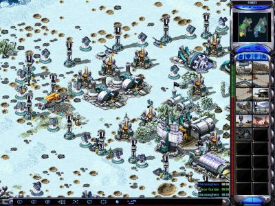

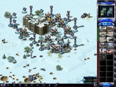

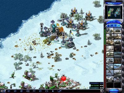

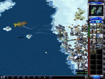

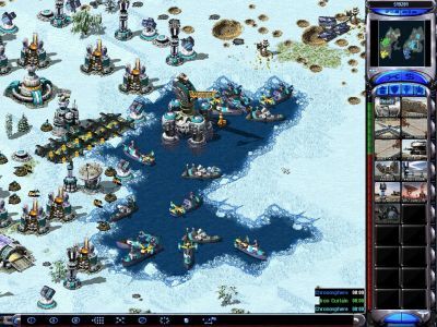

Command & Conquer Red Alert2 which was released on October 25, 2000 in the US and October 27, 2000 in the EU
With Command & Conquer Red Alet 2: Yuri's Revenge by Westwood Studios & EA Games which was released on October 09 2001 in the US & October 19, 2001 in the EU
With Purple Alert Mod 4.10.28 fmade by Marshall Carnis and released on May 02, 2006.

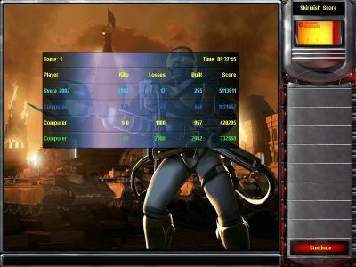

Last pic was the final score of this battle after a game run time of 9 hours 37 minutes and 45 seconds, no crash either.
RA2 is very CPU heavy which makes this the ideal game to use for stability test runs for long term workloads.

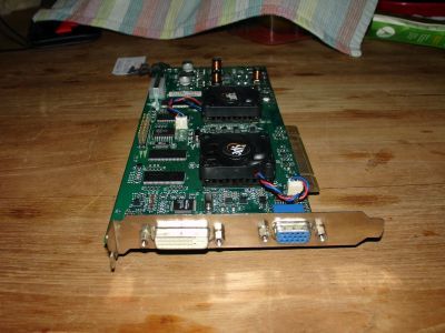

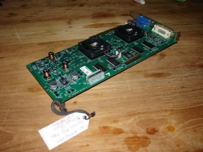

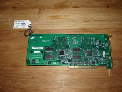

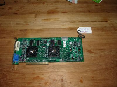

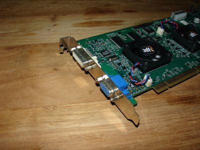

And that is just with the main graphics card, now on with the secondary graphics card the pc flashed Voodoo5 5500 PCI Macintosh 64MB SDR.
This card went through the following nice reworks that were done by two great people from x-3dfx & Voodoo Alert
3dfx Voodoo5 5500 PCI Macintosh 64MB Rev.A1 2900 + PC Bios 1.18_DVI
SWZSSR's friend's Recap & Modifications:
01. Full Polymer Recap
02. Burnt Copper Heatsinks for the VSA's rear side
Backfire's Repairs & Reworks:
01. Renewed Ceramic SMD's on the rear
02. 6ns Hynix VRAM renewal for the main VSA-100 Graphics Chip
03. Renewed Heatsinks & Fans for the VSA's topside
04. Renewed Power Supply Controller Chips
05. Fixed the IC U510 Chip's pins
06. Replaced 4x TSOP-86
07. 6ns Hynix VRAM renewal for the slave VSA-100 Graphics Chip

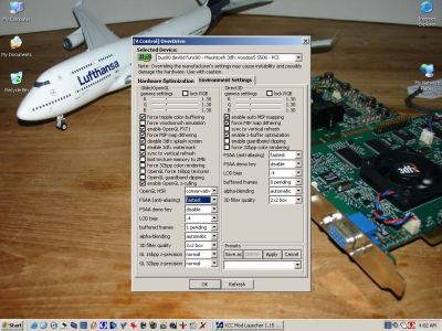

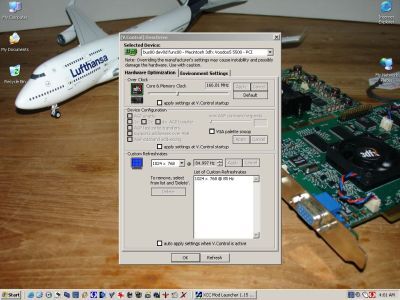

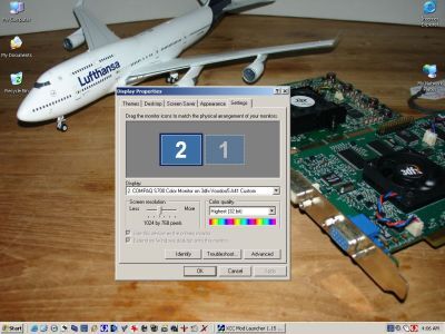

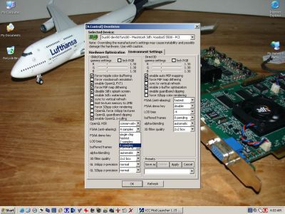

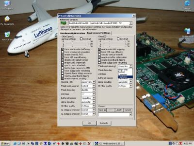

Here the control panel of the V5 PCI Mac that was made by my friend named "KoolSmokey". he from the 3dfx Zone Forums, Italy:
Here the max FSAA setting for both OpenGL/Glide & Direct3D is FSAA x4, hence being a Voodoo5 5500 series of graphics card and by having two 3dfx VSA-100-200 graphics chips:
The Voodoo5 5000 & 5500 series both have two 3dfx VSA-100-200 chips, this makes the max FSAA setting as 4 samples
A Voodoo5 6000 has four chips, those do FSAA x8 as max setting, yet a Voodoo4 4500 only has one VSA-100-220, these only have a max setting of FSAA x2, sae rule goes for the 3dfx Daytona cards named Voodoo4-2 4000/4200 & 4800, all of these do FSAA x2 as max FSAA setting as well.

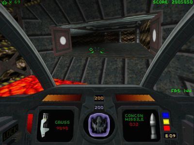

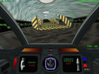

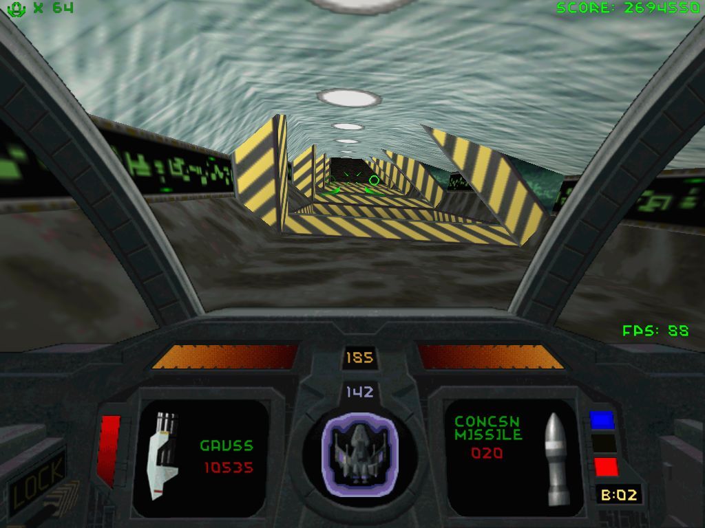

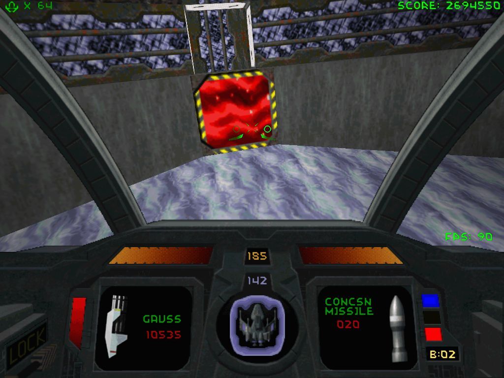

Here that V5 PCI Mac running some games, such as these:

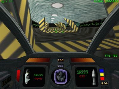

Descent 2 by Parallax Software & Interplay which was released on March 13, 1996 in the US and March 29, 1996 in the EU
Descent 2 is using the mods D2X Rebirth 0.58.1 & D2X Retro 1.3a for improved game play & 3D rendered graphics mode with OpenGL ES 1.2:

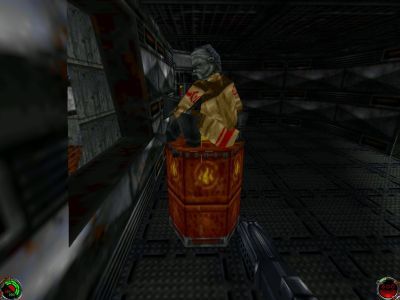

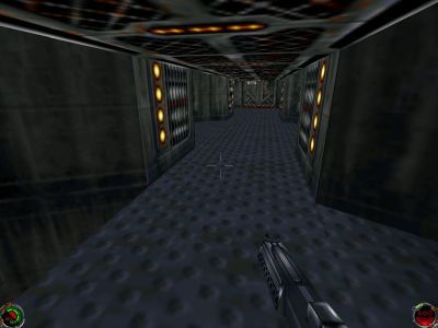

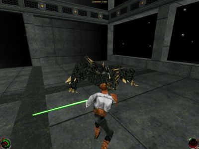

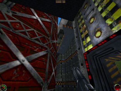

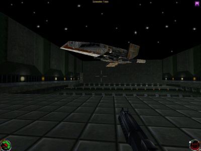

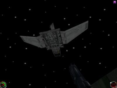

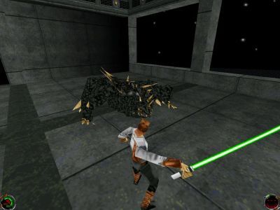

Star Wars Dark Forces II: Jedi Knight by LucasArts which was released on October 09, 1997 in the US & October 17, 1997 in the EU:

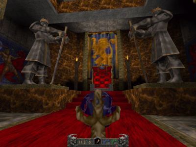

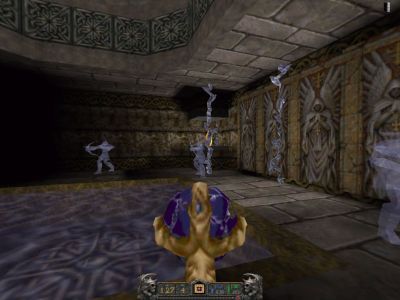

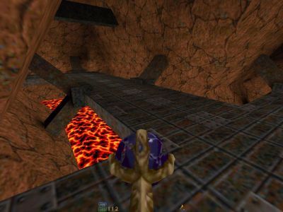

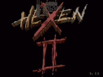

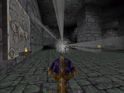

Hexen II 1.11 by id Software & Raven Software which was released on September 11, 1997 in the US & September 17, 1997 in the EU:

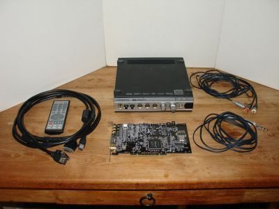

And here the final part 03 of this first retro build, a lot was done as reworks to recaps and other needed renovation methods but all in all it truly did pay off and that all made this system my main retro system it's ideal for gaming but also workstation related tasks, the Audigy2 ZS Platinum Pro is where Part 03 starts off with, read onward!

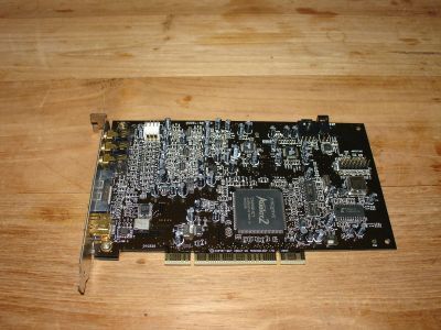

Here the Sound card of this system, also quite a hard one to find, major thanks go to SWZSSR for helping me find one of these fr a nice deal of just 48 Eur / 60 USD which was around 100 AUSD back in the time I bought it which was somewhere in 2018.
Creative Labs Sound Blaster Audigy 2 ZS Platinum Pro SB0360 Rev.A 2703
The card is named the SB0360, the Audigy2 ZS Platinum and other Audigy2 ZS boards carry the board name SB0350 or an even lower number.
The lesser the features, the lower the number.

Here the LS-120 Super disk drive, these have a read/write speed of about the same from that of a 6 speed CD-RW drive, which is very impressive, I also manage to play a 1080p Test video with it and even a 4K Extended Trailer of the Aquaman movie from 2018 which is around 90MB in size in 4K DivX format, the Audigy2 ZS was ideal for the hardware accelerated HD audio acceleration, to get this right I used a 3dfx Voodoo3 3500 TV AGP 16B Rev.A 3199 the one that is used in the AMD K7 Athlon Thunderbird 700Mhz build, to get a fluid motion for the video and perfectly synced audio, OS I used was Windows XP Professional USA + SP3.
This LS-120 drive was a very generous gift from my friend nick named "SadTropher" from the 2CPU forums
Mitsubishi Electronics Australia F200 D0 LS-120 Super Disk Drive

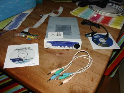

And here the final part which is something you don't see every day either and also rarer than the LS-120 left alone LS-240 drive even being,
This is a Cassette Deck Convertor drive that can also record and play tapes as well, the drive is quite long, because the tapes entire it lengthily wise.
My dad used it to convert all his cassette tapes to 256Kbps MP3, tapes from 1980 - 1990, also the time we lived in Australia.
Back in 2018 he passed it on to me to make good use of in this retro gaming /workstation system.
BTO Plusdeck 2C Cassette Deck Convertor Drive

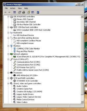

Here the drivers for the Plusdeck 2C and the USB to Comp Port converter dongle, whch can be seen in the device manager as well;
This also indicates that the Plusdeck 2C has been correctly installed:

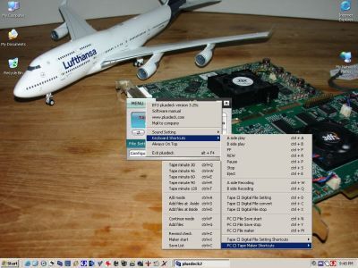

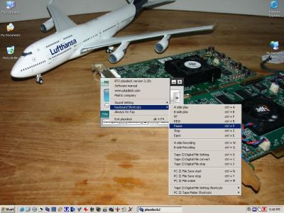

Here the software that comes with it, it works quite well and has tons of options as well, always nice to see put much care to it:

cards were so much bigger back then, look at that to scale with an airliner! 😀
very good tour and pics, can appreciate the painting more now too
and just seeing red alert 2 screenshots makes me want to play it again !

Stay tuned for more though and that Lufthansa Boeing 747-430 is scale 1:200 the Matrox & 3dfx graphics cards are scale 1:1 🤣 xD
Here that wall paper with that Lufthansa B747-430 with the Matrox Parhelia AGP 256MB DDR Rec.A 503 & 3dfx Voodoo5 5500 PCI Macintosh 64MB Rev.A1 2900 + PC Bios 1.18_DVI:

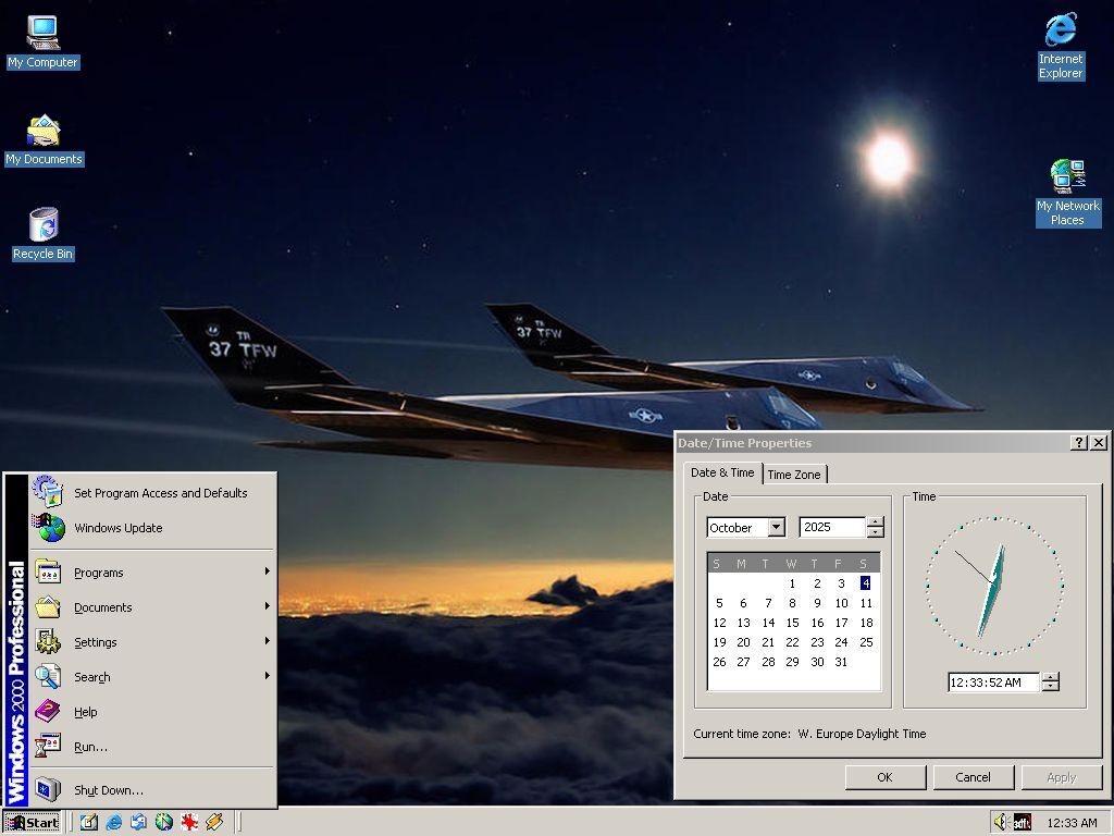

Here the wallpaper I use for the K7 build named Nighthawk, 2nd pic is on the K7 it's self, Win2K Pro + SP4 is always very tempting though, just don't forget o Press F5 during the setup and right it starts up, it's a thing you need to do quickly, then select Standard PC for the installation choice, same goes for WinXP Pro + SP1/2 in such a case.
Night Stalkers by Peter Chilelli

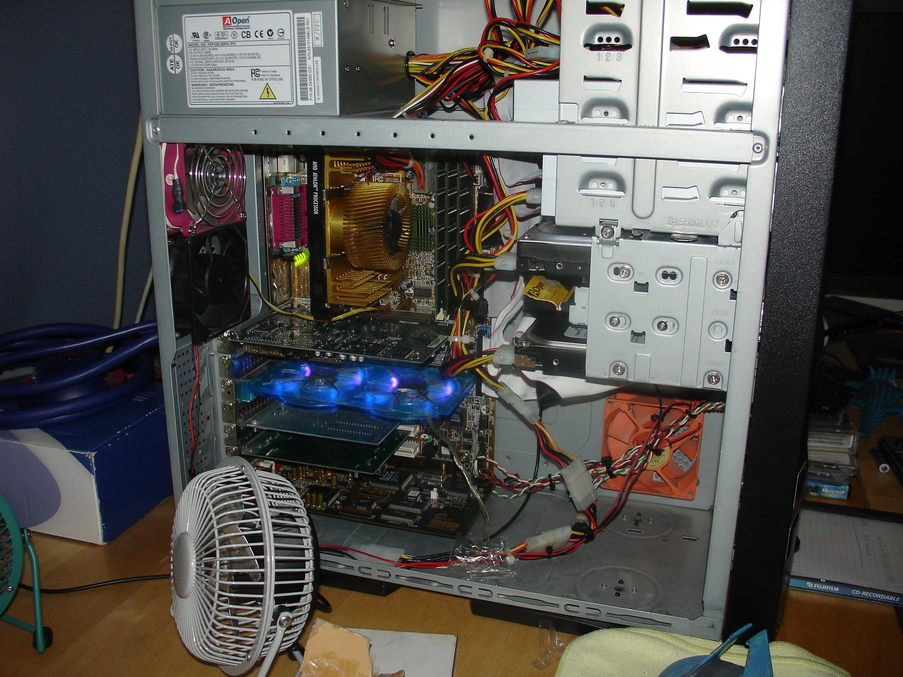

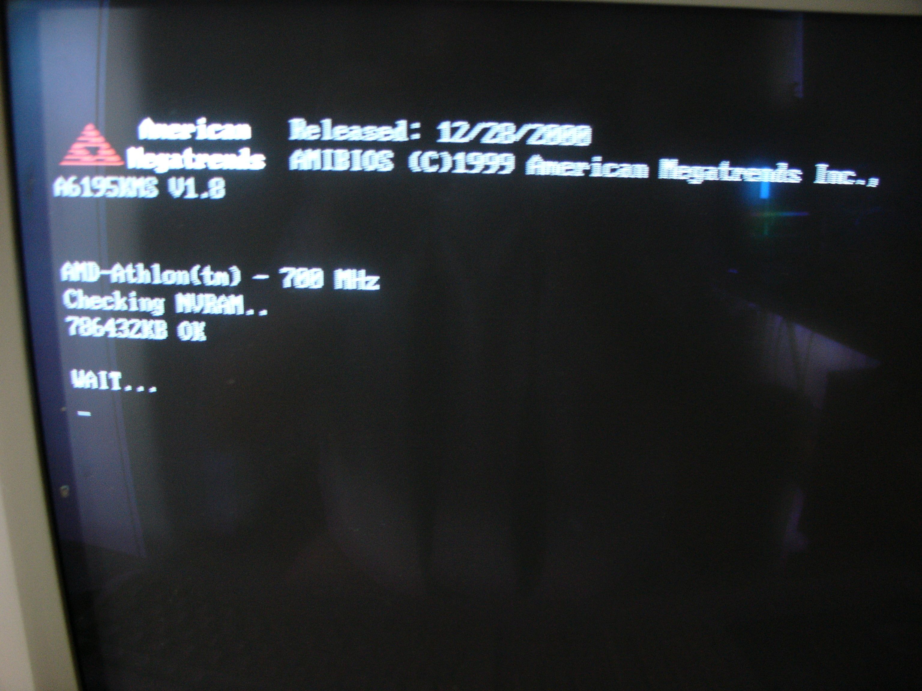

Reply 5 of 61, by Gold Leader-B747

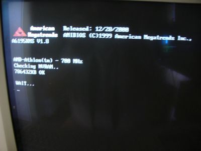

Well I got the K7 Installed with Win2K pro, 98SE was too much of a hassle somehow, also two ram sticks died along the way, luck wasn't much on my side with this one, the new 40GB HDD runs great so that's something, it's playing music atm with Winamp 2.81 + a FLAC file update
I have all components installed, just odd that the system ram doesn't always post or count up during boot, the system does run fine in Win2K and win2K does show that 1x 256MB is installed, yea kind of worried for that.
K7 Slot A Builds are finicky things, the mainboard is the Micro Star International MS9195 K7 Pro, it's capacitors all look fine, it was recapped 2 years ago.
Just weird this morning all three ram sticks worked fine and now I am stuck with one, one is better than nothing, I also refitted the 3dfx Vooodoo3 3500 TV AGP 16MB Rev.A 3199, for this card I ordered one of these:

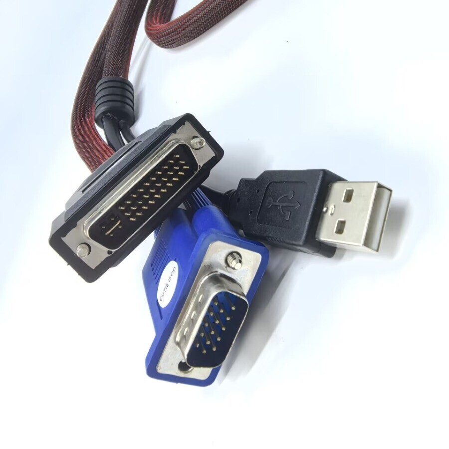

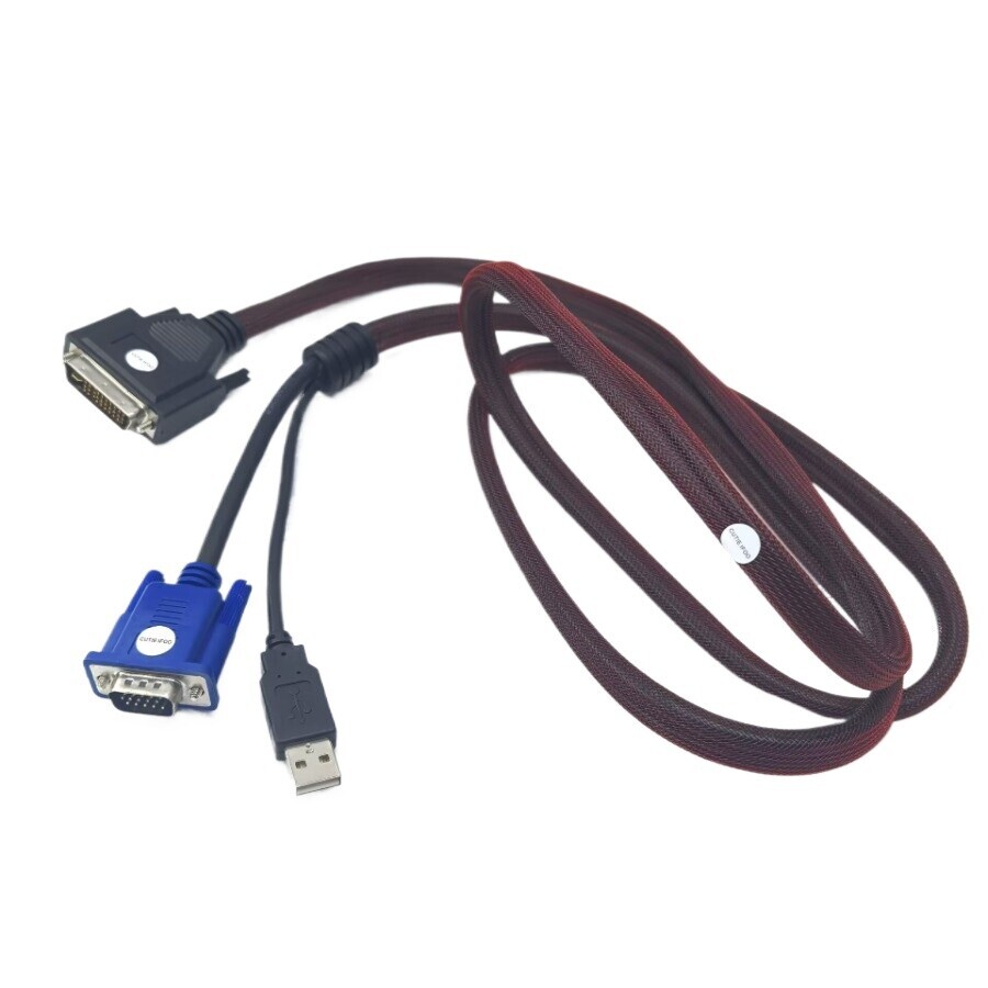

M1-A to VGA convertor cable, this should give the V3 a ton less strain that what it's original pod does give, finding a V3 3500C + TV-Out would be an ideal fix, but this is a more affordable solution, some folks from Voodoo Alert also bought these and they seem to work well for V3 3500 TV AGP cards.
https://www.ebay.ie/itm/387155543843

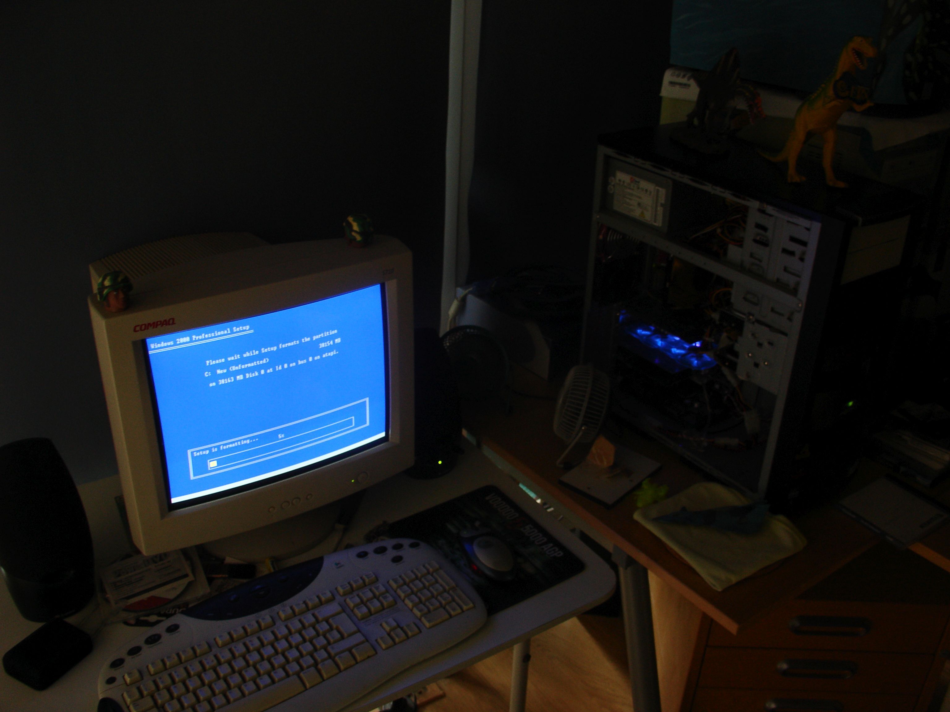

Here the system when I installed the new 40GB HDD and it formatting and installing Win2K Pro, this was before 2 of the 3 ram sticks failed to function, gladly 1 survived.

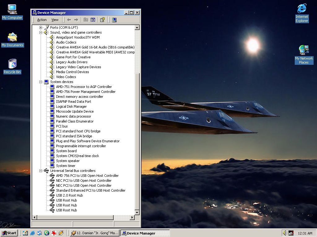

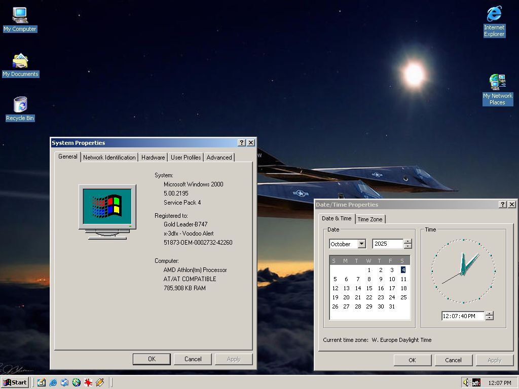

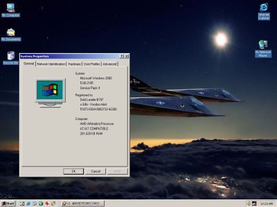

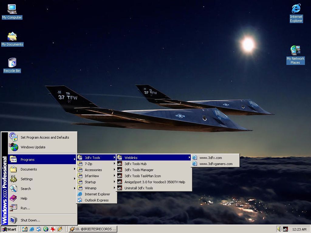

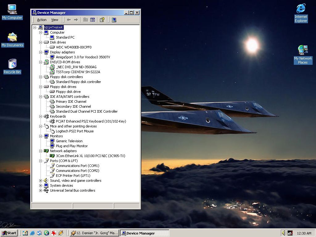

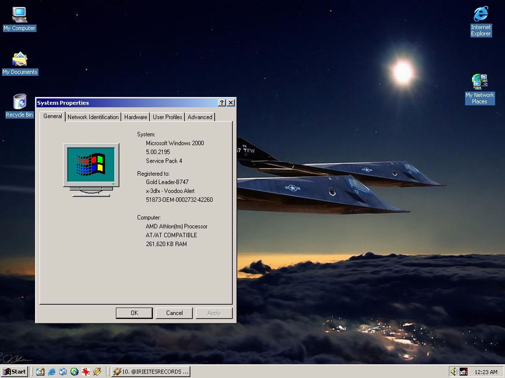

So here the system as it is now, it's progress for the least right, but it has seen happier times.
Here the start menu, the CPU & ram identification and all installed parts neatly addressed:
So yea it could of been worse, what I am going to do next is to get the PSU recapped and that M1-A to VGA Dongle cable should also do miracles for the V3 3500 TV AGP, getting the V3 3500 recapped is also very much on my mind.

As 3dfx goes yea I now run the official x-3dfx community at Facebook, normally I am no fan of FB , but considering it doesn't matter what people use every company every software is spying on personal data I am just truing to ignore than and just be where I can be.
Keeping the 3dfx dream alive is it all for me and building date correct computers that were there when these cards came out justifies it all, it's not just the 3dfx cards it everything that goes with them, it all needs to be there AMD 7 Athlons Intel Pentium3's , AMD AthlonXP's and Intel Pentium4's I wanna be all part of it, I also have a Dual OpteronMP 850 CG build with a Micro Star International MS9130 K8T MAster2-FAR mainboard with it's glorious deep red PCB, also something you don't see anymore these days, colored PCBs in that sense:

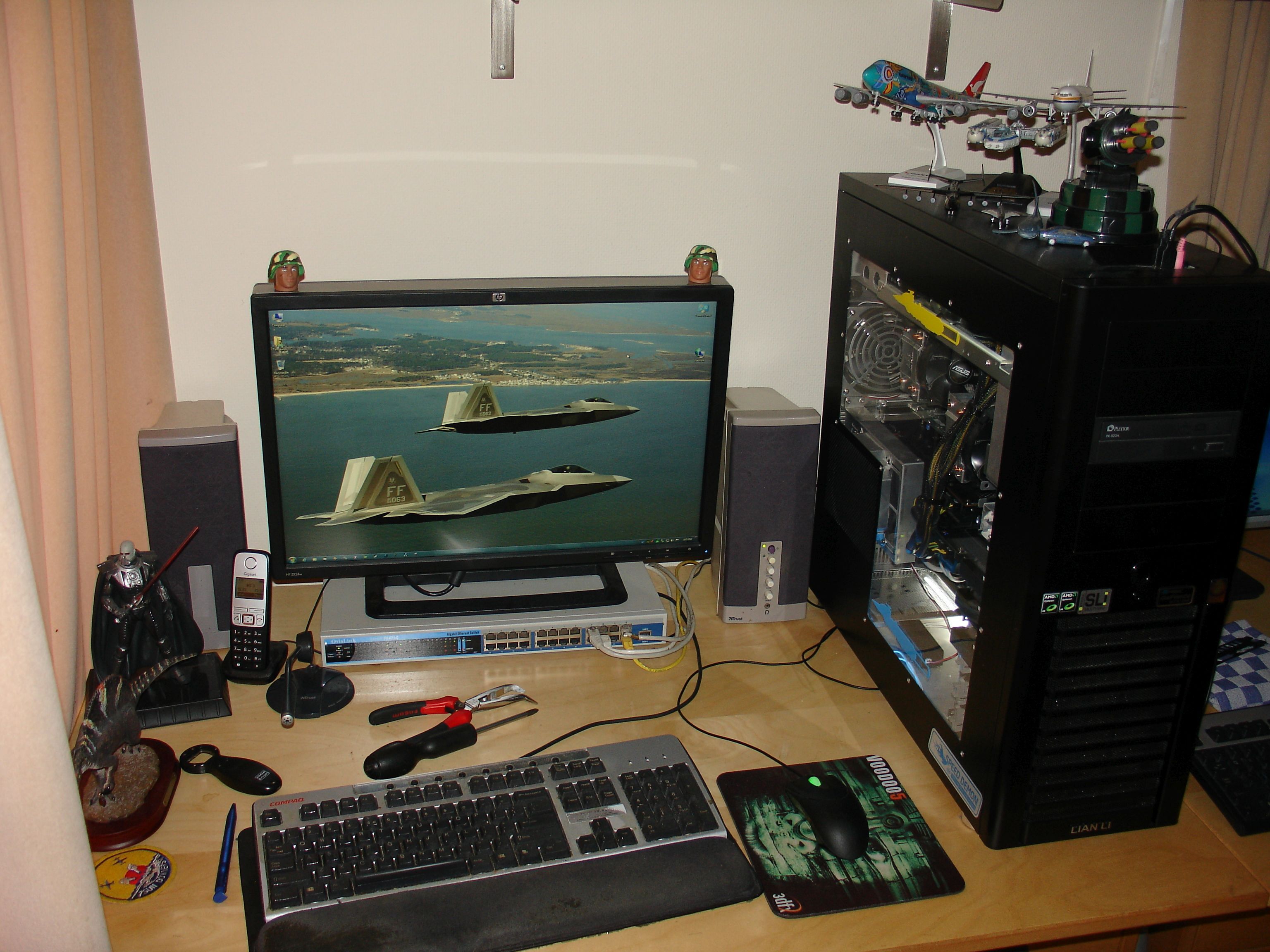

This system is from 2004 and that is as late I will call retro really.

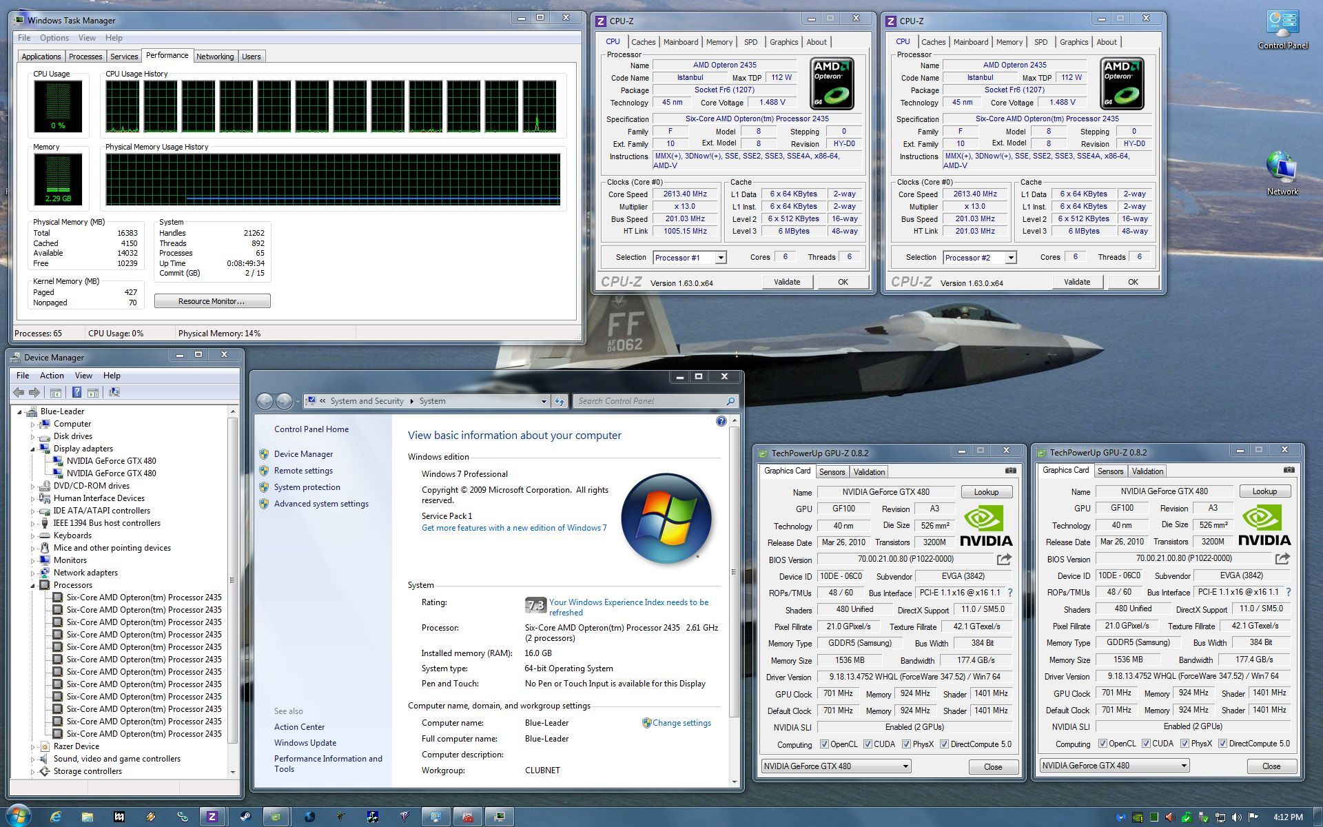

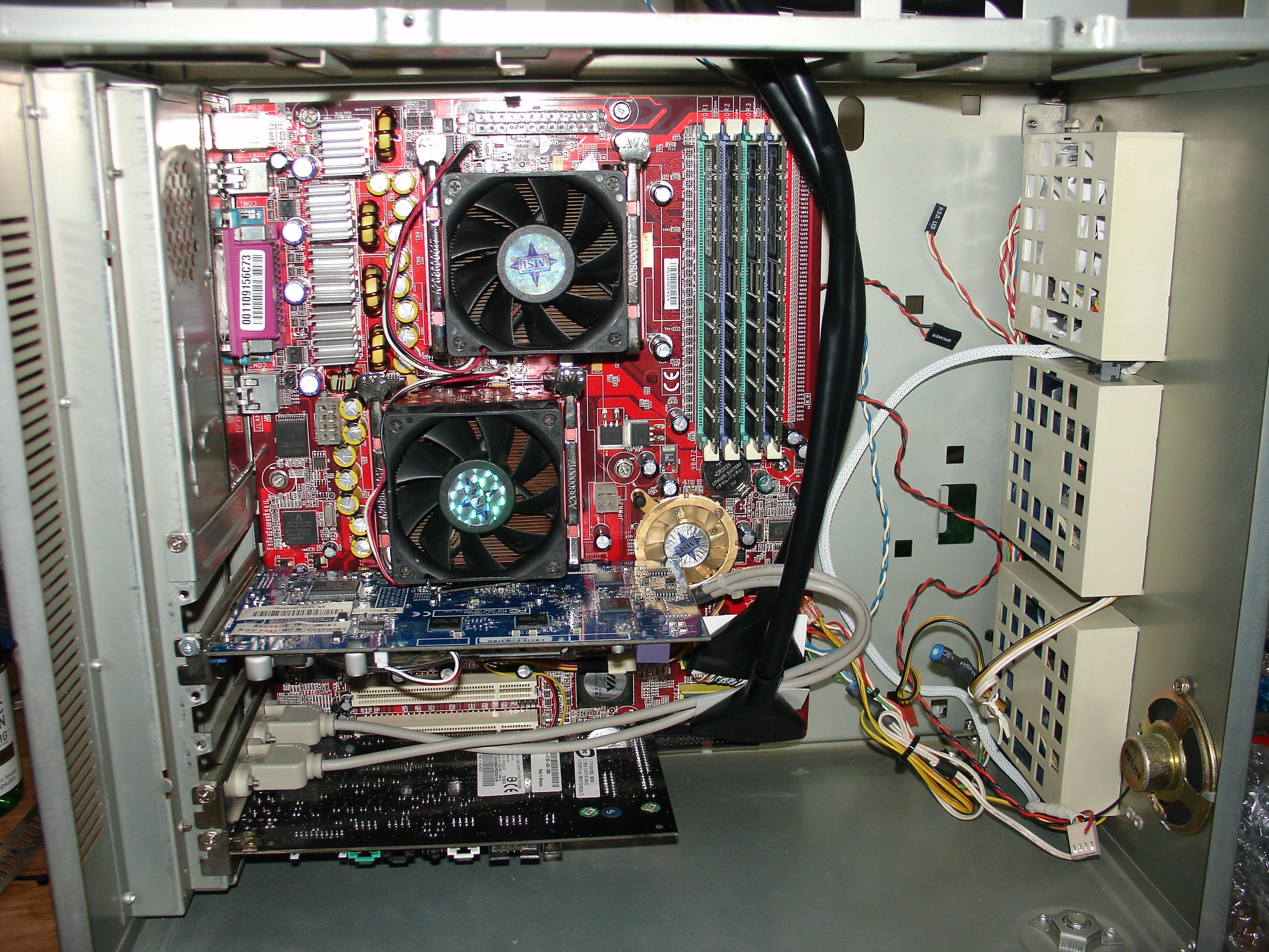

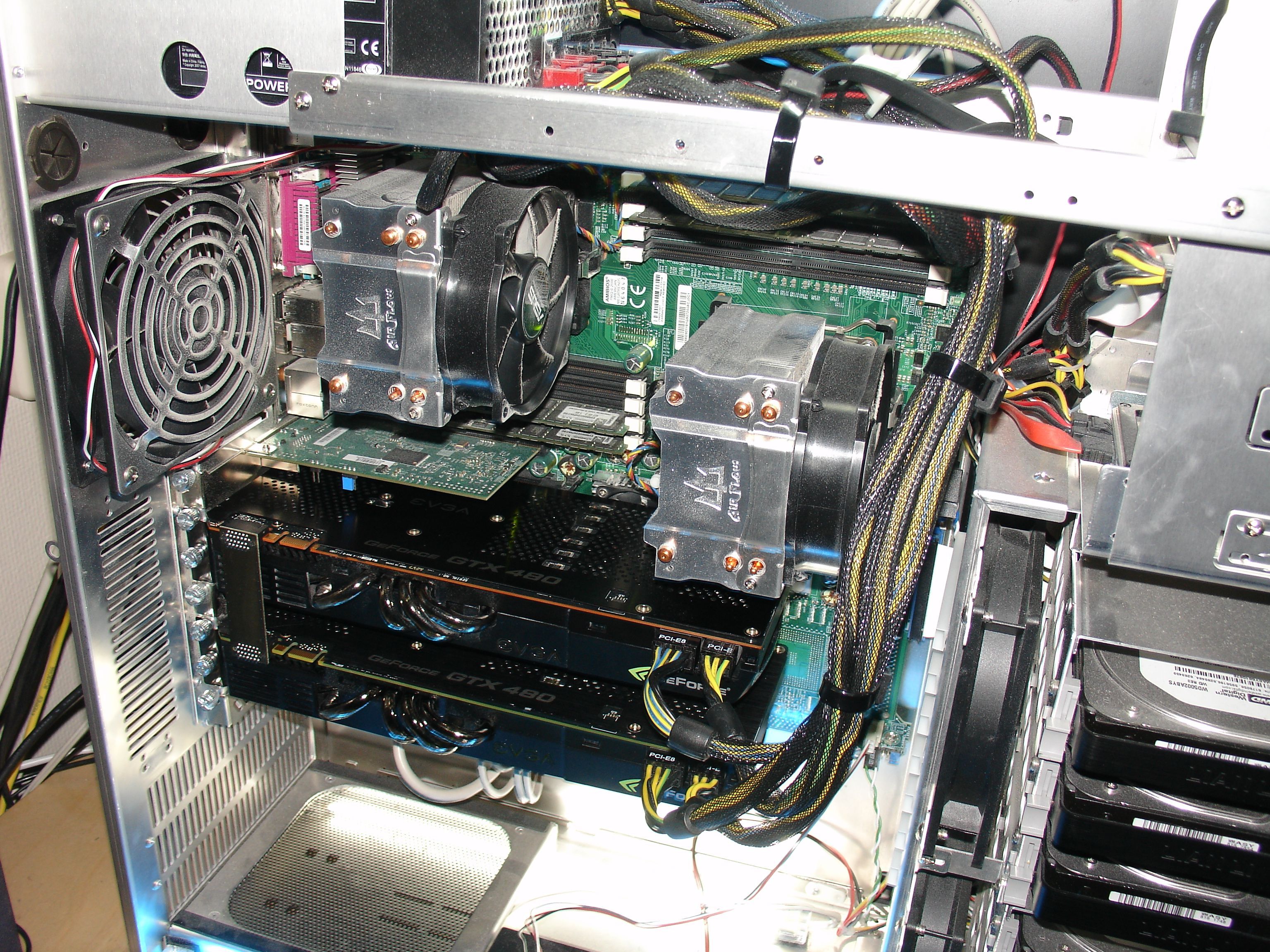

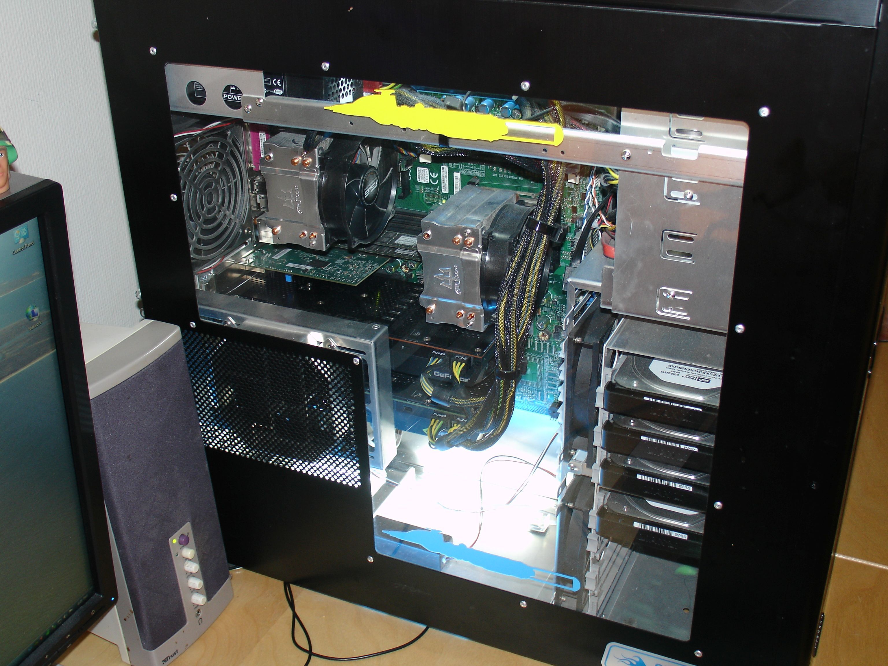

My mid aged project is a Dual Six-Core OpteronDP 2435 with a pair of EVGA GTX 480's in SLI this system needs a new Power supply a good one like a Super Flower or a SeaSonic Platinum rated 1000 to 1250 Watt Digital PSU.
Here four pics on how this system will be to what I am working on , the 2nd EVGA GTX 480 should arrive on October 08 next week.
The NVIDIA GeForce GTX 480 PCI-E 1536MB 384Bit GDDR5 is my favorite GeForce of all time, so it deserve a place here, the Fermi Architecture was fascinating those cards in SLI with Flight Simulator X I did a ton of Boeing 747-400 flights in real time and it didn't lag at all.

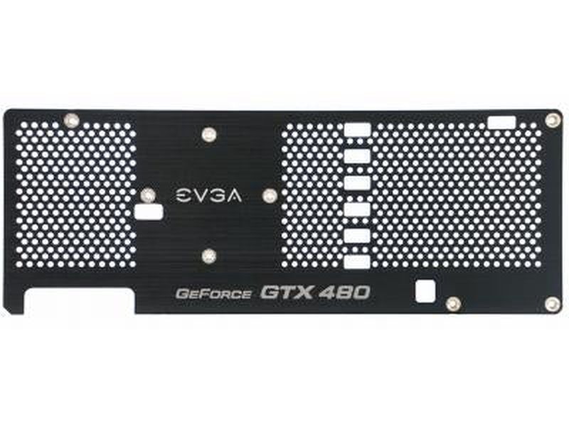

But I do seek an EVGA GTX 480 Backplate btw, if anyone has one feel free to DM me about it 😀
aka one of these:
Even the system had a pair of EVGA GTX 295 Red Editions before these, the 480's added 640MB More VRAM per chip and the new GDDR5 year that was a wild time.
The problem now is that the onboard NF200 chip died, so finding a Supermicro H8DAE-2 or H8DA8-2 is my plan to progress, not easy sadly, there are a few on ebay but the prices aren't fun 🤣, like all of us retro people all know the ebay problem, so for now this system is just dormant for now, just gonna get the parts I can get to make it usable, but for SLI I'd need anew board or a new NF200 chip and yea for such a repair, you may as well replace the entire board.
Cutting corners was never my thing the Audigy 2 ZS boards will get Nichicon Gold MUSE capacitors, that is something I really want my friend Backfire to do, so they too will improve when it comes to sound quality, they get rid of signal noise and sound distortion, they literally filter out the sound and make it sound much cleaner and that with a nice pair of Edifier RT1280 speakers and I'm all set.
Anyways regarding the memory issue with the K7 build, I Cleaned the gold connectors of the 3x 256MB Legend/Hynix SDRAM with a clean cloth and alcohol and presto! 😁 I now have 768MB again, I looked back and thought well it could just be dirt and grime blocking the system for reading out the system ram and yea this was certainly it:
Here the system it's self:

I remember the Blue Orb was really popular Im not sure if it was that one or another that had 2 fans
https://www.youtube.com/@ComputerRetroBus Computer Retro Bus - My Youtube Chanel
Reply 13 of 61, by H3nrik V!
RetroBus wrote on 2025-10-07, 06:10:
Awesome! thankyou for the link!
Seems like it was the "Dragon Orb"
Reply 14 of 61, by Gold Leader-B747
H3nrik V! wrote on 2025-10-07, 06:23:
Hey no worries man, happy to help.
Yea the Dragon Orb has two fan parts, a blue part of the cooler was the because an the top orange half was replaceable if memory serves me well.

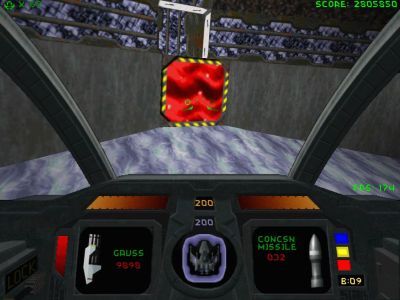

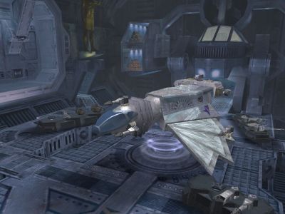

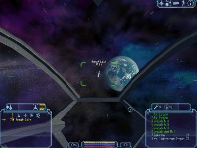

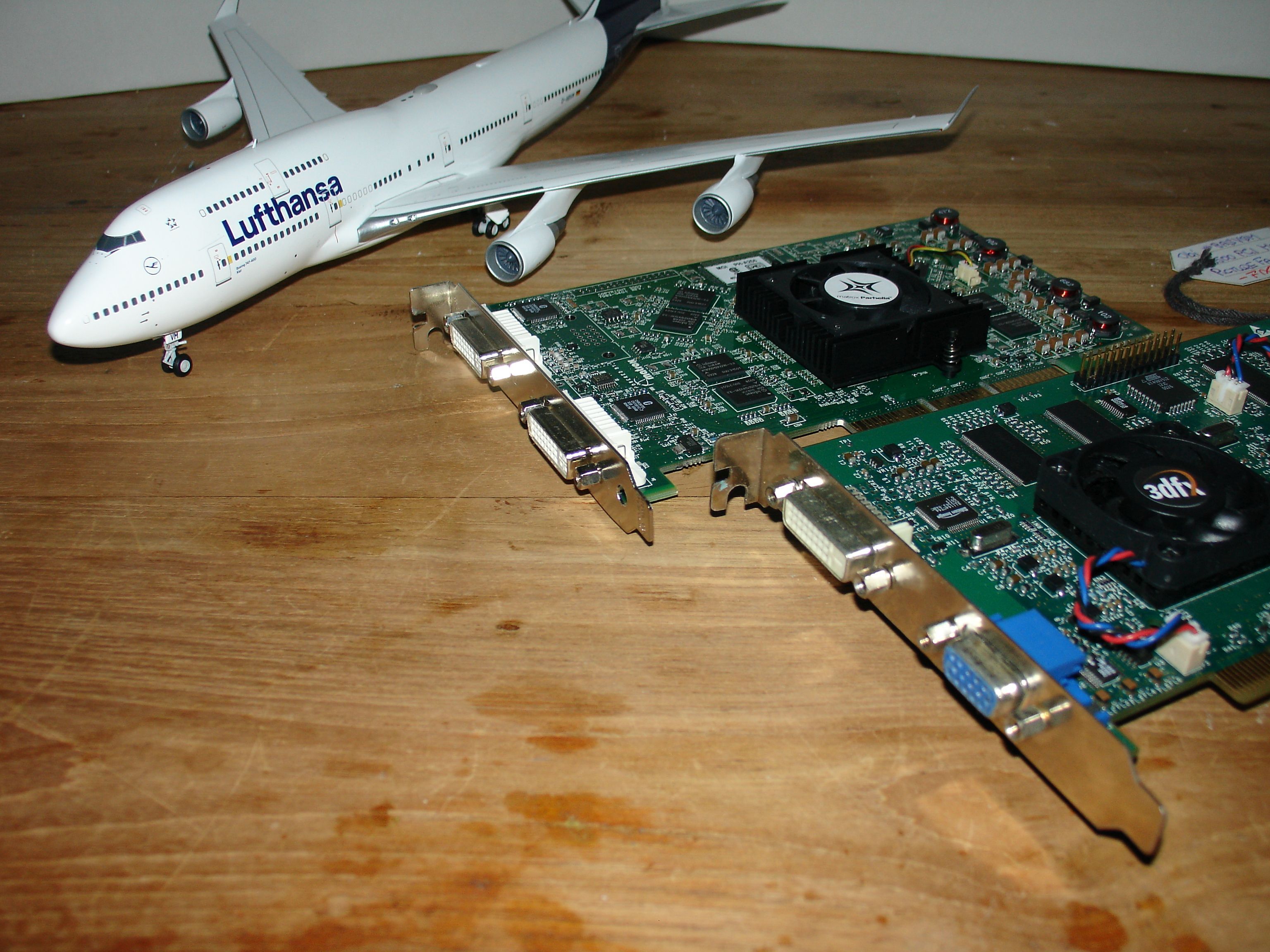

Alas I have worked with all VSA-100 based graphics cards single Dual & Quad SLI setups.
The people from EVGA seen me post my Voodoo5 6000 a few times, this system is kind of a memory to my Voodoo5 days, the PC flashed Voodoo5 5500 PCI Macintosh is the only Voodoo5 I currently have.

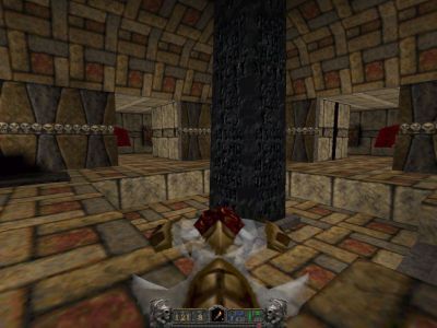

And this is the end pf Part 02, Part 03 is about sound cards LS-120 drives and the cassette tape convertor drive.
