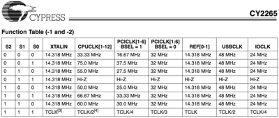

lazibayer wrote on 2018-02-19, 03:44:
PcChips M558
CY2265PVC-1
The attachment cy2265.83mhz.png is no longer available
Why is 83MHz listed as a possible clock but then there's no way to actually use it? Or is it?
Full datasheet here.
Great thread by the way! 👏
This clock generator can also be found on the M550.

Maybe 011 or 111?

I just tried all jumper combinations
011 = no boot.
111 = 7.14 MHz CPUCLK! System boots (after a long while), but it's too darn slow. The keyboard doesn't work.
000 = works, as the datasheet states, 33MHz CPUCLK. Useful to make it crawl for older software.
With little tweaking P55C @66MHz L1D L2D
NSSI 5281, Sysinfo 10.3, Speedsys 6.60
So I wonder what they were thinking when they wrote "up to 83.33MHz" when the true max clock is 75MHz.
